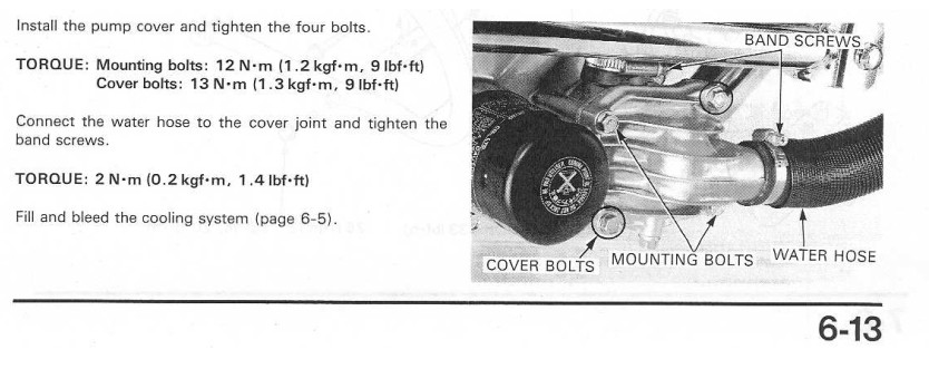

Hi Valk riders
I have a 2001 Interstate with a deteriorating intermittent coolant leak
After reading other posts on this issue and monitoring the leak for the past week I have concluded it is at the pump and not coming from any of the hoses or clamps. I can see coolant coming out from the casing where the pump is attached
Replacing the pump looks fairly straight forward, simply draining the oil and water and re and re the pump.
I would welcome any “be sure to … make sure you don’t …” suggestions.
Also does any one know the specific torque values of the pump mounting bolts if any?
Thanks

I agree it’s more likely that it’s the top hose to the thermostat. Easy fix just unbolt the top of the radiator and tip it forward. If it is the pump. Go for a short ride so the engine is warm before you try to break those bolts loose. Tap on them with the socket and extension first. Once broken loose then drain the oil
