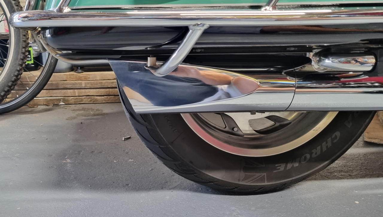

Posts: 16817
« Reply #4 on: August 29, 2022, 04:30:37 AM »
Interstate tips are shorter than Tourer/STD tips. The piggies are different, though.
I had Interstate pipes on my Tourer for a while, your idea about longer tips (and longer piggies)
is correct, they are a little quieter.
I have OEM "triple tips" on there now. I modified the piggies on them to come all the way
to the end. If you can find tubes with the right inner diameter that matches the outer
diameter of the piggies, the rest is easy...
As I'm typing this I'm remembering how piggies for Interstate pipes are
"twisted"... for my mod, straight (easy) piggie extensions were needed.
Anywho... Interstate tips are easy to find...

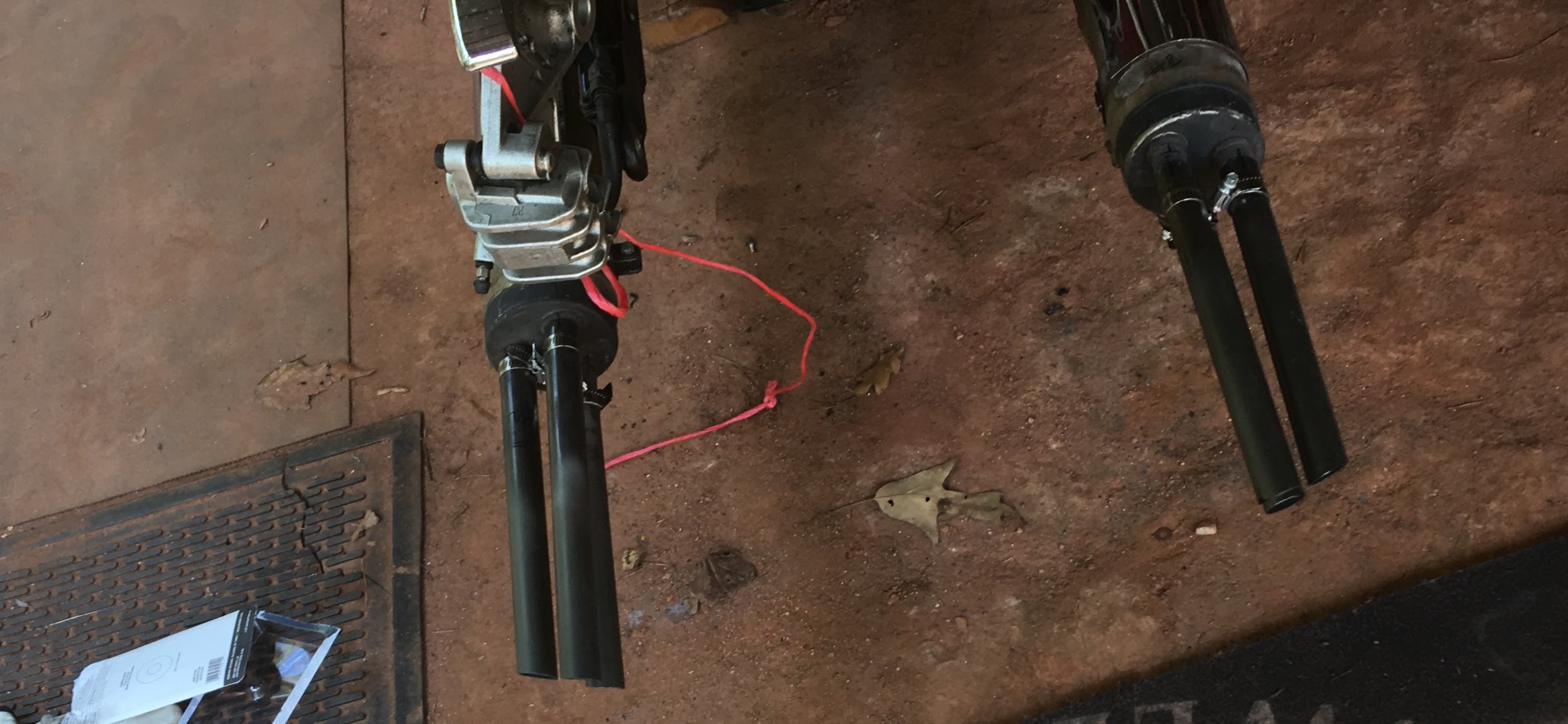

The easily available longer tip (an Interstate tip) would get in a fight with Tourer piggies...
I know of a couple of people who have extended their piggies beyond the ends of their
Tourer tips, and they like the look. It just occurred to me that the Big Bike Things guy
has chrome piggy extenders that would probably fix the soot-on-the-saddlebags problem...
https://www.bigbikethings.com/Honda_Valkyrie_Exhaust_Tips/p4325477_16676973.aspx
-Mike "is what I'm sayin'  cooldude "
« Last Edit: August 29, 2022, 06:03:04 AM by hubcapsc » Logged

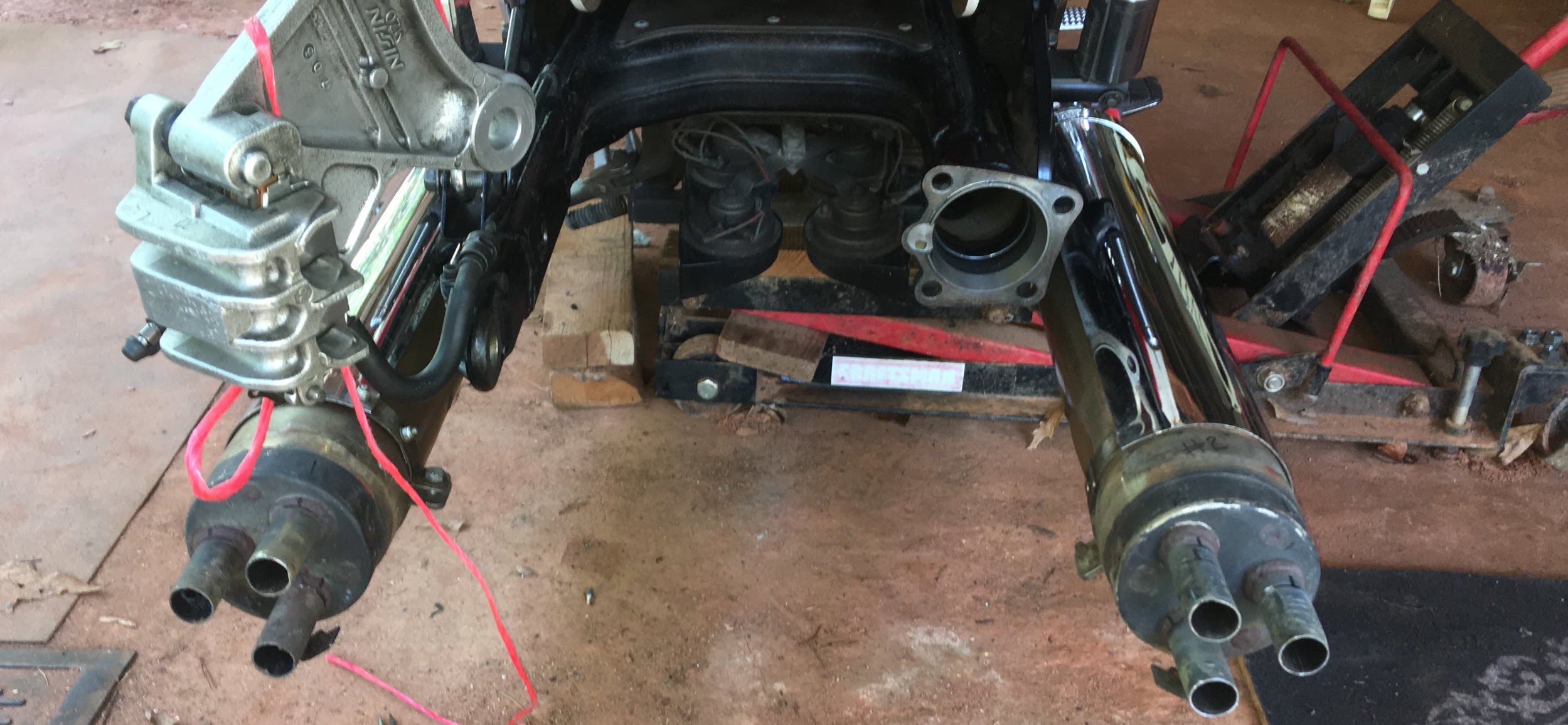

Have just double checked and taken a pic.
The top of the End Cap is around 4" from the back of the pannier and around 5 and 1/2" from the chrome "cage".
I've got a feeling that those shiny piggy extenders would still be chucking a bit of soot on said panniers.
Now I don't have sooty plugs and I don’t mind oeriodically giving the panniers a wipe.
If anyone knows of longer End Caps without me changing the whole exhaust then please "post" the options.
I may still go down the route of your suggestion,  Mike. Thanks again.
« Last Edit: August 29, 2022, 06:25:34 AM by Knapdog » Logged

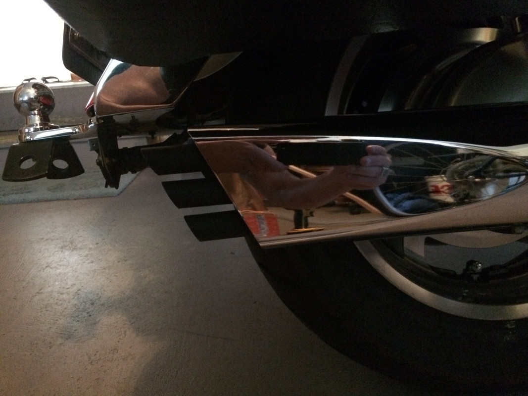

« Reply #9 on: August 31, 2022, 07:18:47 PM »
Be advised Spacer 4 should not have a gap at the top (vrs. bottom pic). You may need to bend the appendage up, don't know.

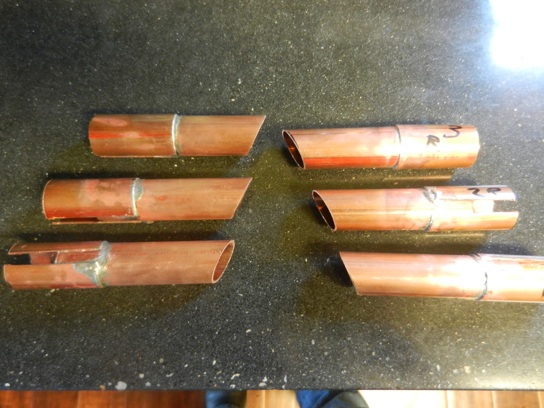

Posts: 14918
« Reply #13 on: September 09, 2022, 07:11:54 PM »
I did the same thing with copper pipe from Lowe’s. Total cost was under $20
