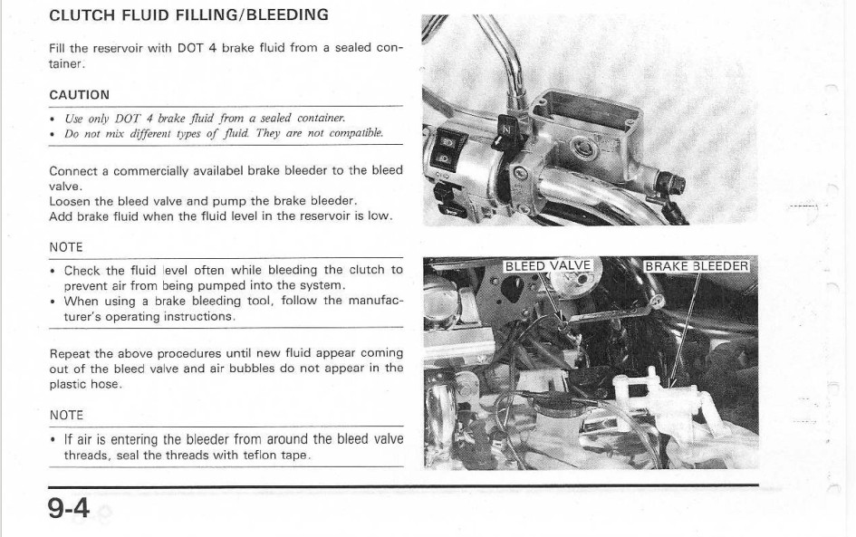

Laure,
Thanks for the info. One last question. Where is the bleeder valve located?
Thanks,
Dan

Quote from: MelbourneDan on August 31, 2022, 07:23:59 AM
Laure,
Thanks,
Dan
It is on a tube/hose on the back of the motor near starter and alt. If I remember correctly, access from the left side (lay on ground).
