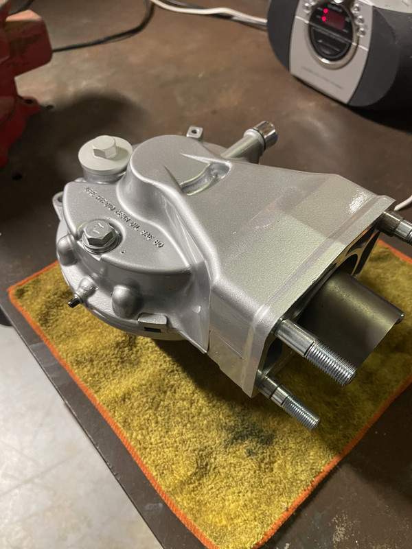

No, not for my Valkyrie sadly. But I did order a modified final drive for my Wing today. The housing gets custom machined for a new set of gears, assembled and sent ready to bolt on. The advantage? First, first gear on the Wing is too low for most situations and paired with the throttle control make for a very jerky engagement. Maybe two up loaded and pulling a trailer? I don’t know and won’t ever be in that situation, but a lot of Wing owners start out in second gear by personal preference. Personally , especially on a cold start take off the bike is much harder to control smoothly. Next and as important for me is reducing engine speed at highway speeds, reports are 70mph comes in at 2600 rpm. Reports are that mileage improves some but that is secondary to improved drivability. Really looking forward to getting this installed, (45-60 day wait currently) but will probably wind up being a winter project, lookout Spring!

Nope, all inclusive. Custom machine work to the case, new gear set, all Honda factory replacement parts, bearings ect, assembled and shipped ready to swap out. I know still a little crazy, but so are Cobra light bars ect.

The Valk 1800 final drive is the same as long as you get the one with the correct driveshaft. I bought an extra rear for mine off a trike conversion.

Just ordered on the ninth, placed deposit, although I had contacted him last winter/ springtime when he was out of parts and had not heard from him since. Friend on the Goldwing forums gave me a core and I paid to ship it to Henry and it arrived yesterday.
Henry texted me today that the final drive was a good one and he has mine ready to ship! It’s leaving his place tomorrow. The stars must have aligned somehow, that never happens for me, I was expecting at least a 60 day wait!
Posts: 9493
« Reply #26 on: October 20, 2022, 09:17:17 AM »
Well, it got here yesterday. May be a little while before I tear into it. Been busy with a bathroom remodel for my son and been a little under the weather this week. Anyway here’s what a custom machined and regeared final drive looks like. I know, kind of anticlimactic for $1500 bucks.
Fun stuff is on the inside!
