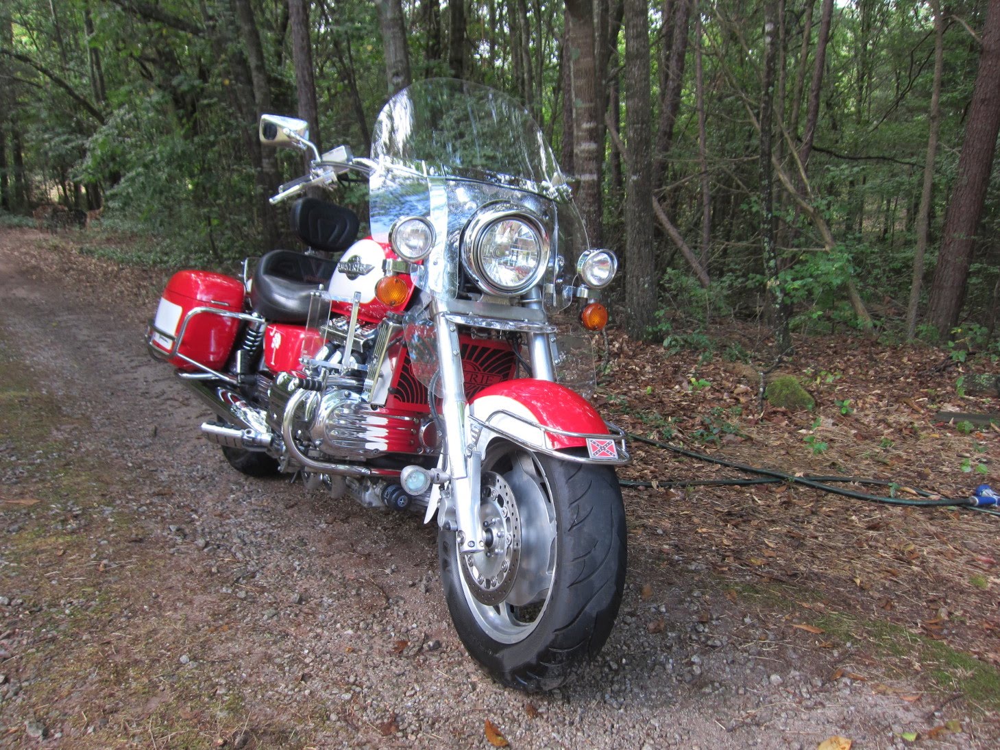

Here's how mine fits...

« Reply #6 on: October 26, 2022, 07:48:21 PM »
OEM windshield
Clearview ( with the plastic still on per their instructions )
« Last Edit: October 27, 2022, 05:41:11 PM by yelovalk » Logged

« Reply #7 on: October 26, 2022, 07:59:04 PM »
If you haven't already thrown out the old one, perhaps you could
tell something if you held them together, see if the Clearview is
misshapen some how...
With the OEM overtop of the Clearview (because of the vent) it is slightly shorter but comparable in all aspects except the headlight opening
« Last Edit: October 27, 2022, 05:24:36 PM by yelovalk » Logged

« Reply #8 on: October 26, 2022, 08:38:31 PM »
It may be the photo isn't straight on, but the LED headlamp doesn't appear centered between the fork tubes, as the stock one does. Don't know how to do that without examining mine closely. It appears, also, that the opening to brackets is the same on each side.
I think it is the angle of the photos. I figured out how to attach them. Housing hasn't moved since mother Honda put her there and fit within the OE opening

I think you’re right about not having much adjustment in any of the mountings for the shield or the headlight bucket. However, there is a little wiggle room. Loosen up everything including the chrome strips and shift everything to the left as far as it can and the bucket to the right as far as it can go and I think you will have a livable situation.
Thanks, I will try it again. The picture above is "after" shifting the hardware as much as the shield holes would allow. It fit worse when I originally bolted it up. I am hesitant to start "bending things to fit" if it is the shield. It all fit fine for the past 22 years
