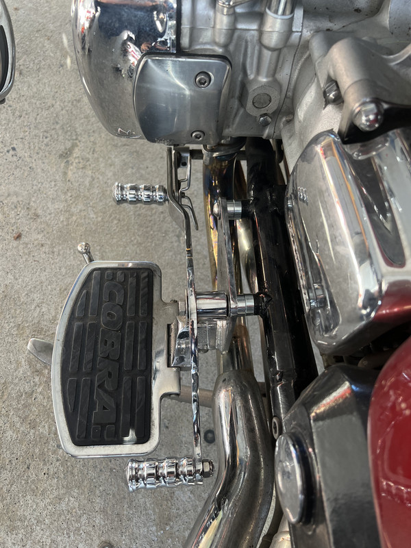

So far i have gotten one of the guys from work to make me a SS approximation of the foot peg relocation bracket
I am using the upper set back hole for the pivot point
Later i may make a direct linkage to the primary shift arm,  though this may sit in the skunk works a while .,.,..,
Anyway hoping to mount up this weekend !!

Grey wolf oz
Posts: 163
« Reply #15 on: February 01, 2023, 03:29:55 AM »
Nice
There are a bunch of after market shifter linkages out there
I was figuring on getting a preloved shift crank to use with an after market linkage and fabricate a bell crank for the heal toe
It’s gonna take a little time and messing about but pretty much what i want out of this I think
However the current heal toe arm i have has a large slot to stuff over the shifter, so i need to make a new arm or pretty it up,,  not quite there yet

MK 1.

« Reply #21 on: February 14, 2023, 03:01:05 AM »
It is finished,
As with X-Ring i decided to space things out,
Added 14mm of spacers behind the floor board bracket and break side also
Shifts positively
Rides nicely
