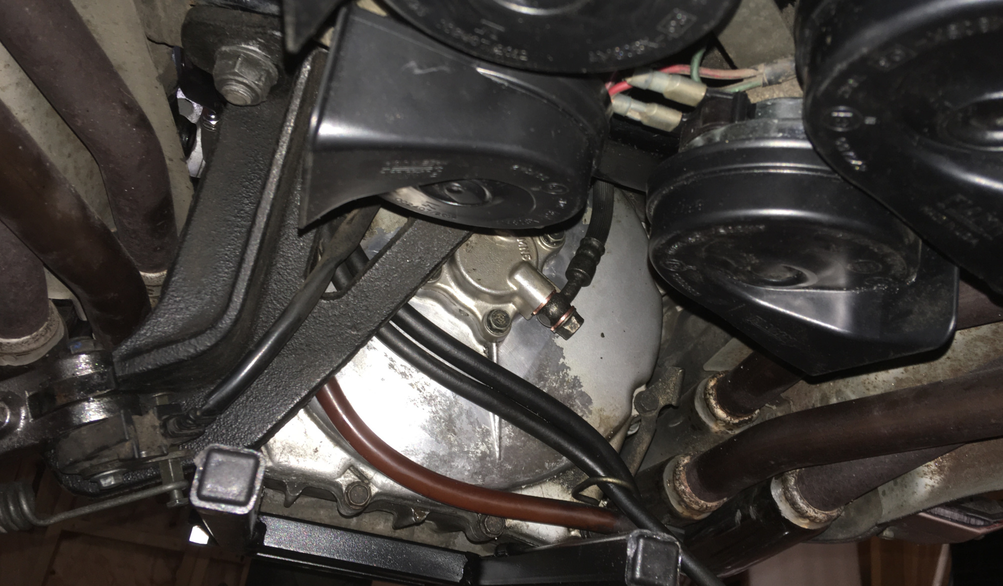

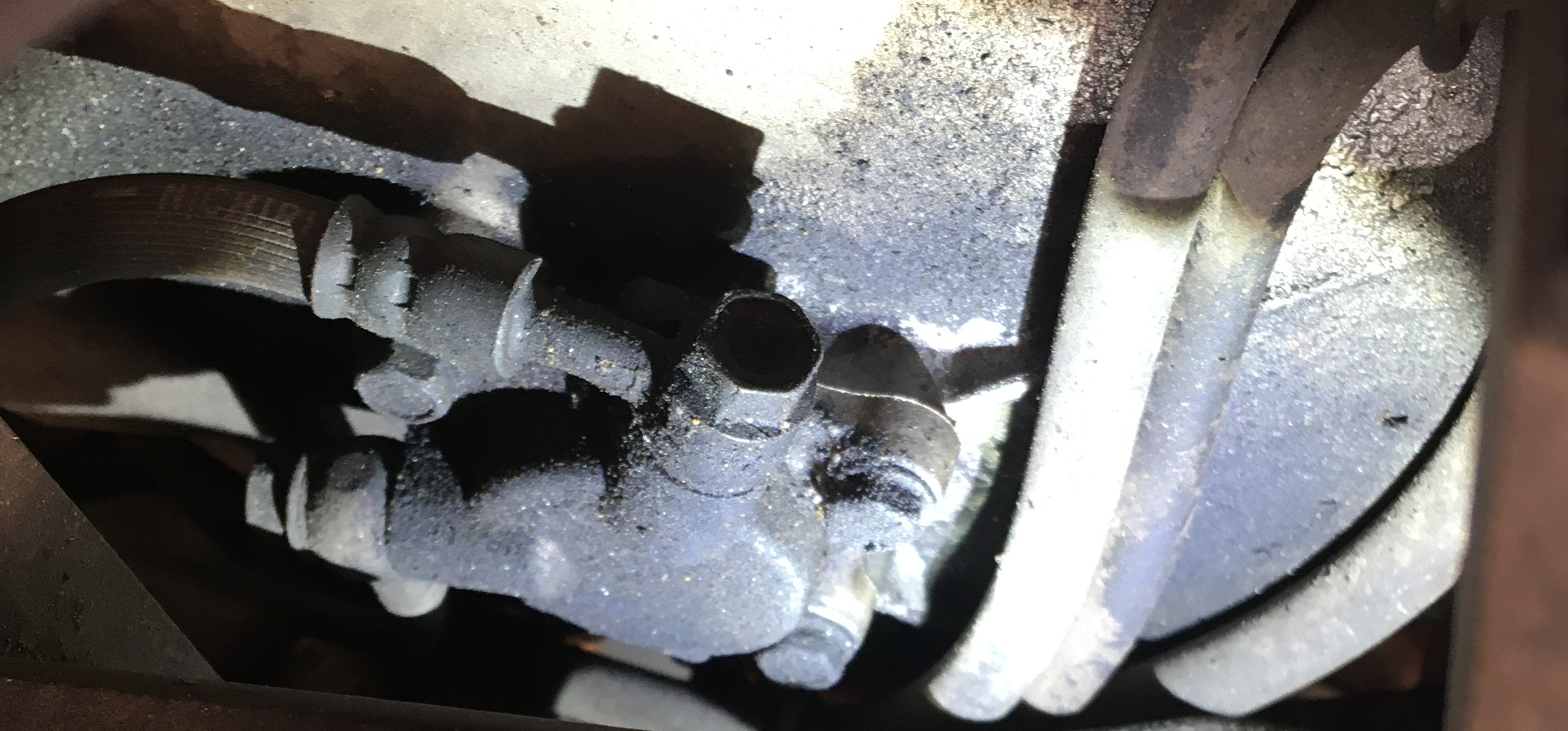

Here's a good shot of the underside.  As of when I quit for the day, the slave cylinder and the bolts holding the kickstand to the frame were loose.  Hopefully tomorrow I'll get things situated to allow me to get the cylinder out.

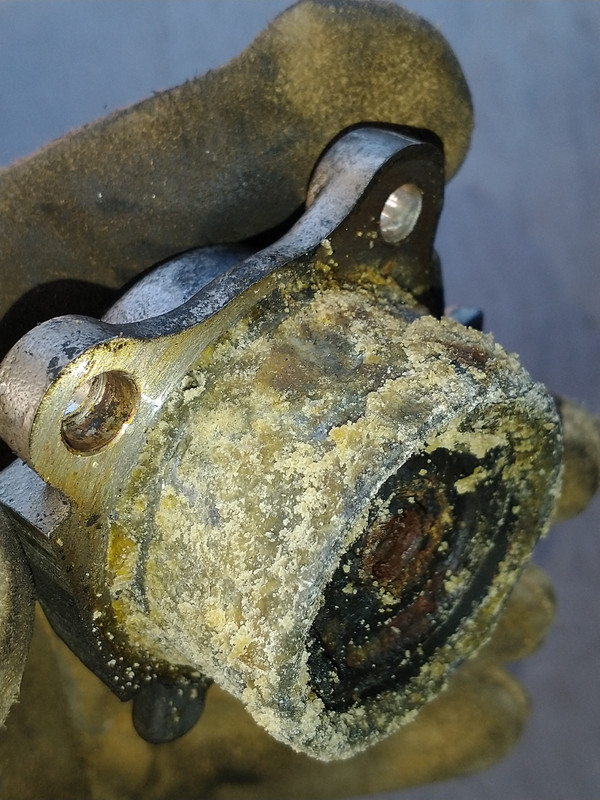

Today I got the master apart and the slave removed.  Here's what I found.

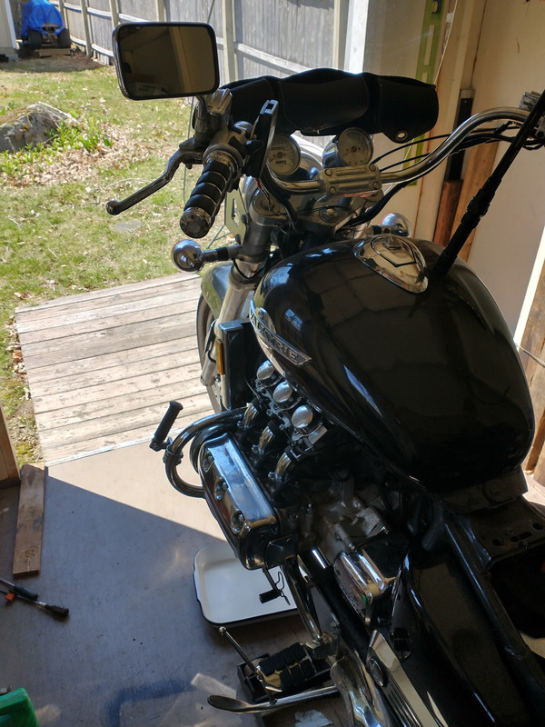

Just so you don't think I'm being lazy and not doing much, here's the other bike I'm working on.  It needed a new pushrod tube o-ring at the top of the rear cylinder intake pushrod.
I've enjoyed swearing at both bikes for the last few days.
« Reply #20 on: April 10, 2023, 10:00:25 PM »
I ordered  a pushrod seal for the clutch cover not knowing if I can replace it with the clutch cover in place, can anyone answer that question?
You have to remove the cover. But, it’s not that bad. I had a new gasket, but could have got away without a new one.
That’s the most corroded slave cylinder I’ve ever seen.  Shocked Makes me feel better about how dirty mine was.
