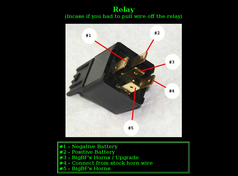

This has worked flawlessly ever since I installed it, but now I just hear the relay underneath click. Have crawled under the trike to look for issues, none seen, fuse is good, but there were a few loose wires under the right side cover that were questionable. Have tried connecting them but so far, no good. Any suggestions on what I can try to find the problems? Have a continuity tester and a bunch of jumpers with alligator clips... TIA for your thoughts!  smitten

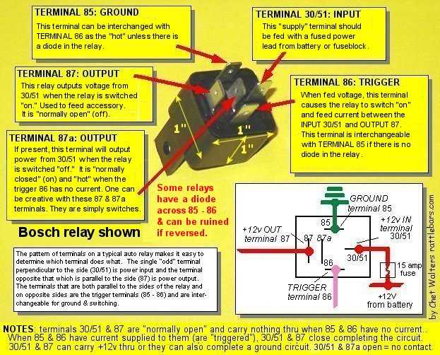

He did something clever that I don't understand with his wiring...
I rewired all my accessories about ten years after I first installed
the quad horns using BigBF's instructions. When I did the rewire,
I just used the rattlebars relay diagram as a guide and didn't
touch the 87a blade on the relay.
