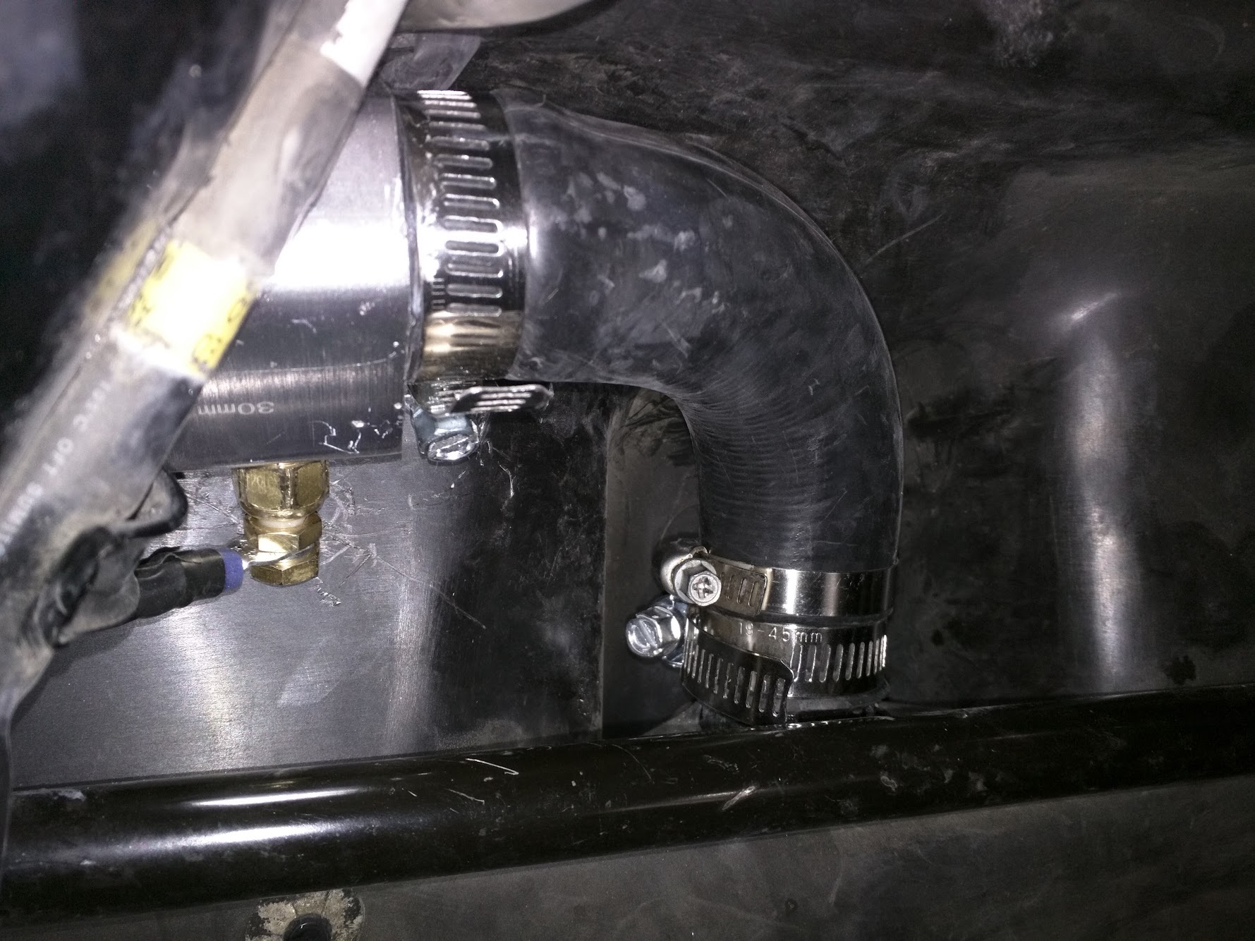

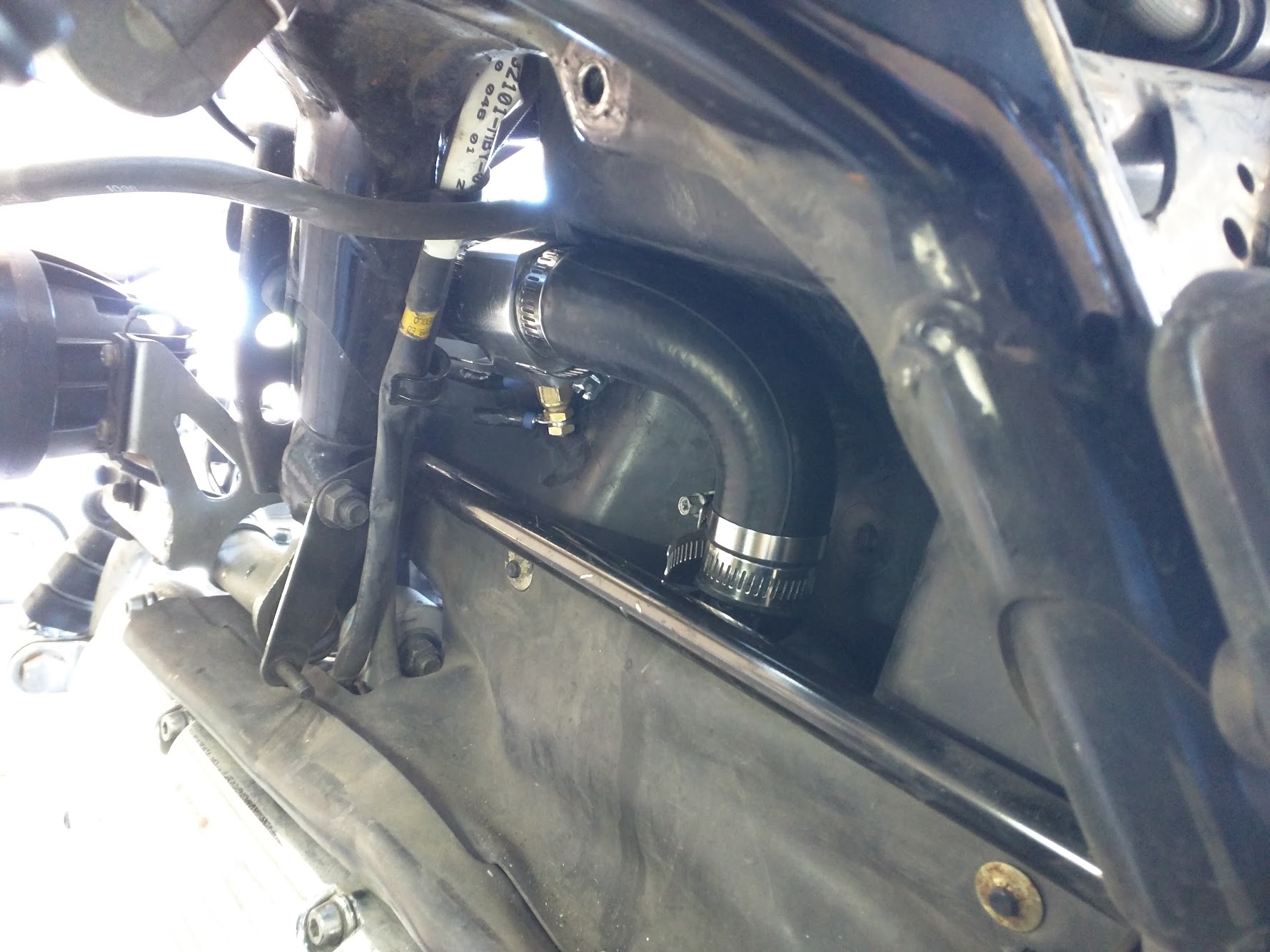

It may be a good time to go ahead and install a coolant temperature gauge.
I've installed one in my I/S in 2016 and documented the process here:
http://www.valkyrieforum.com/bbs/index.php/topic,90490.0.html
I decided to go double clamp (original + extra), where the new clamp is stainless steel and wider.
