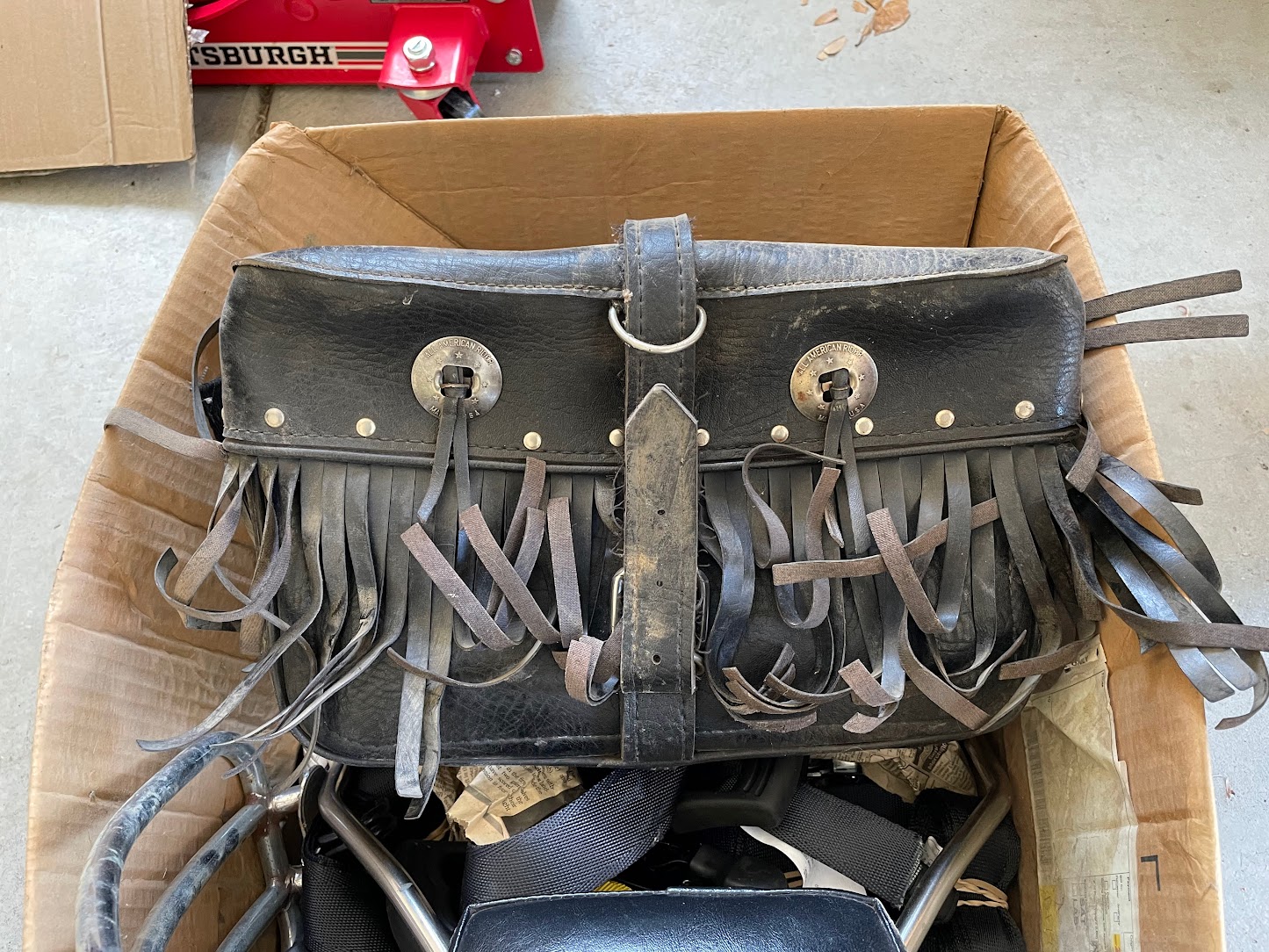

Concerning the leathery (i.e. tank bag, sissy pad, seats, bag guard bibs, etc) situation of the bike, I must confess that I personally don't like the studs + leather combo as it gives some 'leather bar' vibes.
Specially in the SF Bay Area, people may honestly mistake what you are into, if you know what I mean?
 Grin
But right now my priority is to get the bike in a rideable & reliable state before I consider changing its current looks.

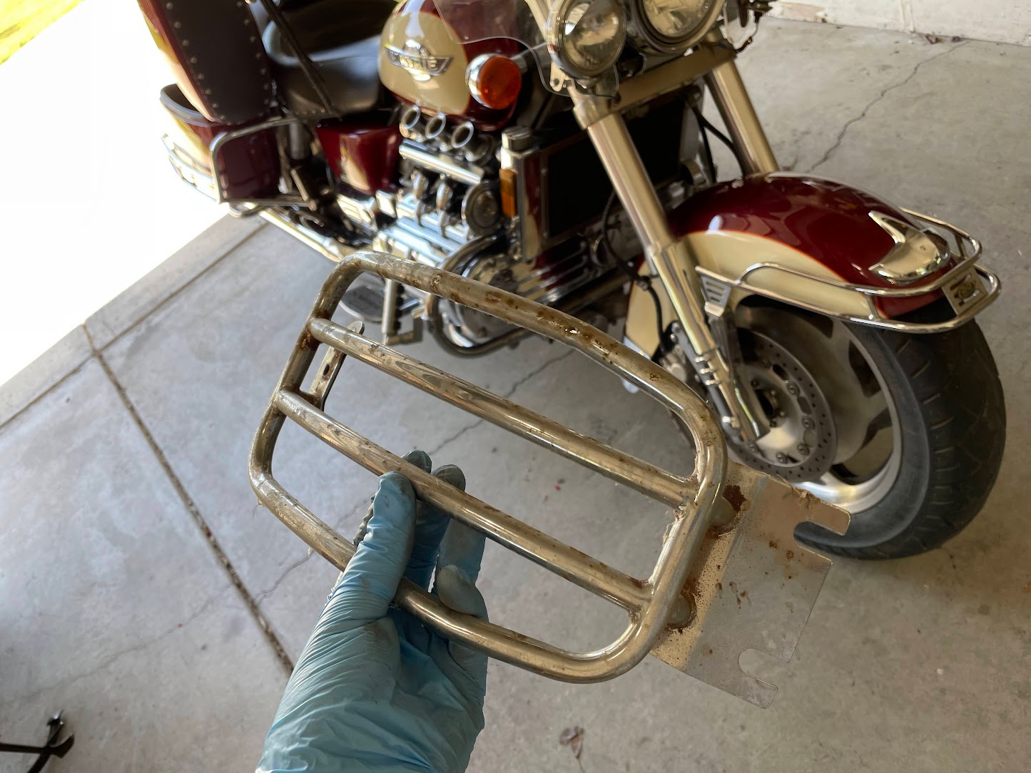

It came with a rail that can be installed if I decide to make it single seat and remove the sissy bar, but it is a bit rusty and I'm wondering if it can be recovered.
Posts: 16859
« Reply #44 on: June 13, 2023, 10:43:05 AM »
I have no doubt the luggage rack can be cleaned up and re-chromed.   Won't be cheap but, it can be done.

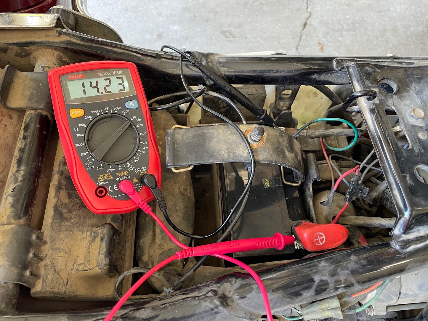

I warmed the bike and did a 1/2 mile route in the court and returned to my garage to verify if the alternator is still putting out power (I was once stranded in the middle of the mountains in the winter when my I/S alternator died).
It was reading over 14 volts, just like it is intended:
Posts: 16817
« Reply #46 on: June 13, 2023, 10:46:11 AM »
The rack is high-grade unobtainium. They used to be $35 or so. Now they
are worth several hundred (with good chrome)... If you don't want to chrome
it, you could sell it to me cheap  cooldude

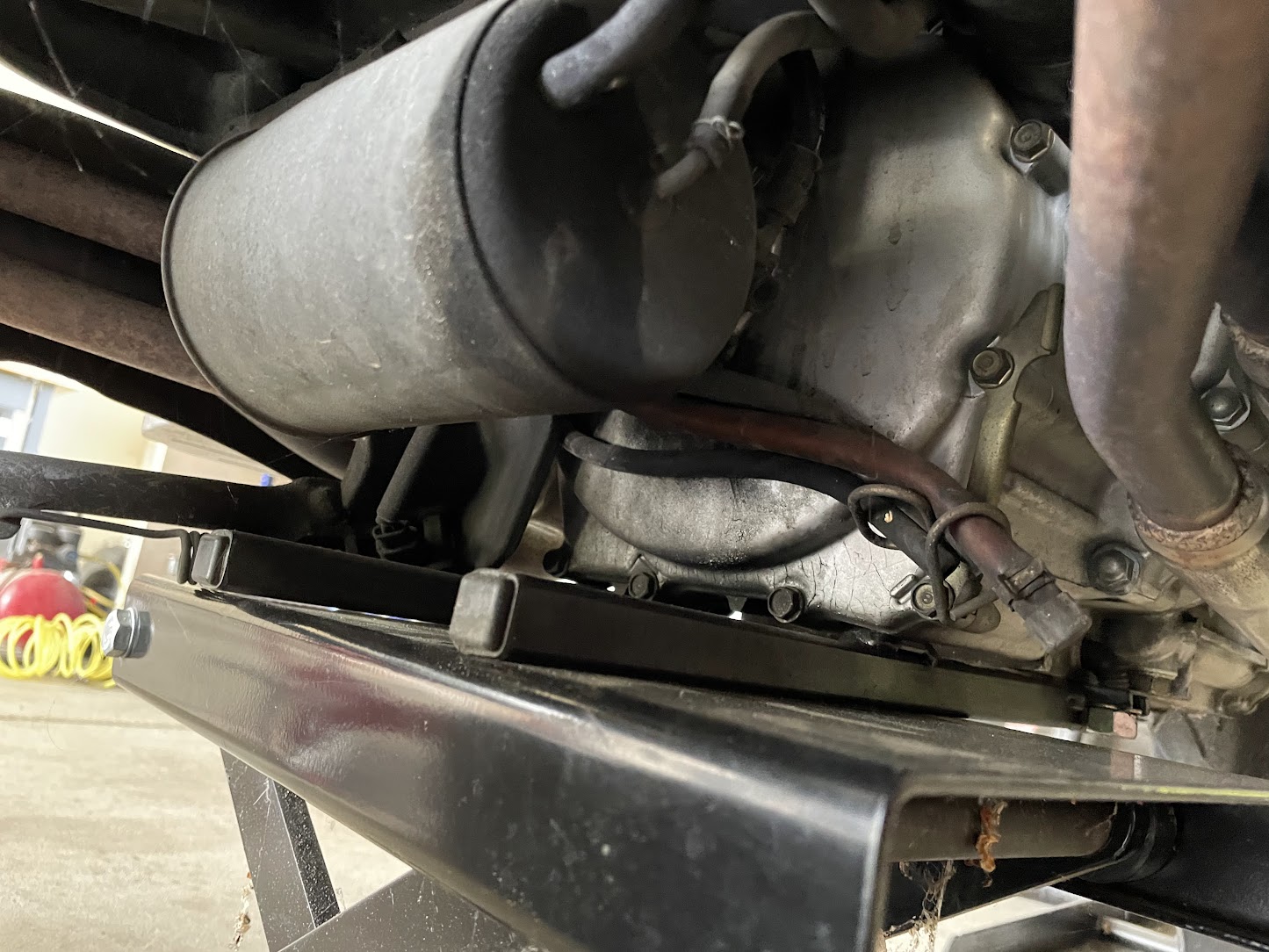

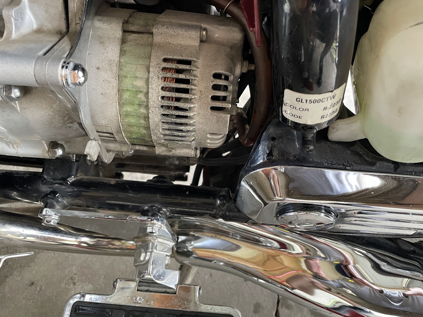

« Reply #48 on: June 13, 2023, 10:49:32 AM »
I went to investigate and this is what I found:
Savago
Posts: 1994
Brentwood - CA
« Reply #49 on: June 13, 2023, 10:51:32 AM »
Apparently one of the hoses were routed in the wrong direction and was touching the exhaust pipes.
It is possible to see the tip got melted/burned as a result:
« Last Edit: June 13, 2023, 11:24:56 AM by Savago » Logged

That "looks" like an OEM alternator. I never heard of that happening.
I wonder what labels will be on it when you get it off... Hitachi is the
OEM brand I think...

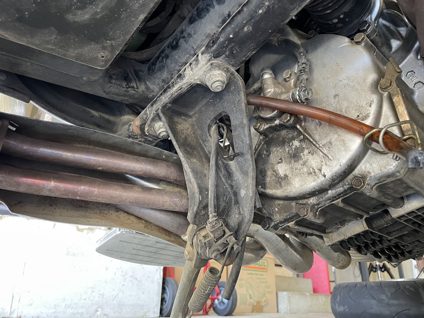

So I went to my I/S and looked under it to check where this hose was supposed to be placed (notice the Mark T jack adapter in its full glory keeping the I/S in place while it waits for the missing parts!):
« Last Edit: June 13, 2023, 11:33:00 AM by Savago » Logged
Savago
Posts: 1994
Brentwood - CA
« Reply #52 on: June 13, 2023, 11:03:52 AM »
And this is where I repositioned the burned hose in the Tourer:
« Last Edit: June 13, 2023, 11:16:03 AM by Savago » Logged

I noticed though that the I/S has what looks like a cylindric canister under its belly, while the tourer doesn't have it.
I wonder if that means the Tourer is not a Cali bike or if it has to do with a potential desmog mod?
 Huh?

Anyway, after re-routing the hose to hopefully its correct place, I let the bike run and the smoke stopped.
Success! Maybe? I'm unsure really...

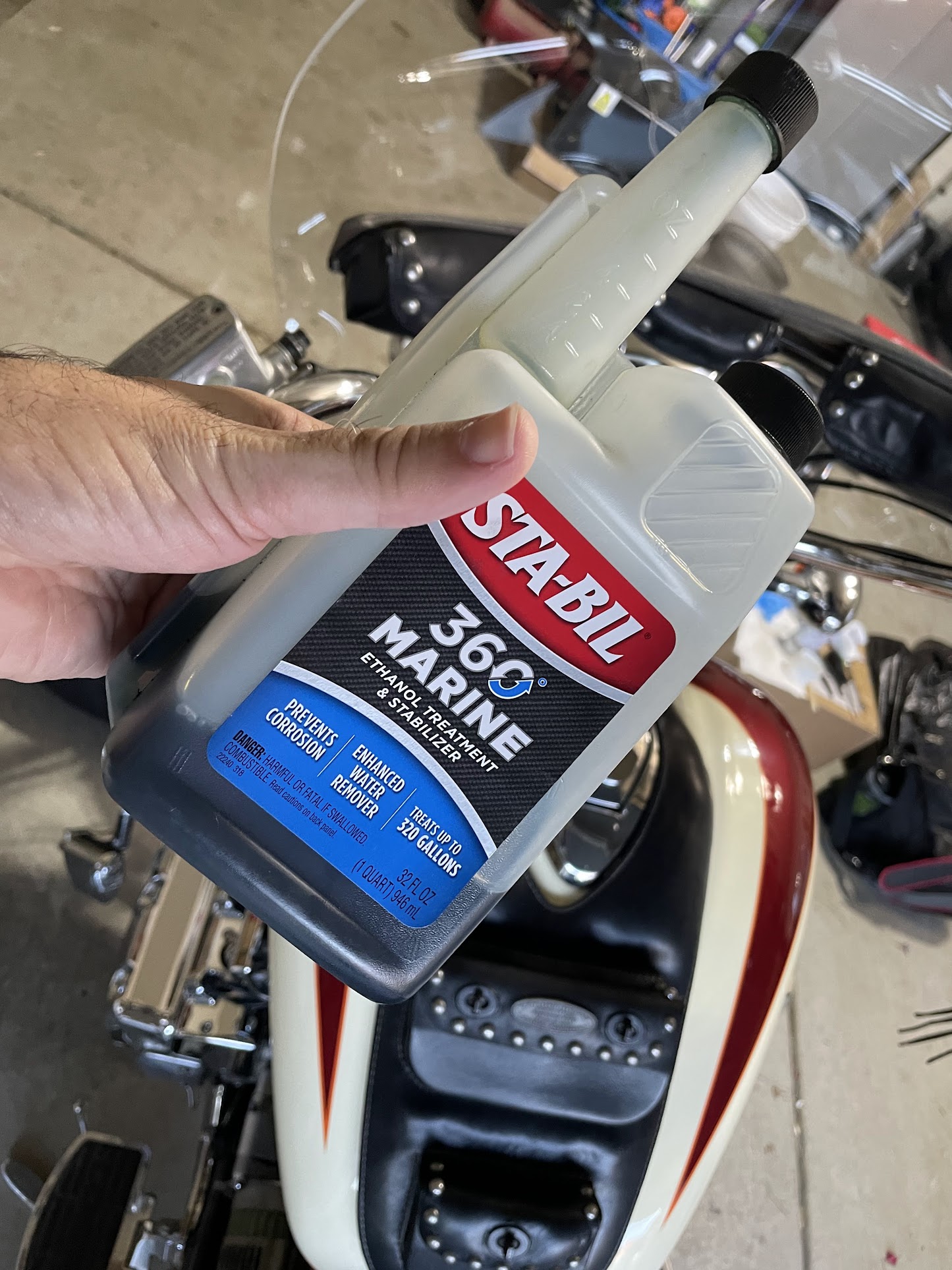

In any case, I'm adding Stabil Marine in the tank when I go to refill it.
I learned about Stabil marine here in this forum, I'm unsure who mentioned it quite a few years ago.
I had my I/S broken for over one year (it was when I borked an alternator replacement job...) and what saved its carburators was Stabil Marine.
I highly recommend it as a fuel stabilizer. For cleaning, I prefer Techron and Berryman B-12.
« Last Edit: June 13, 2023, 11:24:23 AM by Savago » Logged

Getting the solo rack re-chromed might be difficult, as the EPA has leaned on all US chromers.
But you could get it powder-coated a red or creme (paint match), or silver, probably locally too.
It looks very nice in place of the back seat, but in truth, luggage fits better on the back seat than on that curved solo rack (I know, I have one).   Don't give it away, you may want it later.

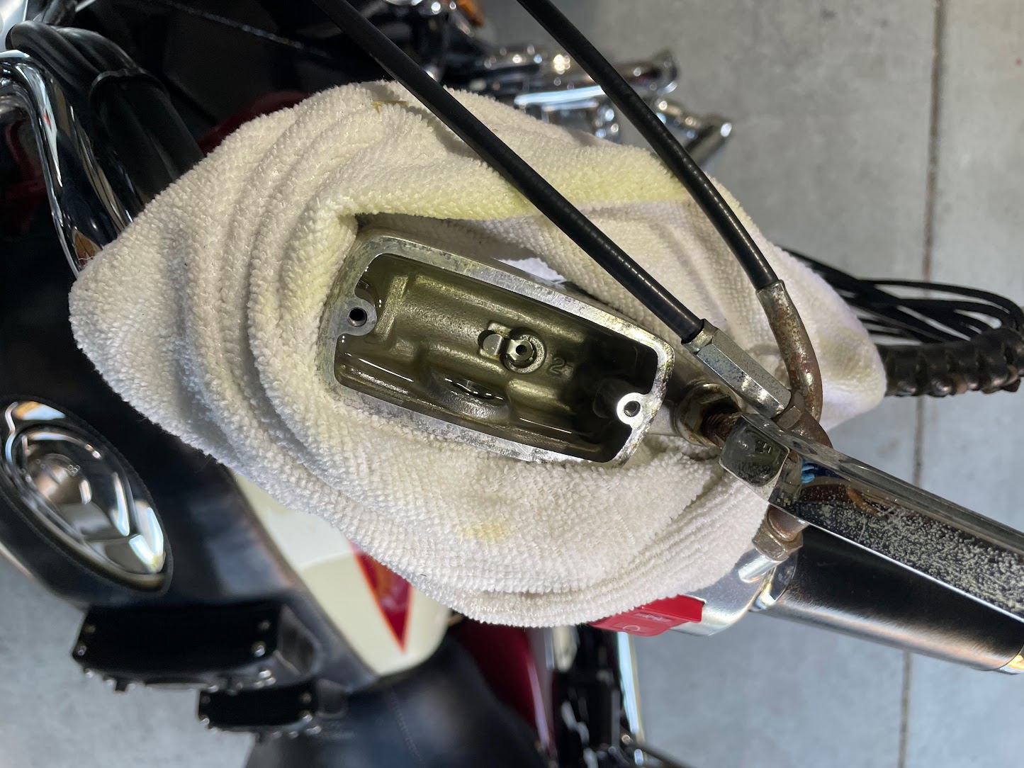

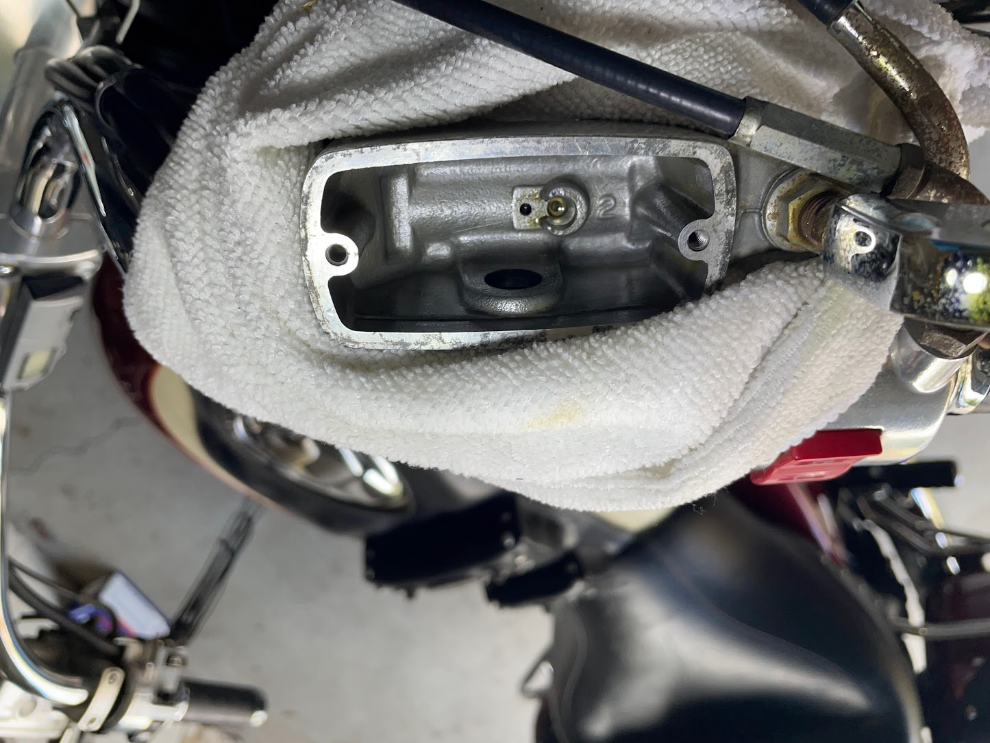

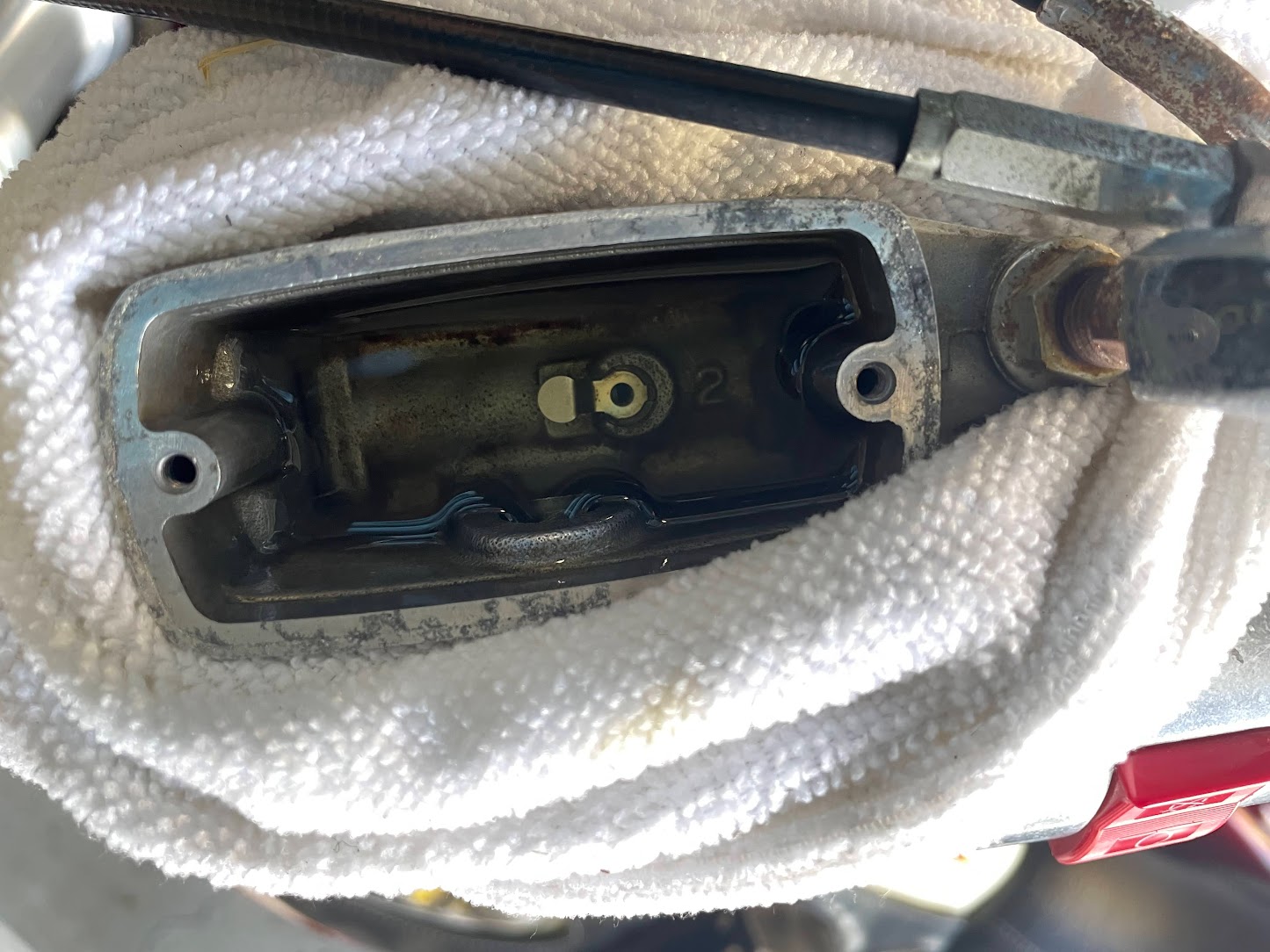

The front brake lever is hard as stone and the bike won't move. I decided to have a look on its master cylinder reservoir and found some crude inside of it.
« Last Edit: June 14, 2023, 12:40:29 PM by Savago » Logged
Savago
Posts: 1994
Brentwood - CA
« Reply #63 on: June 14, 2023, 12:07:44 PM »

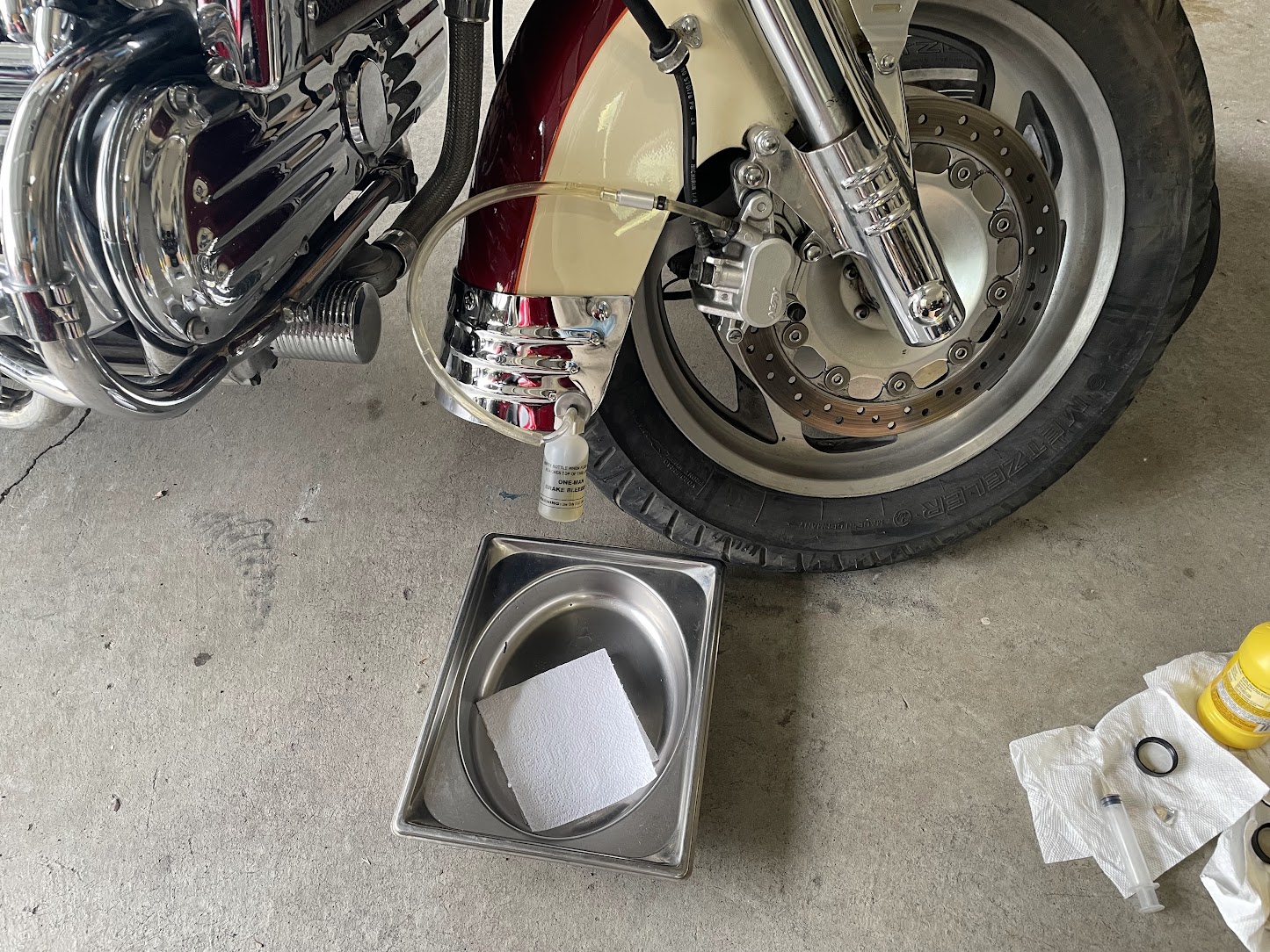

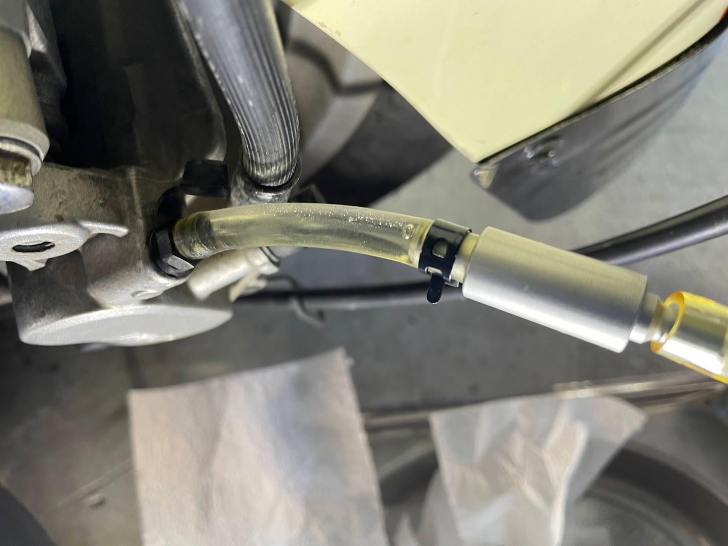

I proceeded with bleeding the brake fluid, I have one of those cheap one-man-bleed systems which I've added an one-way valve to avoid air to be sucked back into the brake caliper.
Savago
Posts: 1994
Brentwood - CA
« Reply #64 on: June 14, 2023, 12:09:56 PM »
So I used a syringe to suck the old fluid from the reservoir and q-tips to remove the crud. It cleaned up nicely.
« Last Edit: June 14, 2023, 12:39:16 PM by Savago » Logged
Savago
Posts: 1994
Brentwood - CA
« Reply #65 on: June 14, 2023, 12:10:49 PM »
Filled the reservoir and proceeded with bleeding the system.
Oh, man! So many bubbles...
Savago
Posts: 1994
Brentwood - CA
« Reply #66 on: June 14, 2023, 12:12:58 PM »
And this is after done.

Many times a stuck front brake is a stuck (or corroded) caliper piston and not a brake bleed.  Without doing a real tear-down, get some mild corrosive auto parts mag wheel cleaner spray, or S-100, or Spray 9, and scrub the daylights out of the calipers and part of the exposed pistons with stiff bottle brushes, rinse and repeat.  Then lube the pins the pads float on (not the pads).  This almost always gives nicer and smoother braking.  IF a full tear-down isn't necessary (sometimes it is).

An update: things took a turn for the worst. Allow me to explain...
After flushing the front brakes before the last ride the other day, I decided to go to OReilly's to buy more DOT 4 fluid as I was planning to flush the rear brakes and the clutch next.
On my way to OReilly's when I stopped in a traffic light, the front brake locked again. I managed to accelerate the bike to the side of the road, towards a parking lot.
I still had the needed tools in the side pannier and drained a little bit of brake fluid just to unlock the front brakes. I figured that as long I don't use the front brakes, it should be fine. Who really needs front brakes after all? They are overrated!
