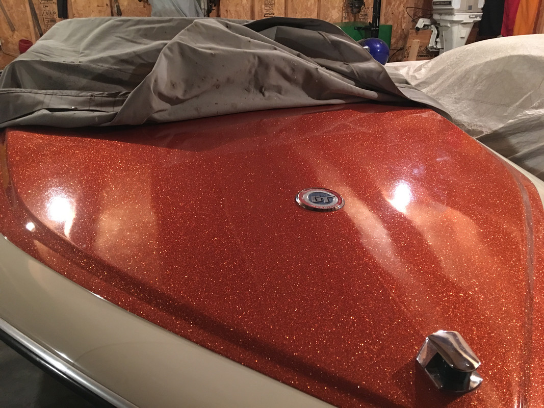

And then we have the Glastron.  1972 Glastron CV16, with a 1974 Chrysler 120
I paid $2300 for the boat, motor, and trailer about 10 years ago.  I ran the motor on muffs but thought it wouldn’t last long, but it has exceeded my wildest expectations.  A new rubber water pump is all it has needed.  The floor though needed to be replaced and I ripped in to that the first year.  I learned a lot about fiberglass and resin very quickly.  The transom had been replaced by someone previously.  The interior vinyl is original along with the gel coat of apricot metal flake color.  It sits high and tight under a canopy cover now.  These light boats are not made for big water, and old 2 stroke motors suck gas like you would not believe.  But, it is a piece of art on water.  The neighbors have named it “The Flying Refrigerator”.  Smiley

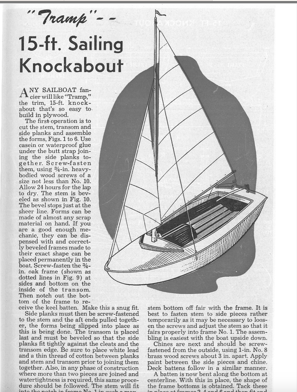

I have not really looked to see if my dad took pictures of the boat I build back in the 1960's.   I did a search and found the plans in the link below which is basically how the built was build.
I built it in our carport sitting on two saw horses dad got me from somewhere.
Oak for frames, marine plywood for hull, 1/4" steel plate for center board, sails custom made from somewhere (don't remember where).  Oh and it was all assembled with glue and screws.   Had to get a special screw driver attachment for our electric drill to allow me to actually get the screens in.
Oh, and the mast was built with laminated spruce.  First try I tied the side stays off at the top and not at the center of effort which was above 1/3 of the way down from the top, about where the jib halyard attached.
Here is what it looked like.   Oh, I sold it for a very small price to a co-workerd in Crystal River, FL when I was working at the nuclear power plant there.   Sometime in 1977 or so.
https://www.vintageprojects.com/sites/default/files/articles/15-foot-sail.pdf
