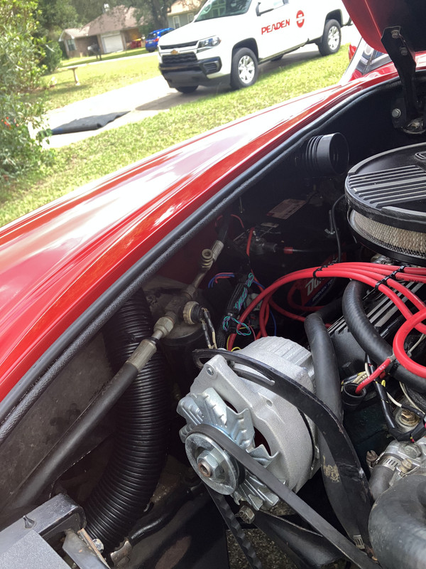

Getting ready for heat shielding operations, phase two. The fiber throttle body spacer helped but, the fuel is still getting too hot. This should put the problem to bed.
I’m replacing the rest of the aluminum fuel line with braded rubber line covered with heat shield tubing and then a fuel cooling radiator up front. There’s really not much else can be done.
Posts: 14895
« Reply #50 on: September 09, 2023, 01:55:48 PM »
Ok so, good, bad and good news. Lol. So, I replaced metal fuel lines for insulated braded rubber with additional heat shielding. I also installed the fuel cooler.
Went for a test drive in the heat of the day. 93 degrees or so. I did 55 miles on country road. LOVED IT LOVED IT!!
Before the fuel cooler and heat shielding the darned thing was getting 7 mpg.  Today 54 miles and it took 4.7 gallons. So that’s like 11.5 mpg. Could be a tad better than that because the sniper had to reprogram itself and I don’t know how many miles that actually takes.
The bad news, it did vapor lock once.
But, good news…it was much milder in that it recovered quickly and didn’t happen again.
I’m thinking about upgrading to dual fans to lower the engine temp a bit. It stays at 200 right now which is not terrible but maybe lowering that 10 or 20 might ultimately fix it.

Well, not sure low long ice will stay ice here in Florida but I just installed an airflow system. Just shop vac hose from the front grill to near the air cleaner and throttle body. Drove a bit today and no vapor lock, not even a hesitant hot start and water temp 20-25 degrees cooler. This could be it in conjunction with the other heat treatments
