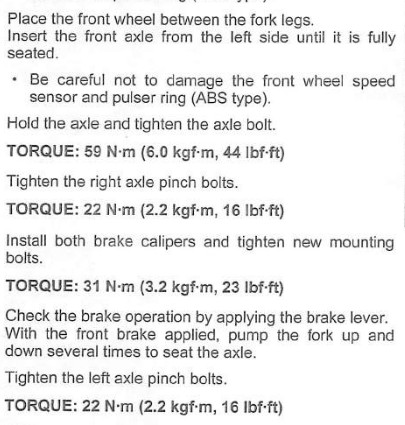

Good afternoon,
I've pulled my front wheel for new rubber. I cannot find my manual to save my life.
I'm looking for torques for front axle and fork pinch bolts.
Also, procedure to navigate around the instrument panel. Not having much luck switching odometer displays. I'm looking for total mileage.
Thanks

July 24, 2023, 07:58:09 PM »
Excellent, that's what I needed....
Thank you
I don't suppose you could tell me how to select total mileage on the odometer? All I can seem to do is change the time....lol
