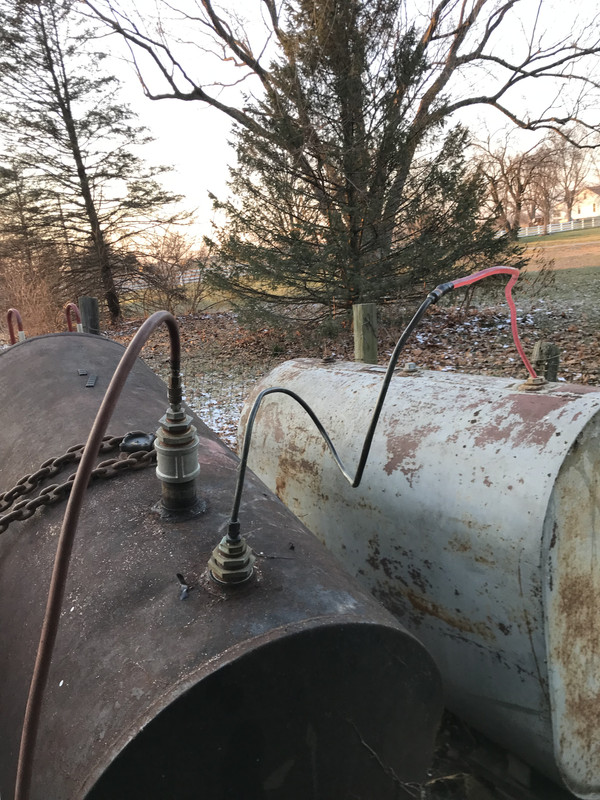

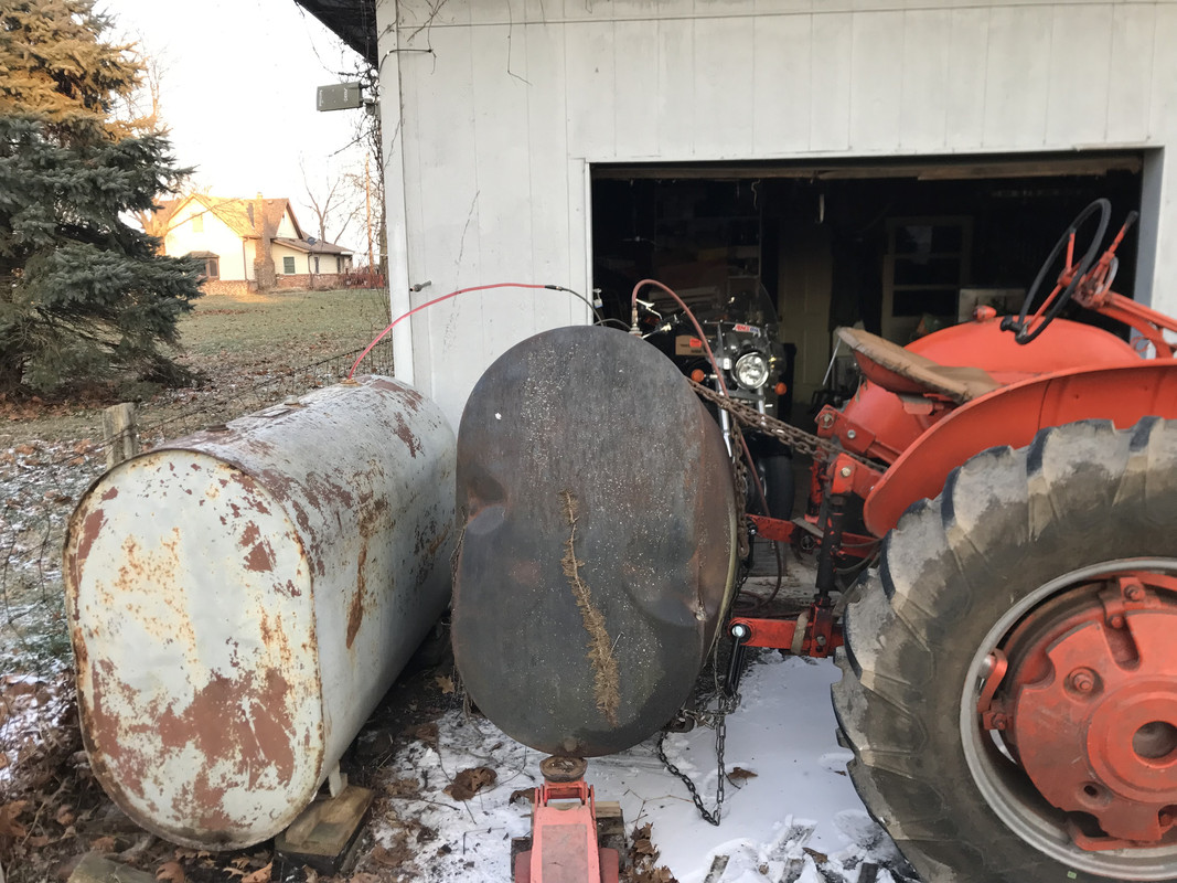

I have been pushing fuel oil with air pressure for quite some time. I have a fuel oil furnace in my garage and the line runs up over the garage door. I use air pressure on the fuel oil tank to bleed the line to the furnace.
In the photos below, I am pushing the fuel from the old tank (attached to the three point hitch) to the replacement tank (unfortunaely the replacement tank also had a leak).
On the final set-up, I have a quick connect for the air supply and a shutoff valve in the garage for the fuel line to the furnace. I use an ordinary air compresser for the air supply.
I have since added a low pressure guage for the fuel tank. I learned the hard way that too much pressure on the fuel tank will cause it to distort (you can see the distortion caused by over-pressure on the sides/end of the old tank). I also added a valve to the air input so I can shut off the air supply without losing pressure.
I firmly believe your concept is doable with a minimum of effort and expense. Set up an air input valve and fuel output valve and you will be in business.
And now the thread is Valkyrie related as you can see my Valkyrie in the background of the first photo.
EDIT: To the extent it is not obvious, the fuel line on the old tank extends to the bottom of the tank.
