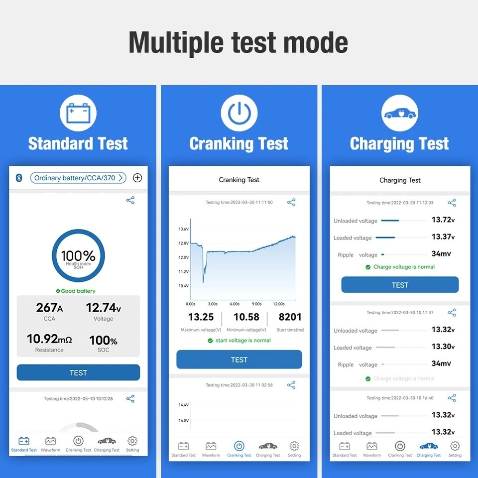

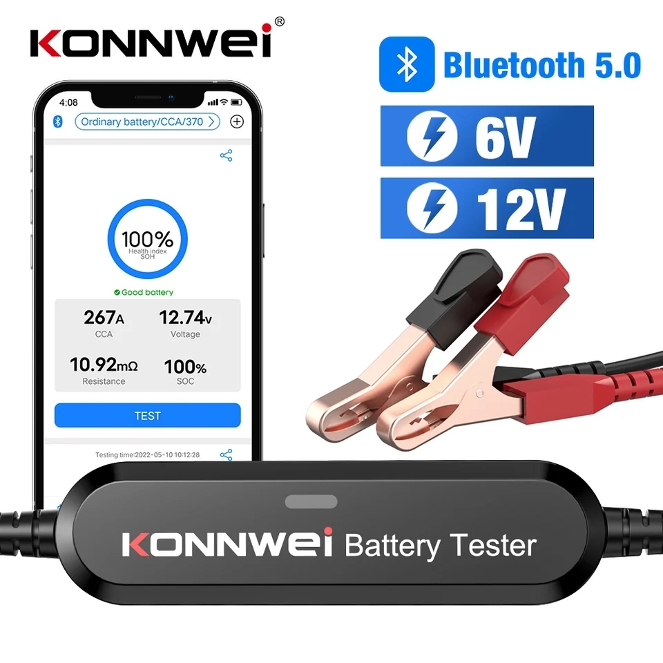

I do use a Konnwei BK 100 battery tester.
Reasonable priced, easy to use, reliable measurement.
Measures CCA and IR. No more guessing about battery health. Gives you a fair warning long before you experience starting issues.
Be prepared to have some six-pack-of-beer visits of friends or neighbors if the word spreads you own this thing.
