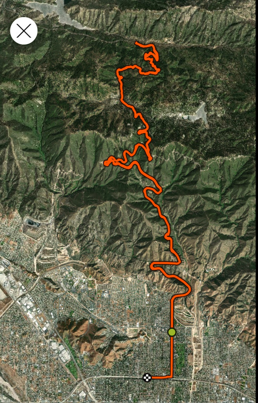

I put the spurs to it on a good curvy ride the other day!

« Reply #3 on: February 04, 2024, 04:39:42 PM »
 I dont think you picked a road with enough turns  cooldude 2funny 2funny 2funny
This bike will never let you down and is always up to wherever you want to go.
I went the opposite way on tires but I may have to try your trick and see how it goes.
Where is that pic at I dont recognize the area.
« Last Edit: February 04, 2024, 04:41:38 PM by Robert » Logged
Big Sherm
Posts: 10
« Reply #4 on: February 04, 2024, 10:40:44 PM »
Robert,
That route was from San Bernardino, California, up the mountain to Crestline, down the other side to Silverwood Lake, and back again.
It’s near me, and the last five miles to Silverwood Lake is so fun, and usually so empty, sometimes I’ll do it several times in one ride.
There are many things I hate about California, but the awesome motorcycle roads are one thing to love!
Sherm

I did that very ride (and others) while stationed at March AFB CA ('87-'92).
Course, I had a different bike back then.
