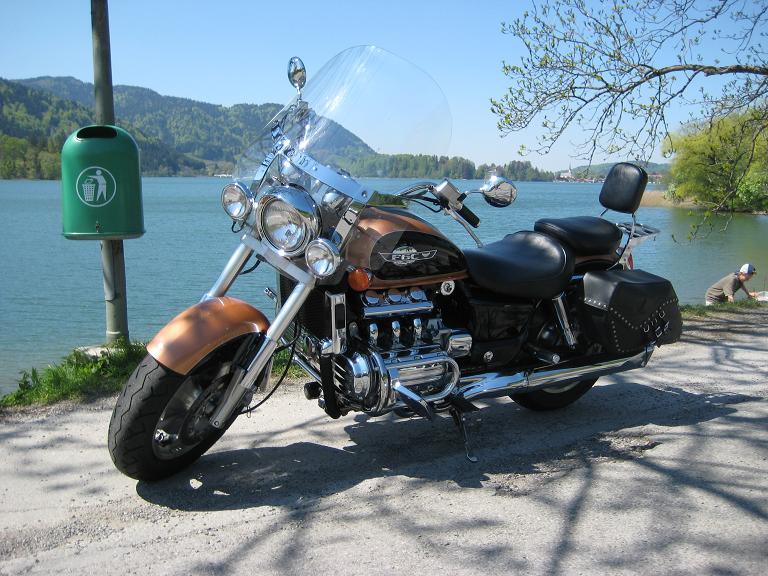

« Reply #6 on: February 22, 2024, 01:03:52 PM »
My ride is disassembled for maintenance ATM.
But here's a picture of this setup from a fellow of mine:

« Reply #7 on: February 22, 2024, 02:05:30 PM »
Thank you.
Just checking...... Are you still able to remove the screen easily with your set up, for occasions where you want to ride without one, or do the spotlights now get in the way?

« Reply #8 on: February 22, 2024, 07:16:53 PM »
That's the only drawback.
As the auxiliary lights become a part of the screen,
You remove the screen, the 2 lights will go with it.
I installed 2 waterproof automotive connectors in the wiring for easy removal.
After I installed a vented wind shield replacement from clearview I had no more the need to remove it,  though.
Much better airflow around the helmet with it also. But that's another topic.
