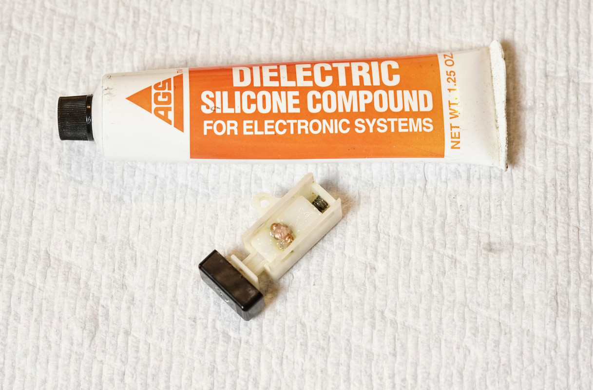

Sure does sound like the starter switch from your description.  It's easy enough to get to.
I had similar symptoms as you.  I opened my switch and it looked like this...
The contacts looked worse...
Cleaned 'em up, re-lubed with dielectric grease and all has been well since...

One note for dielectric grease: it is an INSULATOR. If you apply it too liberally or in the wrong places, it will cause electrical components to NOT work.

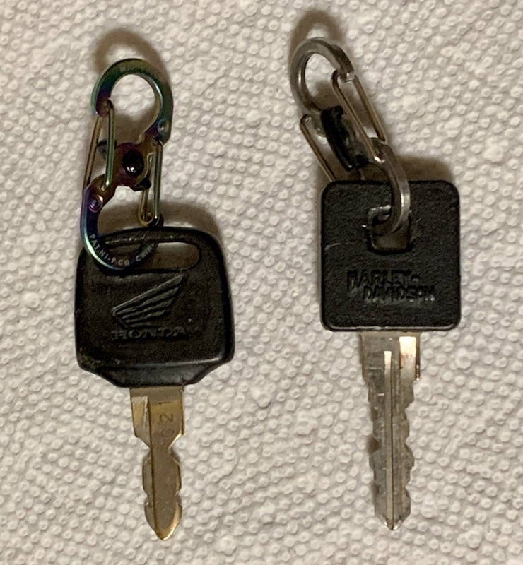

Just a bit of advice with your new switch… A heavy key ring bouncing around can cause the switch to deteriorate rapidly. I use these S-Biners to allow the easy removal of a single key for my bikes.
You just have to remember to pull that key !
