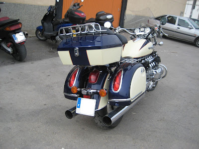

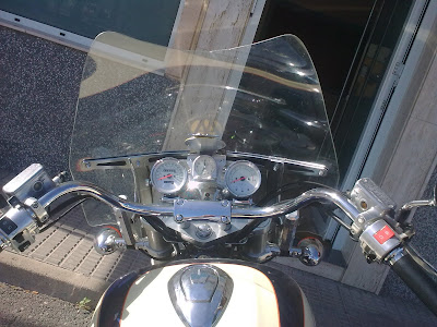

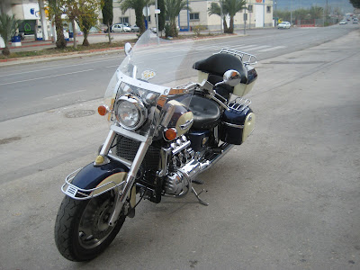

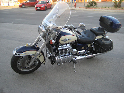

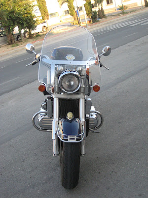

Hello from Spain (Europe).
In my valkyrie I cut the windshield with an electric saw. It was simple and very satisfying result for me.
Valkyrie photos before and after that you may see differences.
This is the final result after placement bag purchased in your country.
A big greeting from the Old continent ..
Ciao

The pattern to cut the windshield is taken from a BMW motorcycle R1200RT 2007.
