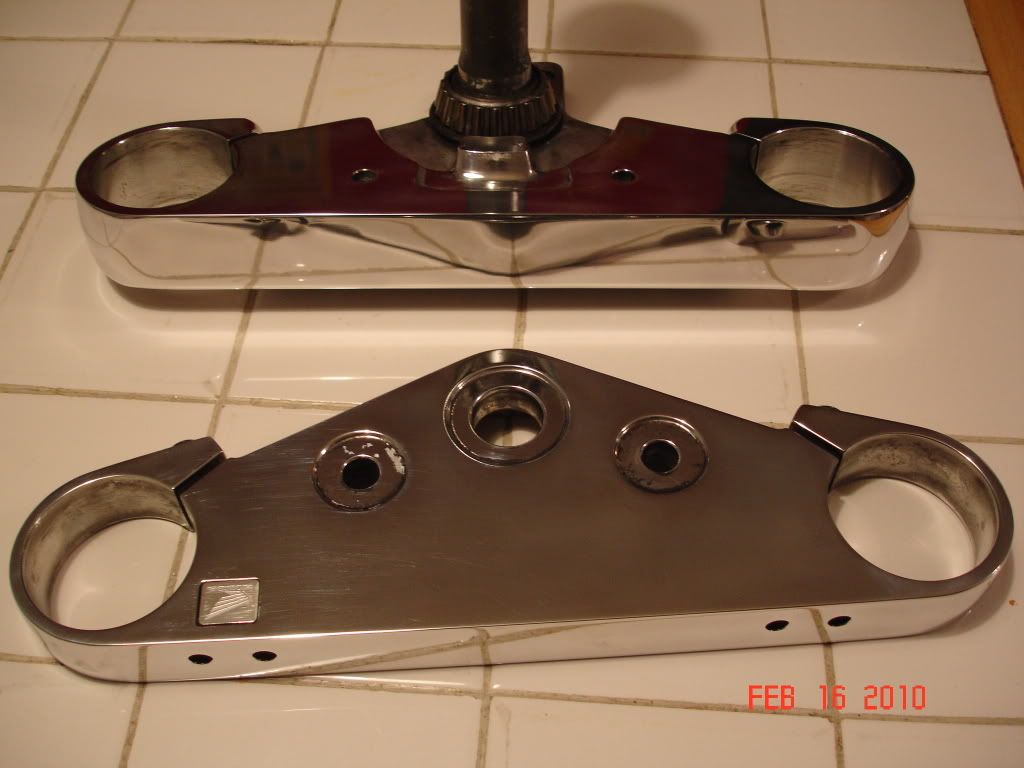

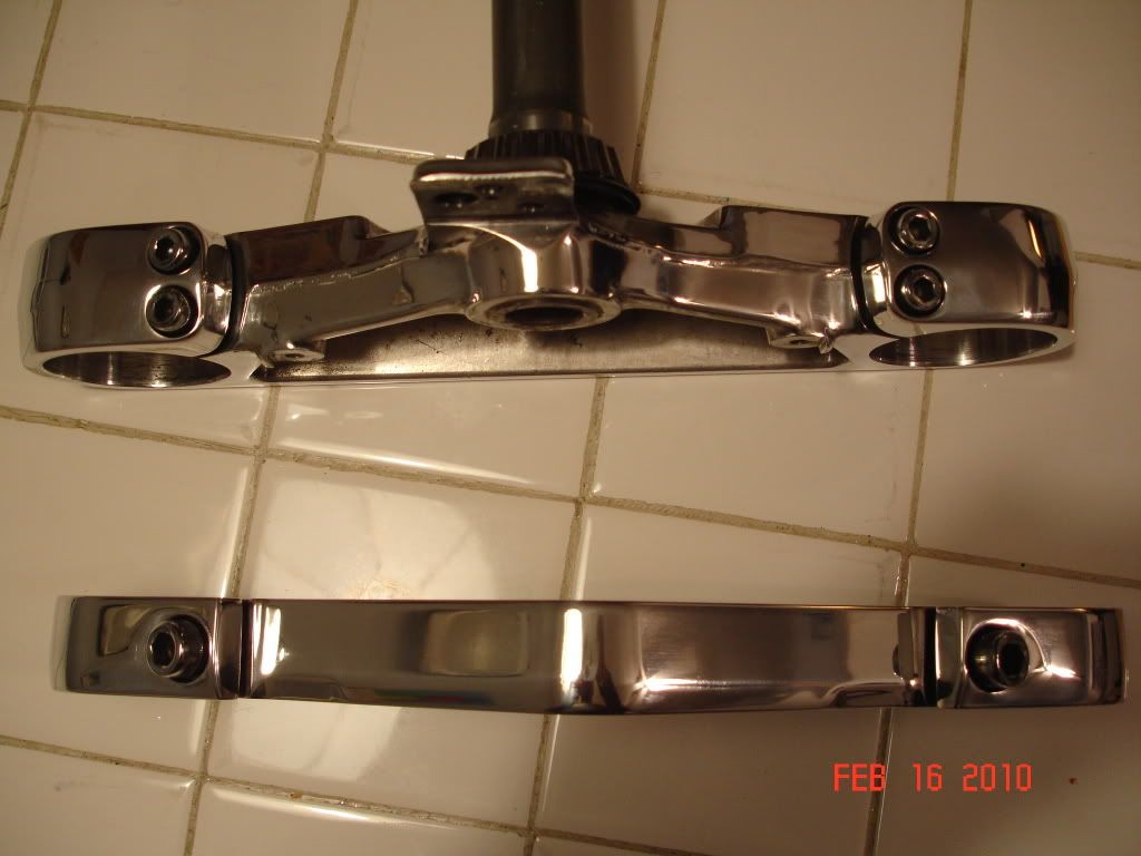

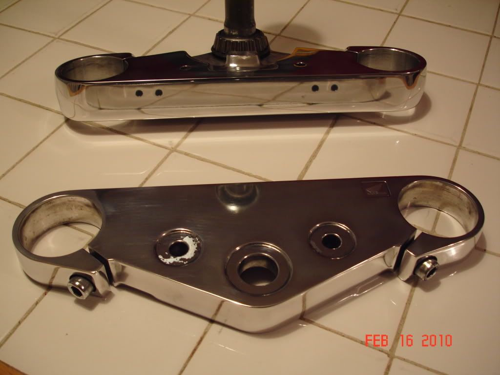

« Reply #13 on: February 16, 2010, 05:06:07 PM »
Well, I got the stock trees polished.  They came out pretty good.  It wasnt really a problem with the steering stem attached.  Im going to see what they are worth on ebay unless someone here is interested in them.  I know Pinwall gets $150 for trees in good shape unpolished.  The first picture is before they were polished.

« Reply #14 on: February 16, 2010, 06:39:25 PM »
Dude...  Yer gettin' to be an expert with polishing  cooldude
I need your address, so I can send my forks to you.  I need them nice n shiny, to match the new Triple Tree Daryl has waiting for me  Grin
Nice job!

« Reply #15 on: February 16, 2010, 08:47:44 PM »
Nice job!
Black Dog
Thanks.  Trees were way easier than the fork tubes.  So you've got the raked trees coming?  Believe it or not, with all the snow we have had, I still havent been able to ride my Valk with the new trees.  Its killing me.  They sure look good though.  Let me know how you make out with them.
