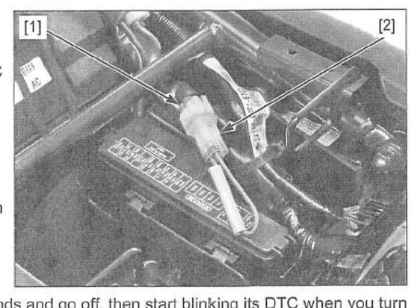

if you keep the key on and watch the check engine light after you jump the two wire plug under the seat, it should flash with the codes that tell you the problem. I would bet its a crank position sensor, I had to replace mine it was not hard and right behind the front cover.
Dont really need a manual most info is on line and easy to get.
Page 87 is the codes when you get the light to blink
https://drive.google.com/file/d/1sH9thSS9ylu0Qpm5blBNb9TcMXm9s_fM/view
This is the Gold Wing but the Valks are similar.
