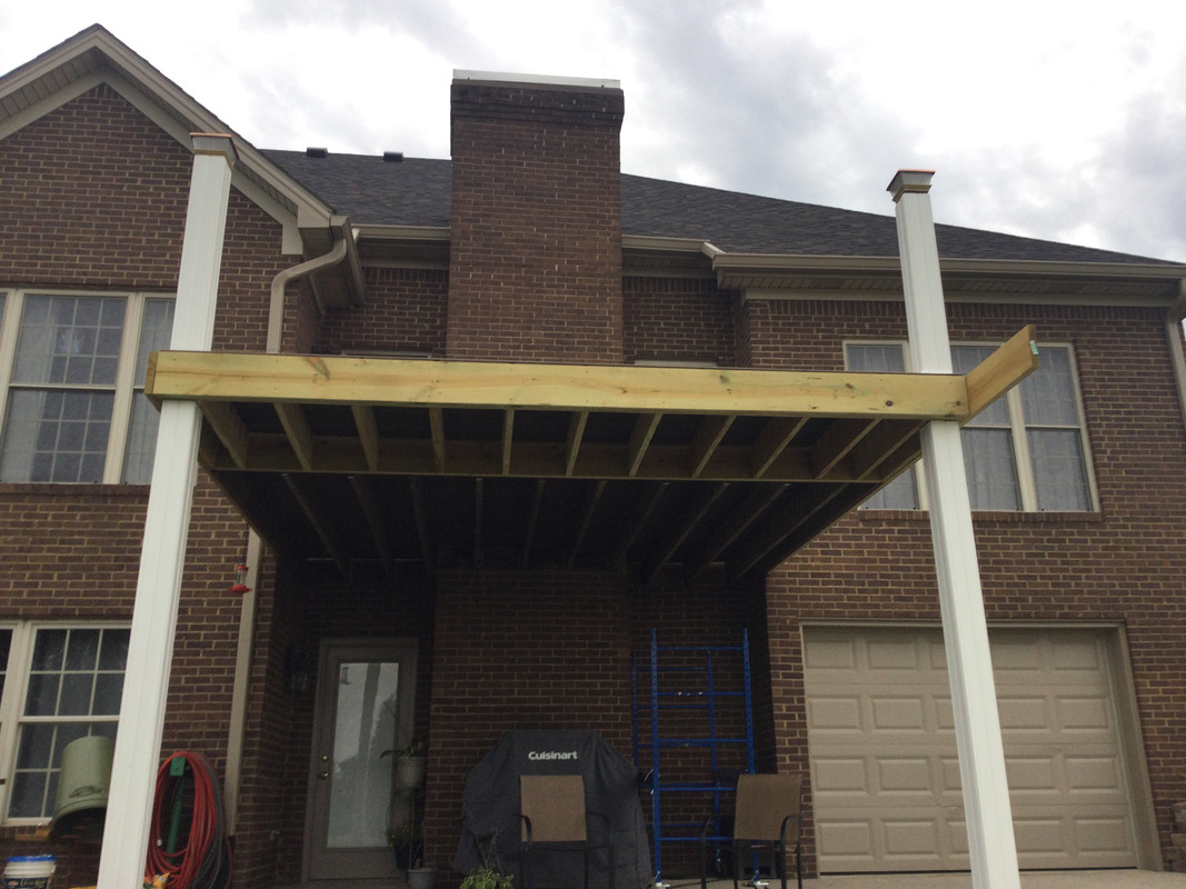

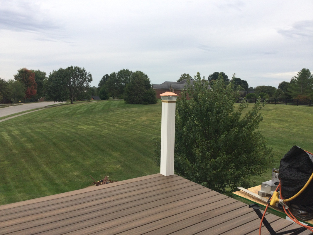

My deck as it was when I purchased my house.
25 years with only two applications of latex solid stain just wasn’t enough for the protection of the decking, handrails and pickets.

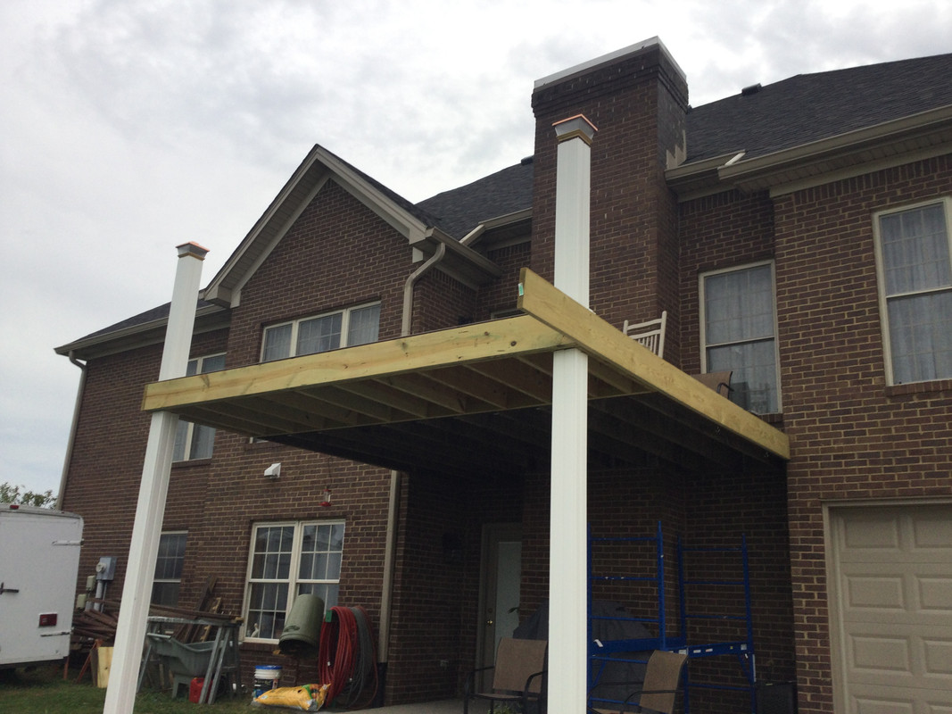

Where I’m at now.
I had no complete plan when I started tearing off the old decking but it was obvious that it was past time to do something. The joist were fine which saved a good amount of money and time or I would have been starting at ground zero. I started putting down the new Trex deck boards before I had all the old boards off so I would have something to stand on. As I got closer to the steps, it occurred to me we didn’t really need steps going down to the back yard, so I tore all that down. That allowed me to extend the deck out another four feet. There is a concrete patio area under the deck and it extended out under the old stair well area, so I gained a lot of space coming out of my basement with zero cost.
I wanted low maintenance so that meant no exposed wood. My remaining two posts were structurally fine but looked awful and was happy to find vinyl post wrap available for 6x6 posts and they came in 9 foot lengths. So two took care of the bottom sections and another package was enough to cover the 4 foot sections above the deck. Current plans call for me to use all aluminum posts and handrails in a bronze finish. And I have also found a company that markets a vinyl product that as I can use as a ceiling underneath the deck that also provides for drainage rain water that passes between the deck boards. I’ll cover the sides of the exposed 2x10 band boards with vinyl also. My wife and I are already going out and sitting on the deck some and we are enjoying the elevated views. Due to the orientation of the house, the deck catches the morning sun, great for that first pot of coffee, and fully shaded in the evenings catches some nice evening breezes. Only a wad of $$$$$ left and I’ll be done.

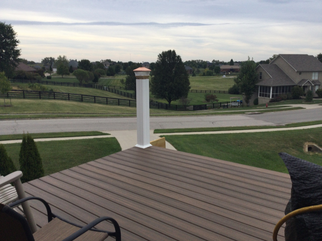

A night view. I’m planning to add some under deck lighting too. We are find the concrete patio area under the deck a much more inviting place since we spend much of our time in the basement living area any way, which was another reason for eliminating the stairs.
