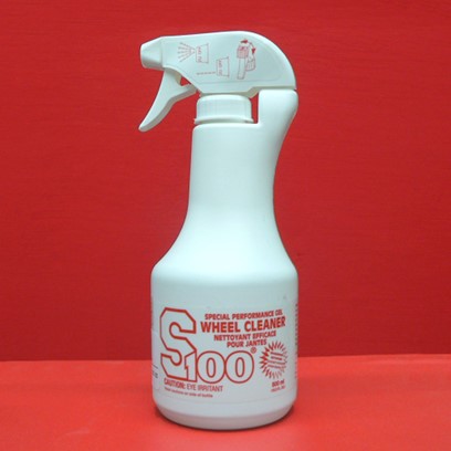

Even if the pads are worn (not shot), I have always found that that a hot water wash and hard scrubbing with a mild corrosive spray and stiff bristle brushes (and a long skinny bottle brush) of every bit of the brakes, wheels and rotors you can reach on the bike, then good rinse and gas blower dry, gives me an instant new and very noticeable 'brake job' from the seat.  Use eye protection (and polycarb eyeglasses don't like corrosives at all).  And my rotors are all worn (cupped), but don't need replaced yet.
I keep my bikes pretty clean all the time, but when I do a thorough wash (wax) up on the lift (so there's not so much crawling around to do, and the wheels can be spun), I always finish with this brake scrub detail, before blowing the bike off (then a wipe down).  I use S100, but all auto parts corrosive wheel cleaner sprays should work.
Jess, I use spray nine,
 https://www.spraynine.com/products/degreasers/spray-nine-heavy-duty-cleaner-1gal/
smells just like S100, It works better and is much much lower cost.
First time I used S100 the smell hit me and I said, I know that smell, where do I know that from?, and then it hit me same as spray nine. went to the storage locker and there was a half filled bottle there. It is definitely the same cleaner. check it out, I've been using the spray nine for over a decade. Still use the S100 bottle filled with spray nine.

I keep a half dozen bottles of spray nine all over the house and sheds (for years).
I didn't know it was the same stuff.
I'll do my own test next brake clean time.

Sure if I remember.  I won't do a jack assist scrub and cleaning until this winter crap is all gone.
My gut feeling is if S100 and Spray9 are indeed the same stuff, the S100 is probably a bit higher concentration or corrosive.  The only reason for this thought is that in scrubbing my bike brakes barehanded before, little nicks/cuts in my fingers really burned (leading to full time nitriles), but using Spray9 bare handed all the time, I remember no such burning.
Not exactly scientific.  But neither is a smell test.   Smiley
