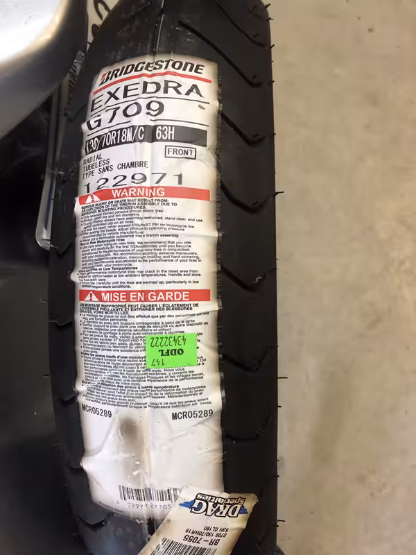

Now the question.  I have a front tire I purchased new over two years ago.  It's a Bridgestone Extendra.  It has been sitting in the garage and I was wondering if just sitting around like that could affect the tires life.
In other words, is it safe to use?
The tire in question:
And how I intend to get the tire and the bike to the dealer.  Oh, using the local Honda Dealer because the person I use to use is no longer in business. Hard to find a local dealer or shop that will do tire changes on my Hondas.

Bill, only two years, I don't think you should have a problem.  (Probably better to have been indoors than out in heat and cold.  Hopefully no sun.)
The general rule is MC tires should be changed every 6 years after date of manufacture (look for week and year code on sidewall), so how long from manufacture date, not date of purchase, Is your question.
On the sidewall next to the U.S. DOT tire identification number you will find a 4-digit number. The first 2 digits indicate the week of its manufacture and the last two are for the year.  For example, 0916 translates to the 9th week in the year 2016.
I also read that tires begin to degrade (from Heat, UV light & Ozone) after 3 years.
Understanding that dealers and bike shops like to sell new tires, when you go it to get it mounted, ask their opinion.

« Reply #10 on: March 04, 2025, 07:10:56 AM »
I will be using it.  I thought I found the date code but... now not so sure.  Here is the picture.

« Reply #11 on: March 04, 2025, 08:05:00 AM »
Manufactured in the 11th week of 2022.
Posts: 7568
« Reply #12 on: March 04, 2025, 10:48:46 AM »
Correct, that is the DOT date code oval.  March of 2022.

« Reply #13 on: March 04, 2025, 01:11:08 PM »
The (VBB) code I think is  the weight and speed rating code...
As every one said  made on the 11th week of 2022..
