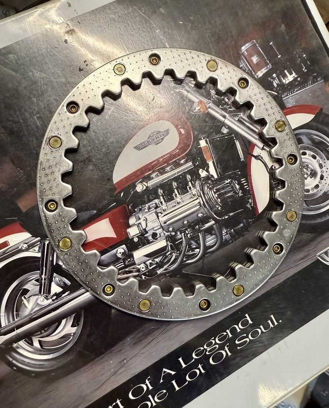

My ‘97 Standard clutch slips at 2500 RPM + under relatively normal throttle.
I was running Mobil 1, did a detergent flush and went back to Honda oil.
That did not fix the issue.
I will be doing the slave cylinder rebuild and system cleaning this week and hope that fixes things.
Too include the little bleed hole in the master.
No problem with lever position  to indicate rivet failure but of if I do need to replace that, is this the correct part to order ?

Usually the main symptom of rivet failure is felt at the clutch lever and clutch slipping can be a symptom, but not as common.
Have you had the rear wheel off lately and checked out the pinion cup?
Good luck, hope you solve it.

yes that is the damper plate. u will need the plate on either side it since they will be damaged by the rivets.
that is all I replace on my '98.
in '97 the Valkyrie Clutch plates are an upgrade compared to the '88-'96 Goldwing GL1500s. '97 to '00 all got the upgrade. actually it was only two plates that are different.
The clutch packs are know to last 300+k miles in the heavier Goldwings while pulling trailers. I bought a spare basket assembly on ebay, pre-'97 which had over 300k miles on it. I measured the plates and they were all within Honda specs.

Half the rivets were gone.

Well I finally got back to this and while all my rivets are still there, they are all loose and the plates are jangly. I guess I dodged a bullet and will now start to clean, inspect and measure everything before I refit with the new parts and re-assemble .
