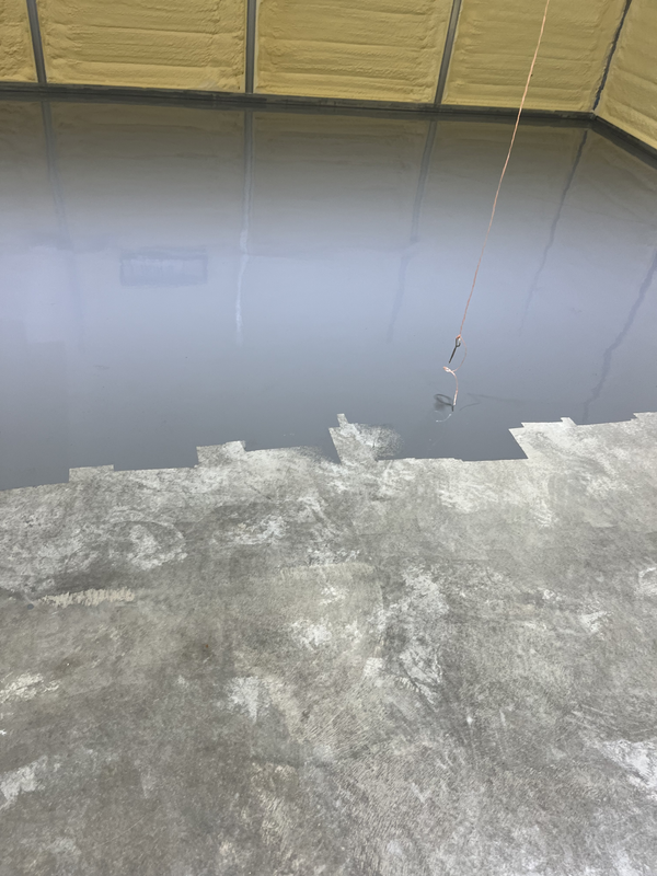

My shop is finally going up next week (if all goes as planned).   Getting the concrete completed was its own challenge but, that's done finally.
Researching the different floor sealants that are out there.   I like what I'm reading about the Epoxy based versions but every brand I read about has customer reviews with both good and bad things to say.  It seems the "Industrial" versions are more of what I want although they are significantly more expensive.   But, you only get this opportunity to do it right one time, the first time and I want this to go well.   I will be applying the surface coat myself.   Prefer a clear version but, a colored version won't bother me, I want a chemical protective barrier that does provide some light reflective results.
I'm looking for a brand/version with chemical protections, not just moisture barriers.   My concrete contractor recommended a product called Eagle floor coverings but, it's only a moisture barrier.
Recommendations with comments would be greatly appreciated.
Edited:  My Fat Ladies (along with a few other toys and projects) will be resting on this surface so, it is Valkyrie related.  Wink

I sincerely appreciate all the replies and advice; I finally took the leap and made the decision and went with Rust-Oleum Rock Solid floor coating.   In that the concrete was new but well cured, there were no floor stains to address so, that made the prep somewhat easier.
The Rock Solid is a complete kit, it contains Citric Acid to use for prep.  That somewhat surprised me but, it was pretty effective in etching the concrete.   Made it look like hell but, it did its job.
I bought three kits, each kit contains two multi compartment bags, Part A and Part B for a total of six bags of the product.   Each kit is supposed to cover 350 to 500 square feet.   My shop is 1,200 sq. ft.  When ready to apply, you squeeze the Part A bag until the interior seal bursts and then shake/mix for three minutes with the Part B bag.   Cut the corner of the bag and let the mixture come out.   The first bag surprised me and I allowed it to come out way too fast but learned from that lesson.   The mixture is rolled on.
I used five of those mixture bags thinking I was done.   The next morning approximately six hours later, I saw some spots where my non-professional coverage was light.   So, I prepared the remaining bag of product and started applying where applicable.   Made sure to give the area extra where heavier vehicles tire would roll through to access the two-post lift (yet to be installed).   My biggest disappointment is that I was unable to eliminate the flying insect issues.   Once those insects land on that wet rolled on Rock Solid, they are there permanently unless one is able to reach and pluck them out.   Unfortunately, I now have some insects forever entombed on the floor of my shop.
Close inspection shows the less than perfect application of the product but, I learned a lot about this and would not be afraid to do it again.   I have pictures I'd like to post for anyone interested to see but, I've tried numerous times and I'm pretty sure its Operator issues keeping me from achieving that goal.
Here ya' go:

Serk,
Thanks  cooldude
For those wondering, the picture of the finished shop floor is how it still looks after curing.
The light/white spots in the finished photo is a reflection of the ceiling lights.

Mike,
I hope it holds up also, those three boxes were pretty expensive.   We erected and assembled the two-post yesterday, used my Kubota tractor with its front end loader.   Maneuvered the tractor all over the shop with some very tight (short radius) turns.   No damage can be seen on the Rock-Solid floor coating.
There are spots on the shop floor that would prove this wasn't done by a professional but, overall I'm happy with the results.   Now, just waiting on the electrician to come back and run conduit and wiring from the breaker box.   We/I wasn't 100% sure on the exact placement of the lift until we actually started erecting it.
« Last Edit: June 24, 2025, 10:43:09 AM by Rams » Logged

I’m kind of curious on a couple things, how well does it roll on, does one paint roller make it through the process or does the material begin to cure on the roller?
Also, how were the vapors any issue with the smell or fumes being too strong as you were laying it out?

Mike,
Each box comes as a complete kit which includes two foam rollers.   The mixture rolled on very well.   I messed up on the first bag and poured way too much in one spot, don't do that!  I have to assume one roller for each Part A/B bag.   I did not have any issues with the product curing on the foam roller, I kept it moving and wet but, the product supposedly cures/harden with in about an hour depending on temp and humidity.   One thing I did finally figure out is once that mixture starts curing, don't try to go back over it with the roller, it won't look nearly as good once finally completely cured.   Mine took more than that estimated hour but, about six hours later (next morning), that foam roller was solid as a rock.   After looking at my floor that morning, I found several spots that didn't get as much coverage as I wanted so I used the last (sixth) bag of the Part A/B I had left and spread/rolled it with the second roller in that kit.   In that each "Kit/Box" comes with two foam rollers, I've now got four never used foam rollers (if'n you want them).  Wink
Reference any "Vapors":  This kit uses Citric Acid mixture for the "Etching".    Apparently not as strong as Muratic Acid, I'm not a chemical engineer so I really don't know.   What I can say is that Citric Acid did a fine job of etching my previously slick finished floor.   I highly recommend using a stiff bristle broom to go over the floor to help the citric acid do it's job.  I used a weed sprayer to initially spray the floor then went back over it with that stiff bristled broom.   Yes, if you get this product on your skin, you will know it but, a quick visit to a garden hose solves that.  (Don't ask me how I know this.)  Wink
I did not find any vapor issues with the Citric Acid but I kept all the windows and doors open and two fans going throughout the process.   There was a Chemical Odor (Hard for me to describe) when applying the Rock Solid mixture to the floor but nothing overwhelming and the steps I took to keep air moving must have been more that sufficient because it honestly wasn't a big deal.   My wife even commented while assisting me that it wasn't bad at all.  So, I can say there were no breathing issues, headaches or aftereffects, I'm as normal as I was before this experience.   crazy2
But remember, I did this whole process at night and leaving those doors open with the lights on also invited every dang flying insect in this part of TN to come in for a visit.   Many of those insects decided to land on my still wet floor.   Some of which I was able to pluck off the floor, but some are also permanently entombed within my Rock-Solid floor coating.
As I've tried to pass on, getting that dust free floor after etching was by far the most difficult part of this process.   The instructions clearly stated that if one swipes your finger over the floor and gets any dust, the floor needs another cleaning.   I swept, mopped, vacuumed, pressure washed that floor multiple times seeking that dust free floor, I wanted the coating to adhere/stick.  Kind of anal but..........
I'm convinced and hopefully right that this product (although expensive) will provide the floor coating and reflection I was seeking from the start.   Hiring it done was not an option although, hiring an experienced person would have probably resulted in a better job being done.
