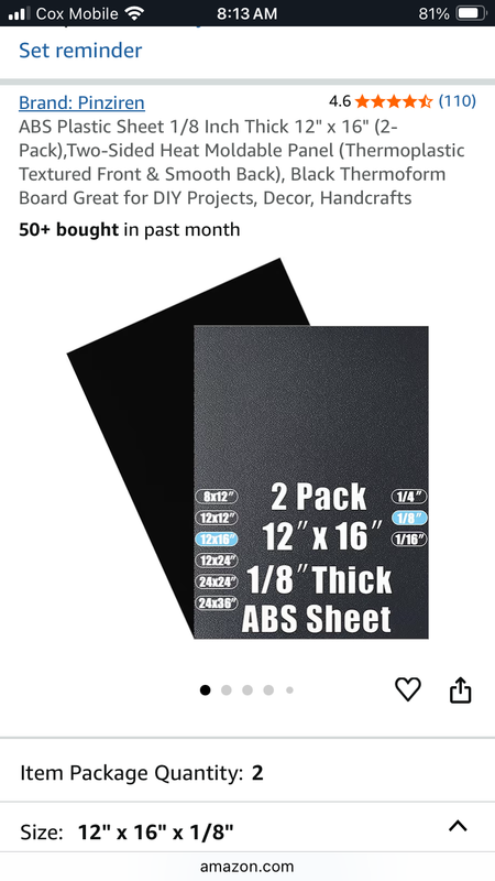

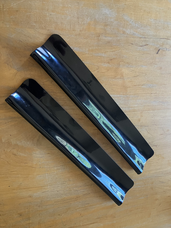

I found this plastic on Amazon. It’s essentially very similar if not exact the same as what your truck leading edge hood deflector is made of.
I needed to direct some airflow a little higher over our heads while driving especially at highway speeds.
You can place this in boiling water or like I did, use a heat gun and it gets very soft do you can make it any shape you need and then it cools pretty fast and doesn’t change the finish at all. It’s really neat.
These seem to be making a difference.

How are they attached to the windshield frame?
Posts: 14897
« Reply #3 on: May 23, 2025, 03:18:32 PM »
There is a 1/2” deep groove in the leading edge of the top of the frame of the windshield.  The groove is for the soft top to mount to. The plastic wasn’t thick enough for a tight fit so I made dimples along the edge that goes into the slot. After a couple tries it wasn’t hard to get the right size dimple so it was a snug press fit

Took the car to breakfast today. What a huge difference at highway speeds. This will make longer drives less tiring. The constant buffering was not horrible but after awhile it’s a bit fatiguing.
Mission accomplished  cooldude

amazon link?
Posts: 14897
« Reply #13 on: May 25, 2025, 10:42:24 AM »
amazon link?
I searched heat foldable plastic
