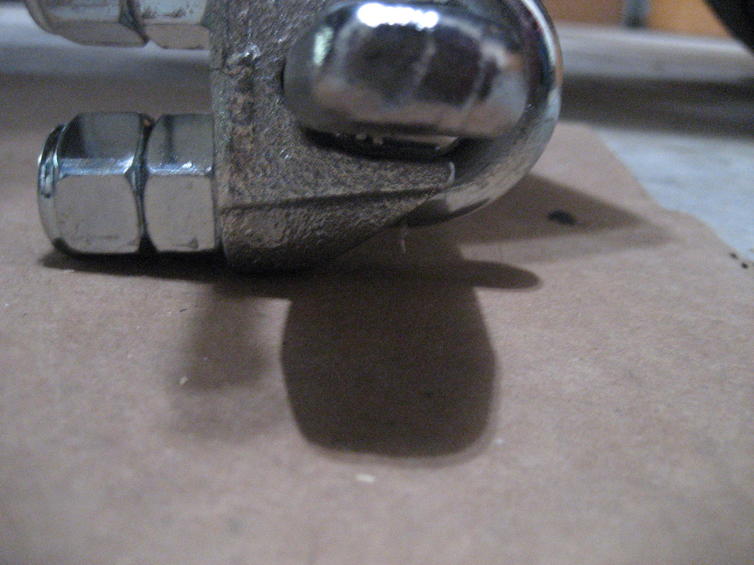

Thanks to 98 Valk, I fixed my "too Long Kickstand"
He showed a photo of a 1/2" wire cable clamp.   He had used it for 6 years and loved it.   He said to take the saddle clamp off and just tighten it down with the nuts.   It worked fine.
THAT BEING SAID:    I didn't think it got the bike high enough off the ground to help me that much.
So I got a 3/4" wire/rope cable clamp and used the saddle clamp.  It worked like a charm  It got the kickstand more than a full inch off the ground.   The saddle clamp is made like a V so the wire or rope will fit in the grove to tighten.
The V (grove in the cable saddle)  just fits the kickstand and positions it in the middle of the saddle.
Boy is it tight!  + the threaded ends are lone enough to take two nuts, making the stand stronger.
Use a locking nut for the last one.
My hardware store didn't have a 1" wire/rope cable clamp.   3/4" was the biggest the had.  I think it will be big enough.
Sure is a lot easier to get the bike up.
If you also turn the bars to full right lock the bike comes off the stand and up like a feather (heavy feather)  but a feather.
Here are some photos!
