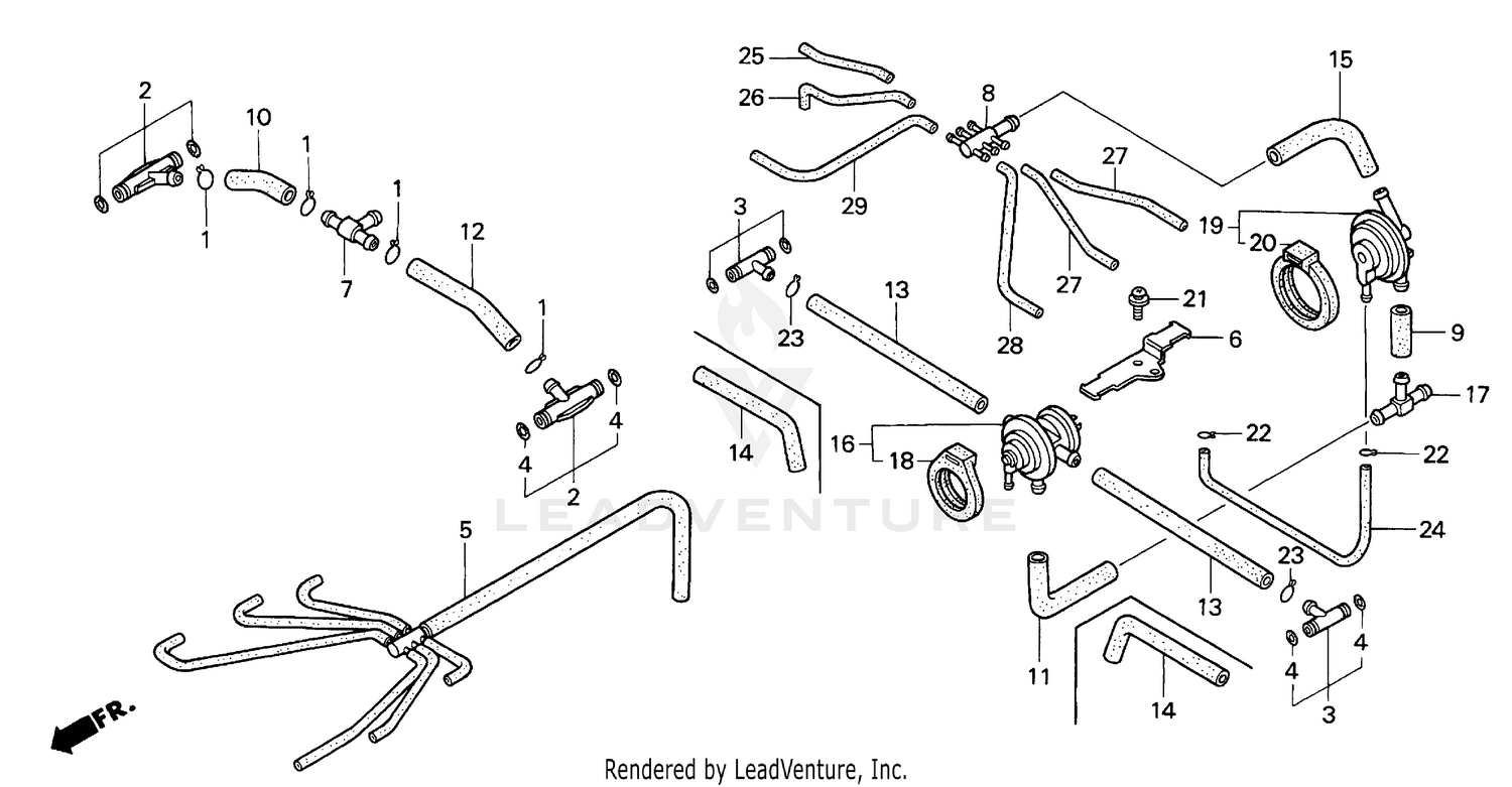

The nipples that need the vacuum caps are the ones on the back of the intake tubes towards the bottom closer to the top of the motor.  (the ones in this picture)
https://i.ebayimg.com/images/g/-t4AAOSwP49nBWUm/s-l500.png
The nipples on the carb bowls are a drain for the bowls, they do not need to be capped.  They originally would have had set of rubber drain hoses attached that merged and ran down under the bike.  Those hoses are not needed. (Part number 5 in this diagram)
https://www.motosport.com/api/oem/image?aria=&arib=&arim=&path=/image/HOM/2b0756ee-868b-41f7-9078-e85bf0324301/Medium&zoom=5

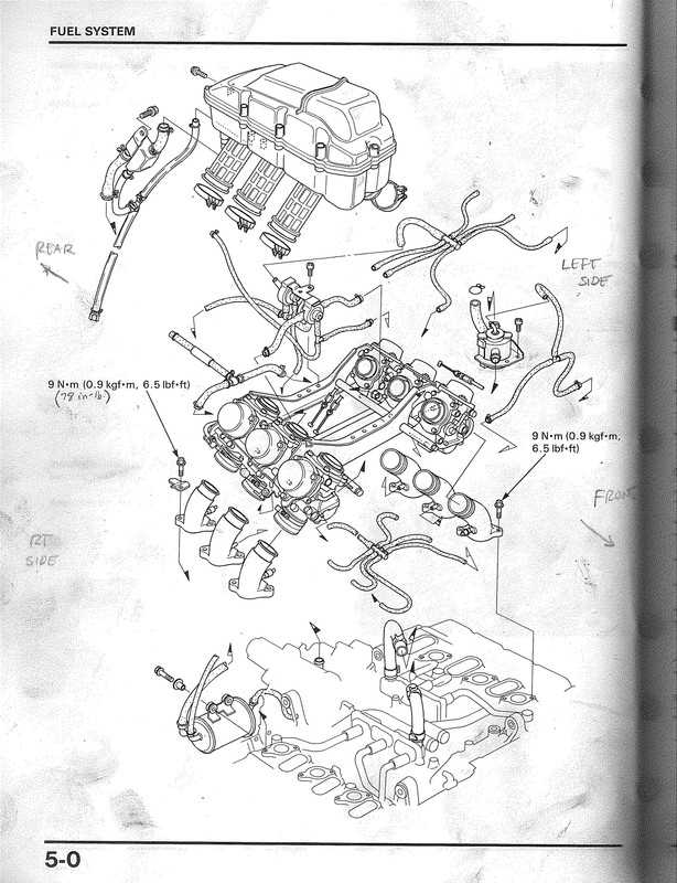

  You gotta get a schematic of where those tubes go.   If I can find the image of the diagram from the manual, I'll post it.
    There are several sets of hoses on the Valk:
     1.  there's the carb vent lines which come off at the top of the carbs, only letting out the gas vapors from the gas evaporating from the carb bowls, and on a Calif. model, eventually get routed down to the evap carbon canister.
     2.  there are the drain lines at the bottom of the carbs, which, in a perfect world, we would drain out when the bike sits long to keep our carbs from getting gunked up from old gas.   But no one's perfect...  me especially.
     3.  there are the vacuum lines below the carbs on those short curved chrome downtubes going straight into the heads.  These are problematic and need to be checked frequently, since they will cause primarily backfiring on decel if they have cracks or leaks, and lean running.  One of them, #6 keeps the stock fuel valve open, and lets it shut off fuel when the bike isn't running... not a bad thing.  the other two, IIRC, control the evap system... not sure.
     4.  and then there's the fuel lines coming in from the top.  Can't forget those.    Also, those T fittings and their tiny o-rings will eventually leak in an older Valk, 20 years old or older.
end of 1st chapter has many hose diagrams.
Posts: 7404
« Reply #12 on: July 02, 2025, 06:07:42 AM »
Section 1-23 is the one you are looking for.  It shows all of the vacuum and supply hoses.

attempt_at_posting_that_image...(spacebar_doesn't_work)
