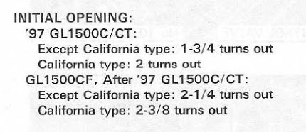

Re: 97 carbs
July 22, 2025, 02:42:45 PM »
I'm not sure what is different internally, but the initial pilot needle settings are different.
