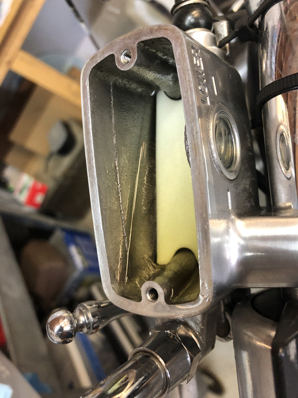

The image above is a picture of the clutch master cylinder.  I have since raised the handle bars to hopefully not have the fluid so tilted.  But, the handled bars have been tilted (more than shown here) for about 20 years with no issues.
So, I suspect a failed rebuild on the master cylinder.

« Reply #4 on: July 25, 2025, 02:26:27 PM »
Turn the bars all the way to the right, fill it and do a clutch circuit bleed job.
I would do this before another clutch master rebuild.

« Reply #7 on: July 27, 2025, 04:35:51 AM »
I had a clutch like that. I removed most of the fluid from the master cylinder then forced fresh fluid up from the bleeder to the master cylinder. That restored the function.
