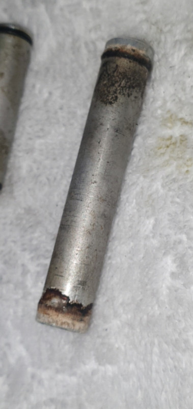

Here's a photo of one of my fuel rails with your beloved o-rings. I'm the second owner of my bike and I did not use any fuel additives besides some stabil over the winter. Besides the fuel rail rings obviously being trash all of the other rings were dry and flat as well. Were all of the o-rings leaking? Of course not but obviously I was not going to just rebuild part of it. The before and after of the ultrasonic cleaning of my carbs is night and day. Take the o-rings out of the equation the ethanol leaves a green varnish in the bowls too. You're lucky, we get it but a day will come and your carbs will leak, more than likely starting with the fuel rail which you have been tightening down instead of just replacing the rings. I don't know why I continue to get baited into these replies but the two biggest carb rebuilders for these bikes are awesome guys who contribute to the valk community and are clearly not out there just trying to get people to rebuild there carbs for no reason.
so your the 2nd owner. so first owner used aftermarket fuel additives, etc.?, that ate away at the o-rings.  its is still amazing that u don't understand, 10% Ethanol does not eat away at OEM Buna-n o-rings. Honda in the owners manual states engine is designed for 10%.   It seems u cannot except your thoughts about ethanol eating away at the o-rings is wrong. every chemical chart out there tells u that u are wrong.  So then u have more proof that DDT's o-rings after 26 yrs and almost 800k miles where not falling apart.  Sad that u just can't admit that u are wrong.
see that word "Acetone" how many put into their gas? it is also in many fuel additives.
BUNA-N should not be used in highly polar solvents such as acetone and methyl
ethyl ketone, nor should it be used in chlorinated hydrocarbons, ozone or nitro hydrocarbons.
Temperature range -54°C
(-65°F) to 135°C (275°F).
Buna gets ranked #1 for gasoline
RATINGS
1 High Resistance - All materials belonging to this class are Completely or Almost Completely inert when used with the
specified chemical at the specified concentration/temperature levels
https://www.gilsoneng.com/reference/ChemRes.pdf
RATINGS
Lol you're laughable man, you say that the o rings last forever, I show you a photo of my fuel rail. You come back with it must be from something else besides the gasoline with ethanol in it which has been known for many years to destroy carbs and everyone knows it but you apparently. One day every single Valkyrie will need its carbs rebuilt, it's just the nature of the beast. Idk why I keep getting sucked into responding to these when I know that it's like talking to a wall and thankfully there's enough members on here that will respond and disagree with you so that new members don't take bad advice and end up catching their bike on fire.
