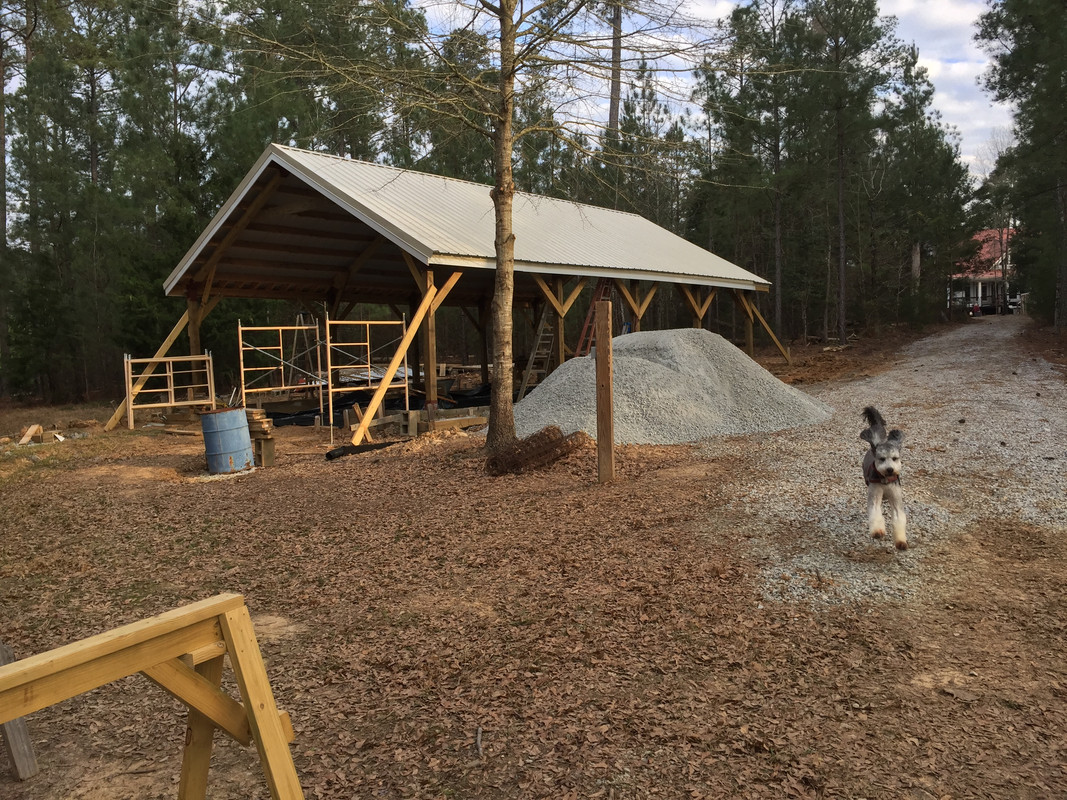

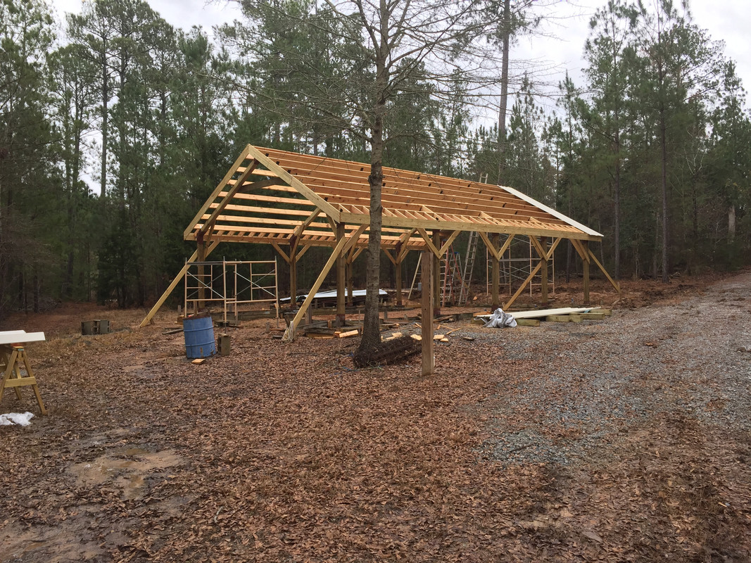

While no where near is nice and as large as Rams “Garage”, I have built two buildings. They are located on different parts of our 8 acres.
The first is what I call a garage and the second I call a workshop.  Each has two open “Carports” and an enclosed work area.  The enclosed work area in the garage is for bikes.  The enclosed area in the workshop is for building stuff.  It has my welding equipment and cross cut saw along with other stuff.  There is also a roll off roof observatory that was the first building I did on our land. But is is a more standard construction (except for the roll off roof).
One of the neat things I really liked about the way they are built is that they are built with a “Frame”.  The frame composed of 6”X6” pressure treated “beams”.  There are four pieces of wood (not counting the cross supports.  There are five pieces of welded steel structures that shape the layout of the beams.
These items are assembled on the ground and galvanized threaded screws are used to keep each assembly together using pre-shaped welded enclosures.
They are they “raised” using a “T” shaped structure that has an opening at the top to trap a rope that is tied to top of the “structure”.
The “T” structure is placed at a 45 degree angle and a rope is tied to the top part of the beam and, in my case, a tractor is used to raise the beam.  The support rises as the beam assembly comes up.
Because of the way the beam bottom mounts are made, once the beam has reached full vertical position it is blocked from going too far.  Then 2x4’s are then used to hold the beam vertical unit it can be connected to the other beams making a fully support structure.

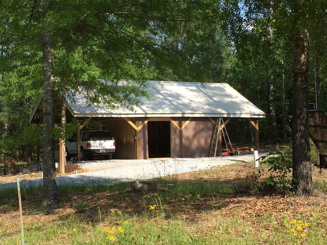

Here is the smaller of the two “buildings.

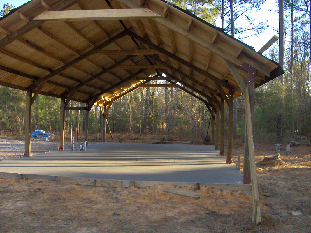

The 2x6’s running from end to end are held in place with brackets attacked to the 6x6 beams. The areas near the edge of the roof have additional wooden members.
A view from one end showing the bolts on the metal and other pieces/parts.

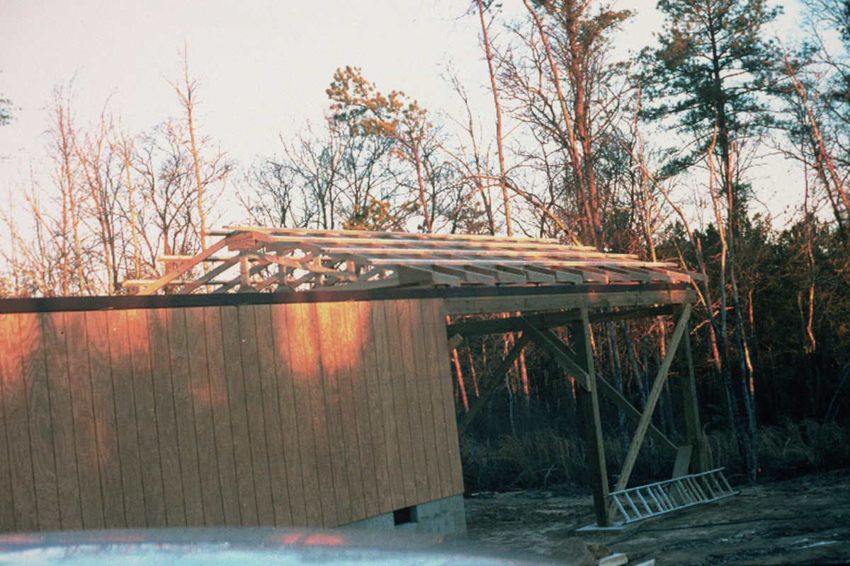

Also note (in the above image) the material under the metal roofing (this is the garage up by the house). I used plywood underlayment on the garage, none on the observatory and workshop and OSB for the underlayment for our house (it was a cost thing.  I should have used plywood).

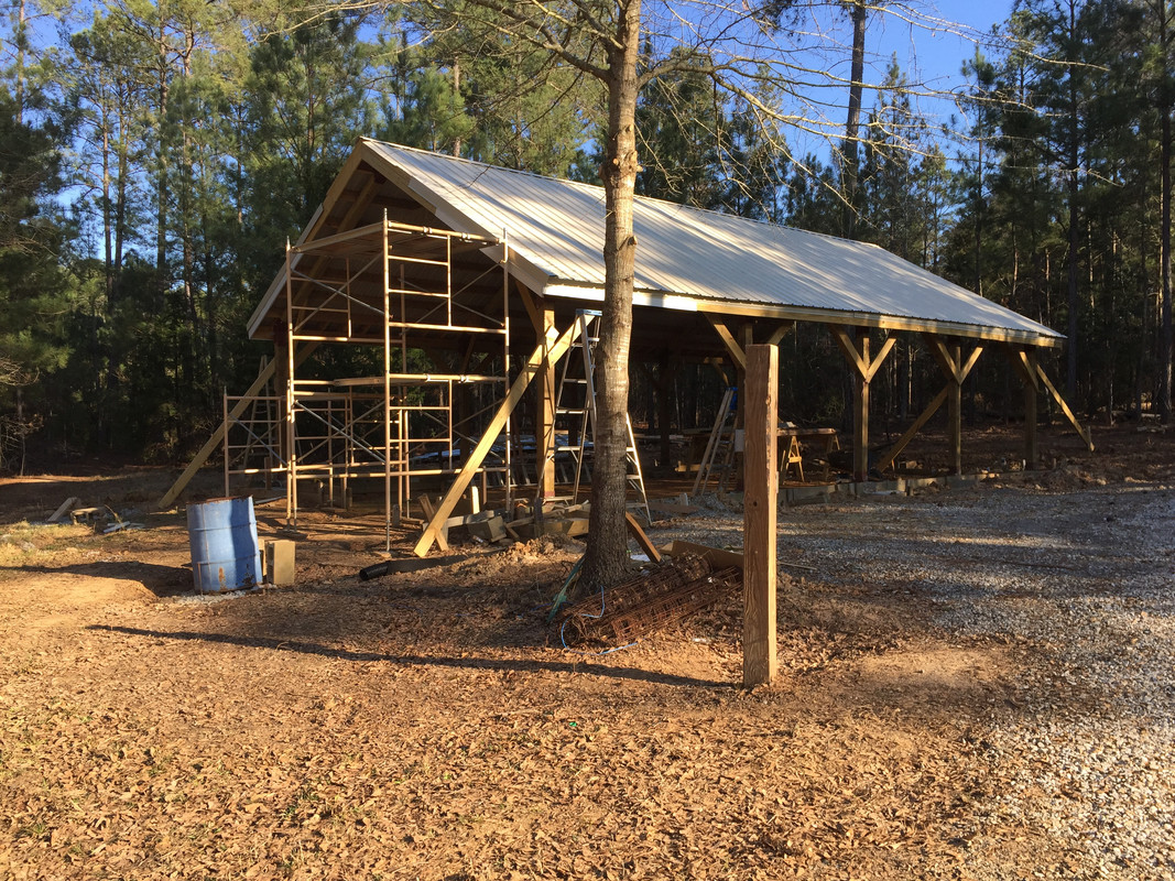

Metal roofing materials (as you might have guessed) maybe installed in two ways.
The first way I did it was on the Observatory building (see pictures below). It has a “roll off” roof.  Then I did the same when I built the last of the three buildings (not counting the house), the Workshop.
The building below is the final building. It has been named The Worskhop.  Its where I now keep the tractor (where the white Ford Explorer is in the picture) and the things that I use to construct some smaller things.
To the best of my knowledge, they no longer make or sell the metal “brackets” that were used to form the building frames as used.
