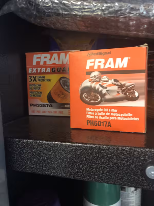

I am getting ready to change the oil in my 2003 Valkyrie and I was looking in my "stuff" to see if I had the necessary items.  I did not have the oil, so I purchased some.  I found an oil filter but it looks sort of old.
The box is ok but a little dusty.  Is there an age limit associated with oil filters.
This one is a FRAM PH6017A but it is in an Orange box.  New ones come in a black box.
I know, its not that big a deal to purchase the new one, but was just wondering.

I don’t want to start a war. But I wouldn’t let my worst enemy put  A FRAM  oil filter in a Valkyrie. They are the worst there is. It’s your bike
Ok..... what filter to you "recommend"?
that was debunked a decade ago.  the ones that people caused to fail where used on very high HP race engines with high pressure oil pumps.

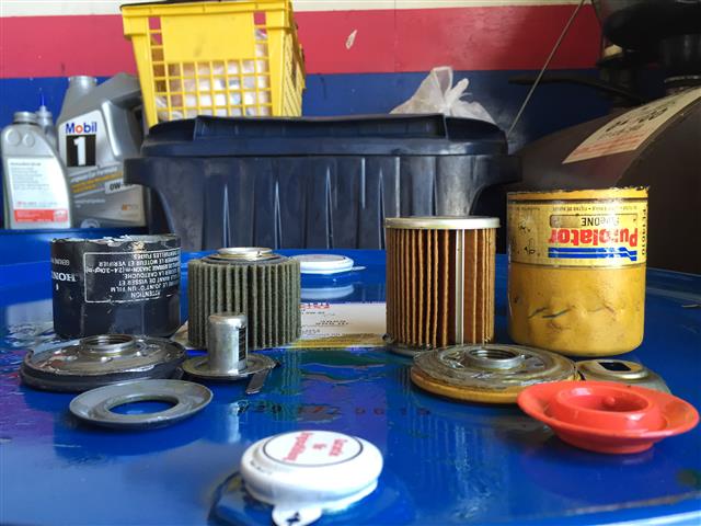

Over the years I've learned lots of interesting stuff about filters. Some of this could be out of date as the industry is constantly changing.
  • After reading great reviews I used Purolator Pure One filters for years. But 10+ years ago they had some serious quality issues. Tears would develop in the media near the baseplate, especially in the 14610 size. Sites like BobIsTheOilGuy still have plenty of posts and pictures. I probably used some defective filters without knowing.
  • Purolator, as well as Wix, are now owned by the German company Mann+Hummel. The motor oil business has seen similar consolidation. Shell now owns Pennzoil and Quaker State. Saudi Aramco owns Valvoline (and Zerex) and may buy Castrol.
  • Walmart Super Tech filters have had several sources. Years ago Champion made them. Champion also made Mobil and Bosch filters. For a brief period Wix made Super Tech filters, and for another period they dropped the line completely and sold the basic Purolator 'Classic' filters. These days I've read that Champion is making them again.
  • After giving up on Pure One filters I used Bosch for a while. When the local store dropped those I tried Super Tech. Being wary of a $3 filter I had the used oil analyzed and found that a Super Tech works as good as a Bosch filter. That was no surprise since the same company apparently makes both.
 cooldude cooldude
Things do change, I use the Pure One new style since its from Mann+Hummel who have changed the filter media to synthetic media. The old Pure One had a bit of deceptive advertising saying it would take 99% of the contaminates out. But the truth was it was only recommended for 3500 miles and they never told you that.
 I don't remember when but most oil filter companies changed to synthetic media shortly after the longer  life oil came out. The reason was the media could not remain unclogged with extended drain intervals in some cases.
 Since I mainly own imported vehicles and they usually don't have canister type filters I remember seeing the change from the
paper filters to the synthetic media. It was interesting the differences in filter material.
  After learning of the change in media and the false or misleading advertising and seeing what a clogged oil filter does I have thrown out all my old filters and bought new. Kept a few around for nostalgia but will not use them.
I also need to say that I used many of the old filters for 8k miles not knowing the hidden mileage claims, but in the idea of wanting the best and avoiding any possible problems I decided not to use my old filters.
These are the old style before the change in company ownership
This is more what the newer synthetic media looks like. Its not quite as fuzzy as the paper filters and more rigid.
