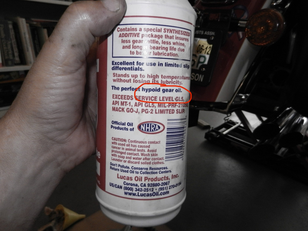

You need synthetic hypoid gear oil. There’s a specific gl rating that will be on the bottle. I think it’s gl5 but I’ll post a picture on this reply in a minute as soon as I find it
Ah... you made me go look at the Valvoline bottle.. Cool -- Yup, I'm good..  cooldude
