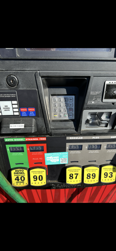

After reading on here about the benefits of ethanol free,I realized there is a gas station less than 10min from where I live that has ethanol free gas. Guess I’ll at least fill up there when convenient. Plan to fill it up soon for winter storage/carb work and add some sea foam.
A little pricey though. I can get regular 87 for $2.85 a couple minutes from home.

I used E0 in W.Va. and N.C. when available. Other than the water absorption problem, I found no improvement. Not power or fuel economy. Also, the water problem is a storage problem, and if you fill the tank all the way, not much of one.

That’s good to know because it’s about a $1.45 more a gallon then regular 87 at the nearest gas station two minutes away
