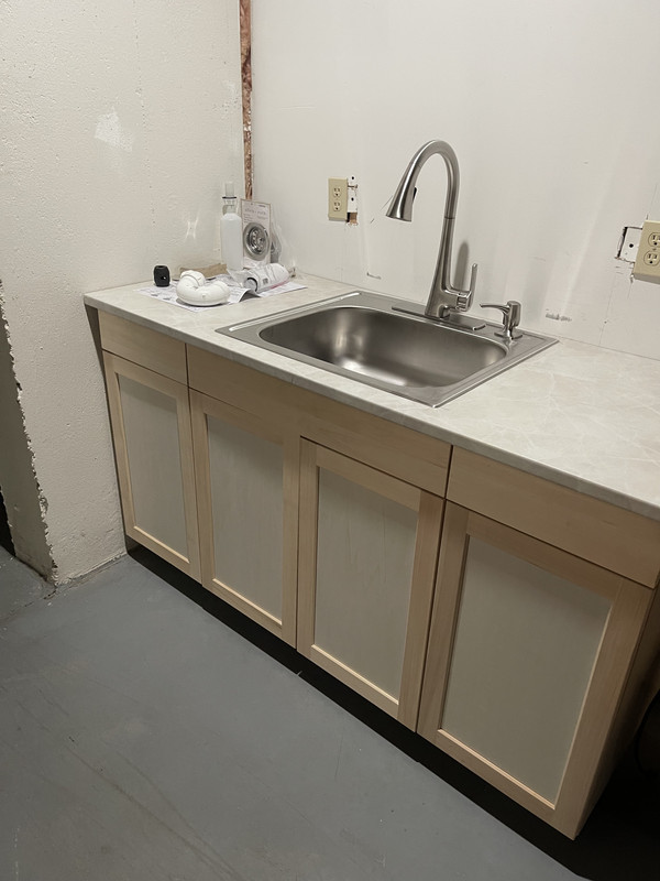

My basement is largely unfinished but I have a stove, refrigerator, freezer, microwaves, cabinets  all arranged in a useable fashion and that’s where most of our meals are prepared which means our upstairs kitchen doesn’t get dirty. The problem has been the only sink is in the garage which is in the basement but you have to navigate the maze of vehicles and tools to get to said sink.
I’ve been bargain shopping for a long time and I finally  bought a sink this week to complete the dream. It almost didn’t happen because I had to pay full price for the sink itself, but it was time. The plumbing has been roughed in for a year now, I’ve had the cheap knock down cabinet longer than that. I scored a deal on some closeout faucets some months back, then this week I got a piece of countertop that would work for $35. So the project commenced today. A few setbacks but this is how far I got today.
I should have a fully functional sink by close of business tomorrow.

Nice work John.   cooldude
I wish I had a sink in my basement utility room, for jobs too messy or nasty for a regular house sink.
Those jobs get done right outside my utility room door, with a hose and bucket.

« Reply #4 on: November 05, 2025, 04:27:22 AM »
Looking good cooldude
I'd make sure those electrical plugs are hooked up to a Ground Fault Breaker at the panel.
Or swap the first plug in the line to a ground fault plug.
Finding out you needed one the hard way ain't fun.

I was counting on you to point out the standard plugs! When I was doing the bathroom rough-ins on the other side of this wall, I added these plugs and since I had this cabinet I put a piece of plywood over it and had a few appliances plugged into them so they are protected on the same circuit as the bathroom plugs.

This will sound like a silly question but is your basement below grade? I’m wondering if your using a lift pump for the sewage and if so are there any negatives to it and how well does it handle the bathroom waste.
I ask if your basement is below grade because I know some people who live in split or bi-levels call the ground floor their basement.
BTW those are some good choices on the faucet, countertop and cabinet.

It’s a walk out basement, front and sides are below grade. I have never had to deal with a lift system. My last house had a full basement and even though it wasn’t plumbed for a toilet , I had all the upstairs main floor drains run down and under the basement floor.  Some 20 plus years later when I wanted to have a toilet in the basement, I was able to tie into the main stack which gave me the drain and the vent. I then used a toilet that sat flush on the floor and the drain opening went out the back and through the wall into the main stack. It used a pressurize tank to insure a good horizontal flush, worked like a charm but it was about a $600.00 toilet 12 years ago. The plus was no sawing up a concrete floor.

Ran out of time yesterday to complete my job. I had running water but the drain was never completed as I had to take my wife to an eye doctor appointment. Rummaged around in my leftover fittings bucket and came up with everything I needed to hook up the drain this morning. On to the next challenge!
