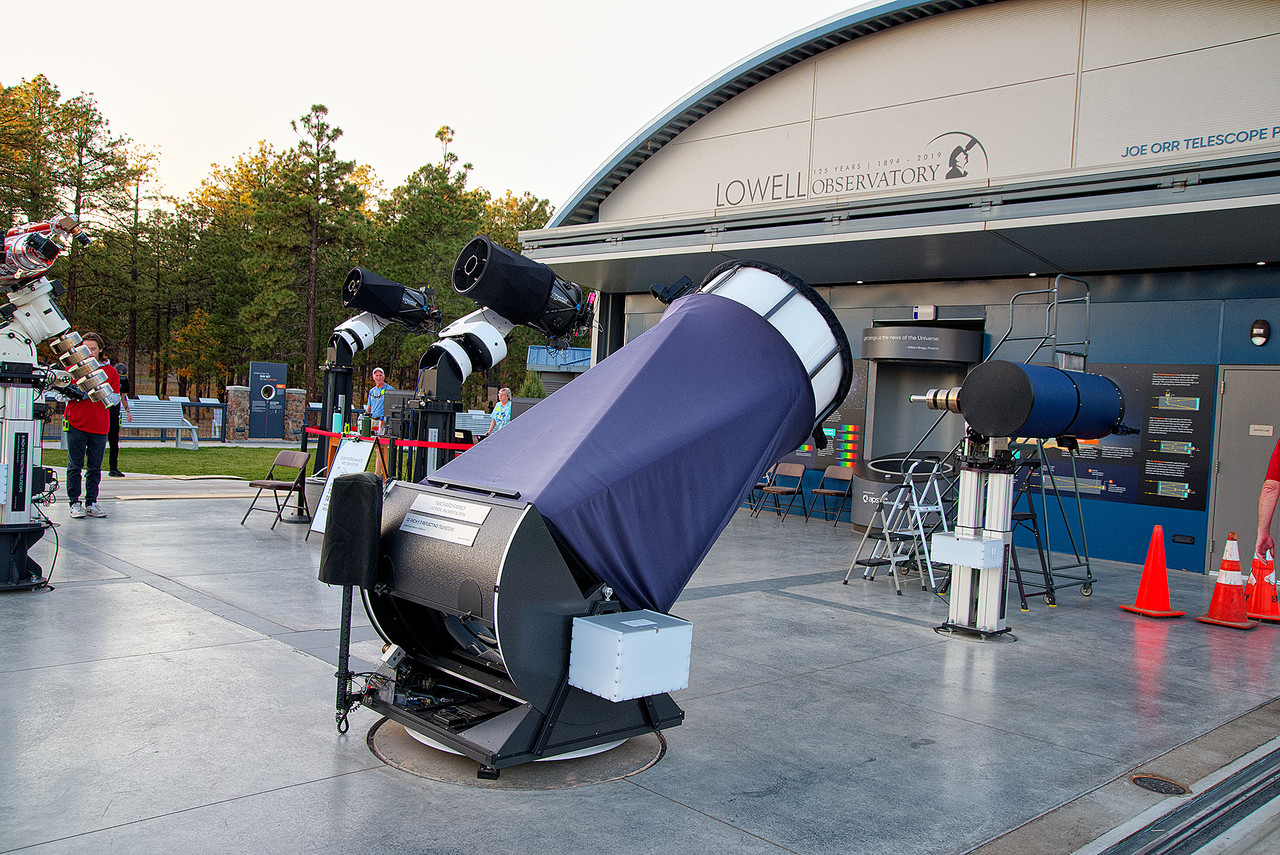

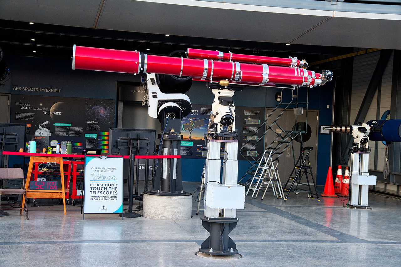

Here are two pictures. The first is the 10" f/5.0 telescope on a Dobson Mount (again easy to build just need some teflon strips and some vinyl flooring material that has been tested over the years to work well).
The 10" mirrored scope is about 60" high.
The second is the 24" f/4.0 Telescope.  It does measure about eight (Cool feet from ground to top of the telescope (but I have never really measured it.). Oh, and a ladder is required to access the 24" telescope's eyepiece in 90% of the cases.

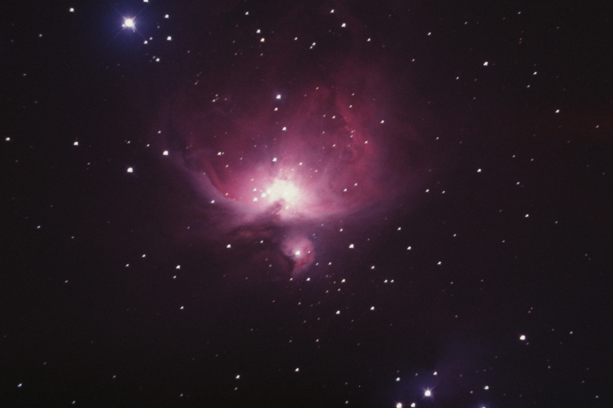

Some photos I have taken with the telescopes I have made.  The first is a 35mm color film image.  You have to guide the scope fro 40 or so minutes to get a good image.  This is of the Orion Nebula in the constellation Orion.

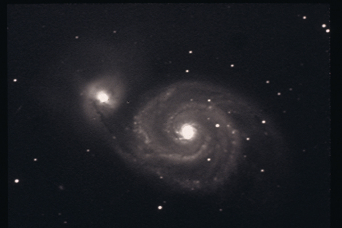

The second image is M-51 also called the Whirlpool Galaxy. It was taken using a CCD Camera that I purchased and built.

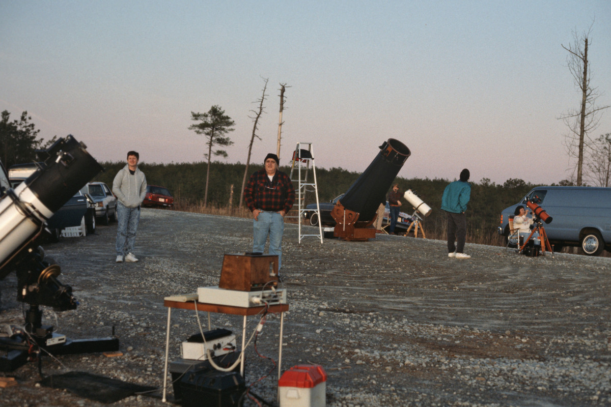

Star Parties were a thing back in the 1990's and 2000's (don't know about today).  But here is a picture taken at a star party our local Astronomy Club (Midlands Astronomy Club) hosted .  (Probably late 1990's)
The man in center front was one of the founders of our club in the Midlands of SC.  The telescope in the back of the image (with the black cover) is much like the 24" Dobson shown in my pictures above.
In the center front of the picture and to the left is the telescope I used to take astrophotos.  Since then I transferred that telescope to my observatory and built the 24" for star parties.

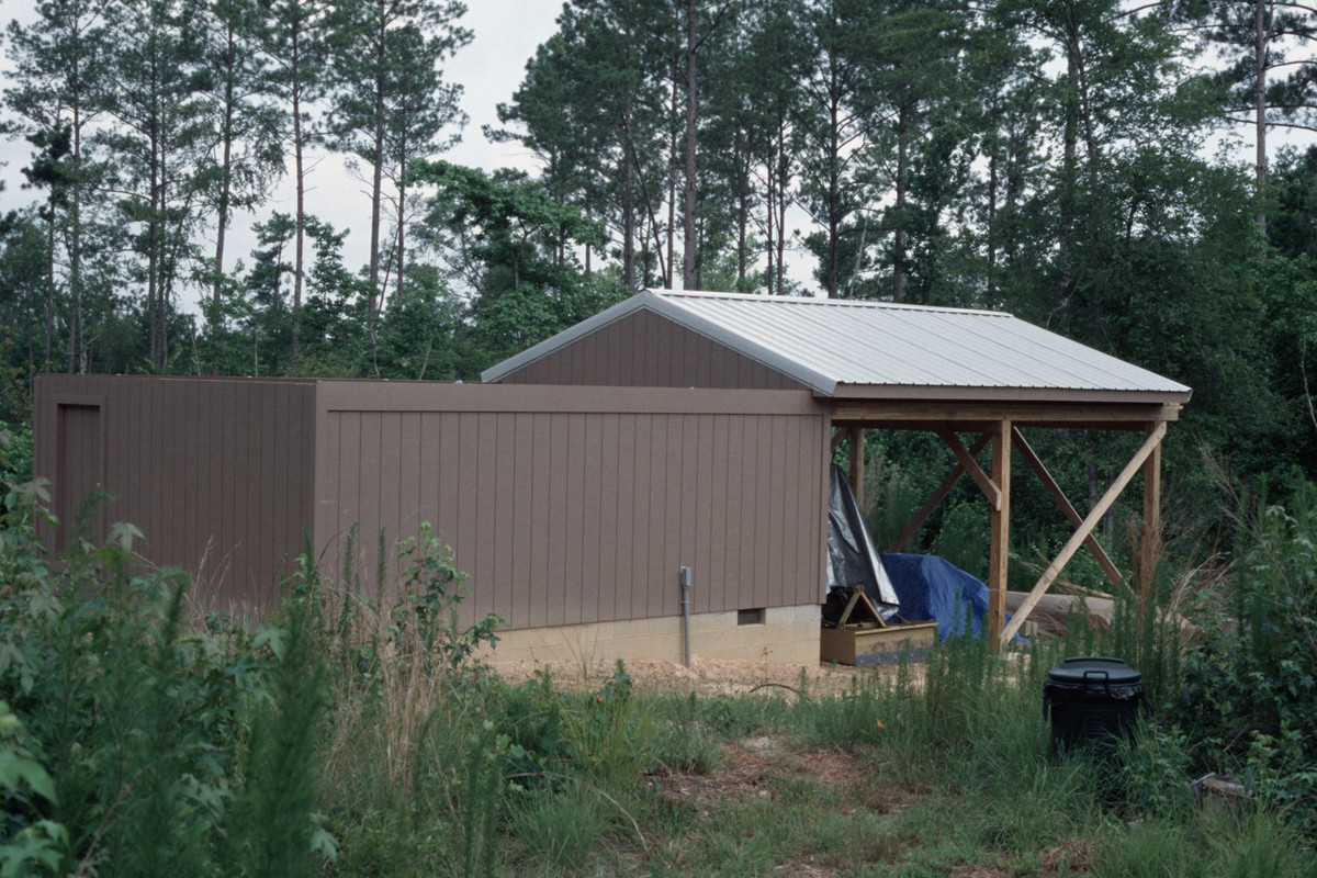

This is the observatory some friends and I built in the early 1990's.

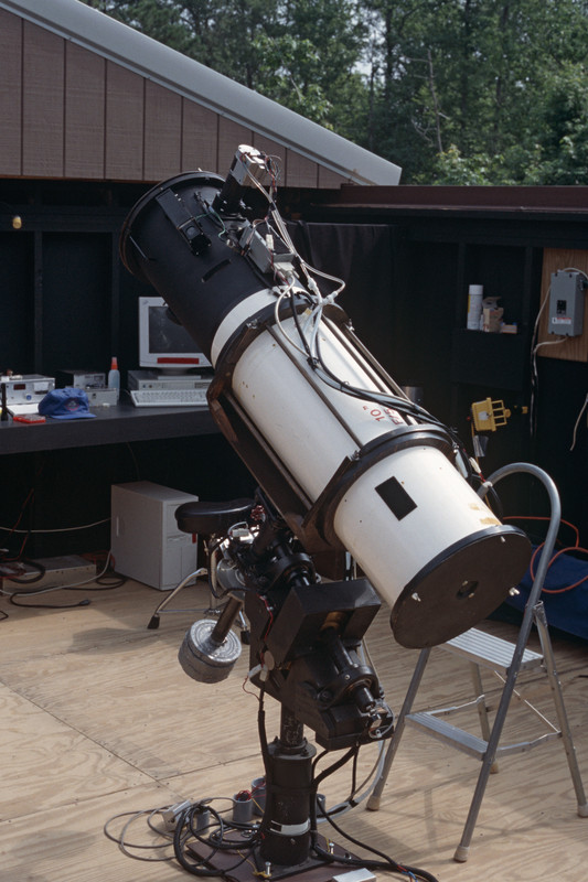

This is a picture of the telescope that I first used in the observatory.  It has been remounted as shown the first picture above and replaced with the 13.5" reflector (same as the one in the picture just bigger)
