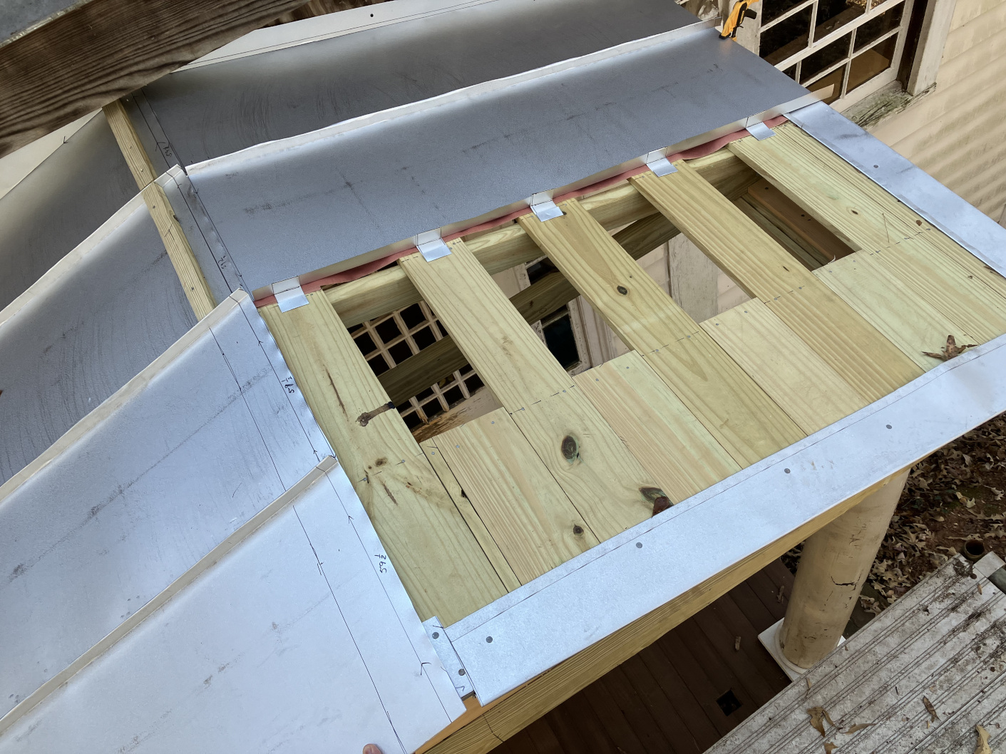

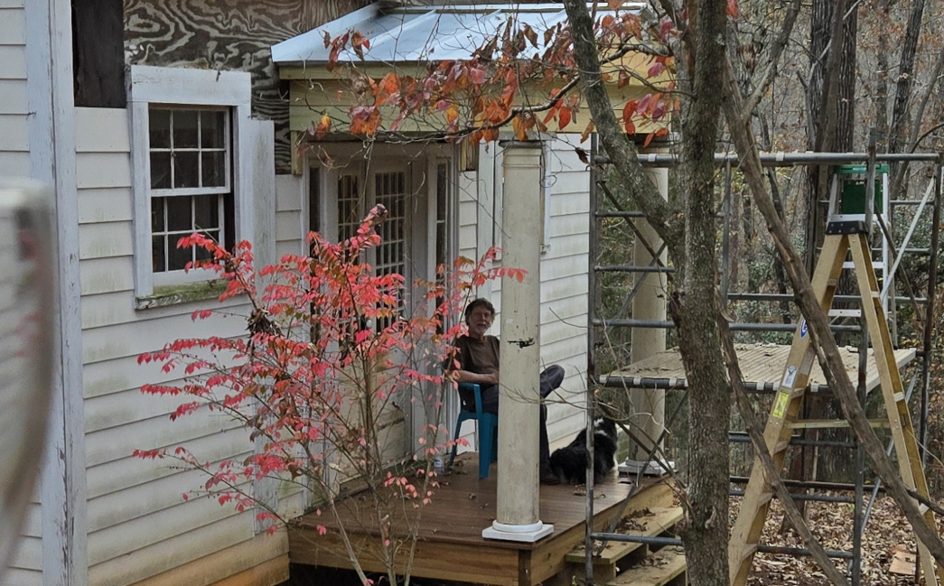

I tore down the steps (that's all there was, the front door has just been
plastered onto a blank front wall) and built a front porch. It has
been great fun, until the roof.
30 years ago I put a standing seam roof on the whole house with 100
year old manual tools. Getting back into the swing of things and finding
the material I needed and working on such a small roof turned out to
be a challenge.
I put one side of the roof on with 26 gauge metal. It was extremely
hard to do, and I wasn't satisfied with it so I tore it off and started
over with 29 gauge metal from a different supplier.
30 years ago I easily got wonderful rolls of material for about
$30 a roll. The 26 gauge I just got was almost $200 a roll!
The 29 was "only" about $55.
I could bend the $55 roll well enough, but found that it has low
"fatigue resistance"... it breaks at the bend easily. Yesterday, I
got the last panel up  Grin ...
I've had the columns for 30 years or so, Salvage from some
old Southern house. I got the capitals with them and had to
make the bases myself.
Anywho... whew!

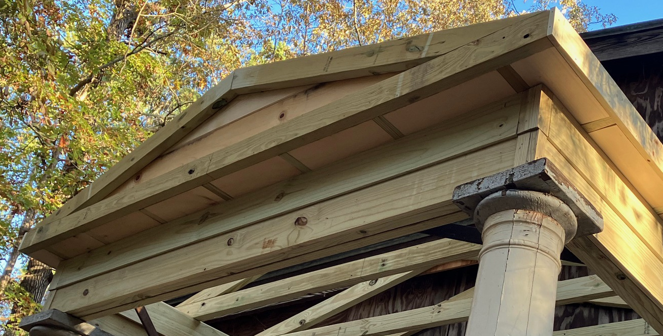

Keith (threevalks) and I were talking about roof construction at
the fall color ride. He used a term, "fly rafter", that I'd never heard.
I know he has looked into this thread, here is a picture of how
I handled my fly rafter...
Posts: 30899
« Reply #14 on: November 25, 2025, 08:14:20 AM »
That looks strong enough to park your bike on Mike.   Grin cooldude
Posts: 6997
« Reply #15 on: November 25, 2025, 10:38:55 AM »
I hadn't heard the term Fly Rafter.
But that's what I did with the last storage building that I built.
I don't care for the metal plates that are designed to hold rafters together.
I've never felt like they were strong enough.
So everywhere that there was a joint in the rafters I used a piece of the 3/4" flooring material to hold the joint together.
I not only screwed the wood to the rafters, I also glued the wood to the rafter with liquid nails.
Additionally, I sandwiched the rafter with a board on each side.
threevalks
Posts: 511
Letart, WV
« Reply #16 on: November 25, 2025, 12:26:30 PM »
    A fly rafter, barge rafter, bargeboard or facia rafter is the last rafter on the gable end that sticks past the end of the building. We were talking about how it is installed. I was taught to simply nail it at each end. The bottom to the 2X6 facia board, the top to the ridge board. Then the roof sheathing is nailed to it and all other rafters, holding it all together
     To install the proper way. (I have only seen two or three times on an older house's)  You nail at top and bottom, then run short 2X6's from fly rafter to next common rafter inside building on 16" centers. They are siting on top of the gable wall, nailed at each end.
      Very strong for sure, but seems like a bit of over kill. The common rafters are siting on the top plate of the wall and are actually what holds the facia board up. Where the fly rafter is only held at each end.
      Mike's pic does not show the fly rafter, but  the rest should hold up through a category 10 hurricane.  GREAT JOB MIKE.
Posts: 16804
« Reply #17 on: November 25, 2025, 04:54:51 PM »
There's a fly rafter out there, I was trying to show how I tied it in to
the common rafters, which is different than how you described...
threevalks
Posts: 511
Letart, WV
« Reply #18 on: November 25, 2025, 05:48:27 PM »
You done it the way I do, nailed top and bottom, then sheathed over. You added extra boards at the end, I covered it solid for shingles.
                               Damn, we're good.
