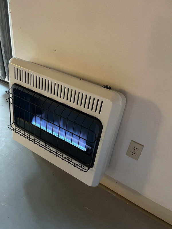

« on: November 23, 2025, 05:58:09 AM »
The great thing about basements are how cool they stay in the summer. Conversely they can be a little too cool in the winter. Even with the hvac vents provided in my basement it could not be considered comfortable in the coldest times of the winter. One room in the basement is 750 sqft with no finished ceiling so I added a 30,000 btu gas heater. I think it is going to work great.

« Reply #1 on: November 23, 2025, 12:00:18 PM »
You made a good decision, I’ve had a 36,000btu in my basement (1,300sqft) for probably 20 years. Mines a free standing natural gas 36” burner. It was huge plus when Superstorm Sandy killed the power for 9 days, it kept the house fairly comfortable and luckily we didn’t have extremely cold weather.
My basement has unfinished walls, basically painted concrete block with 3 vents from the HVAC system but the thermostat is upstairs so the basement can get pretty cool in the winter, but I can get the temp up from 67-68 to 75 in about 15-20 minutes, having 1 or 2 12” oscillating fans helps push the air around.
For safety reasons I keep a CO detector down there since the furnace and water heater are down there as well.
Enjoy the warmth, it’s great.
I've got one of them (free-standing style) in my basement, to help warm it up when necessary (or emergencies when the power is out and I can't get the generator started). 30K BTU is a whale of alot of heat in my basement - it can easily put it to 78 F down there.

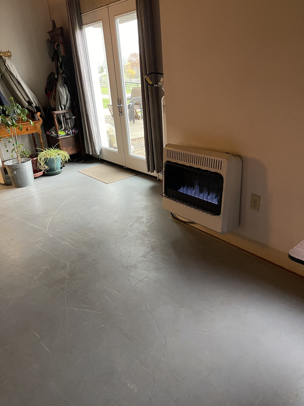

« Reply #7 on: November 24, 2025, 06:36:19 AM »
I’ll be watching for excessive moisture and I have the French doors on one side and a window on the other side of the heater so it should be easy to detect. The door is fiberglass and the window is all vinyl so I’m not concerned with rot. In my previous home with a fireplace insert in the basement, I ran a dehumidifier most of the time.
