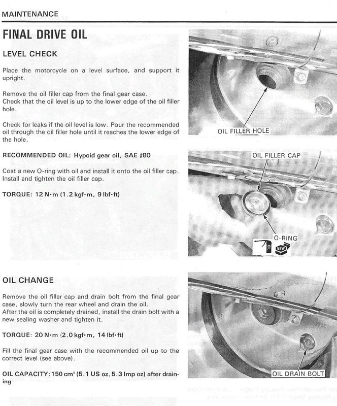

Not sure if this is the original exhaust and if it is or not, is the very end removable section meant to provide better access to the final transmission oil fill plug? Drain is bellow the exhaust but the fill is just behind that end section. Ready to do an oil change and see how the old one looks like.
Thank you

I use a small funnel and 3/8" rubber fuel line thus snaked it around from the top. A large prescription bottle is right @ 5 oz. to the cap rim. Easy peazy. I noticed doing it on the sidestand that after fill the oil level was right at the bottom of the threads which is similar to VT1100C procedure per OEM manual but I always measure regardless.

Additional question: does anybody know the size of the "O" Rings? I like to have some spares just in case. I will lift the bike; I plan on flushing twice using regular oil and spinning the wheel for a few minutes before I put the gear oil. I also have a syringe with tip for tubing so I can get around the exhausts if need it.  I will also use Hylomar Blue thread sealant. Any info on "O" Rings will be appreciated.
Thank you.

You don’t need the thread sealant or O rings. In 3 Valks, I never had a leak.

That o-ring on the fill plug is a size you would likely have to order.  If there is one on the plug that is not damaged, most of us would not replace it.  Here it is:
https://www.amazon.com/Honda-91302-001-020-O-Ring-30-8MM/dp/B00AAH75RE
« Last Edit: November 24, 2025, 07:35:04 PM by Pluggy » Logged

Do not over tighten plugs. They can break with too much force.
