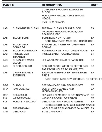

This week we took it to a speed shop and the machinist who is maybe the top or close anyway Ford engine guy around agreed to machine the block. Put together and balance a rotating assembly so we can get to building
The machinist was sure it would be at or a bit over 400Hp. Wow!
This is what he is doing right now. Should take a month or so to get everything. I’ll keep you posted

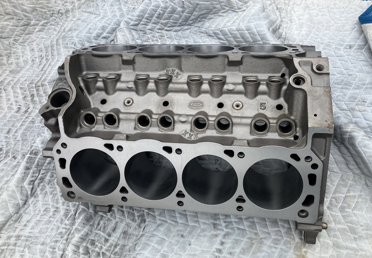

OK, So the block passed magnaflux and was bead blasted so it must look brand new. Next is machining. It’s getting decked, drilled and bored .30 over.
Two or three weeks we should have the block and rolling assembly.
I’ll send pictures when we have the pieces back.

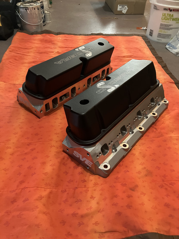

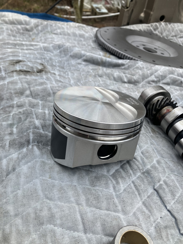

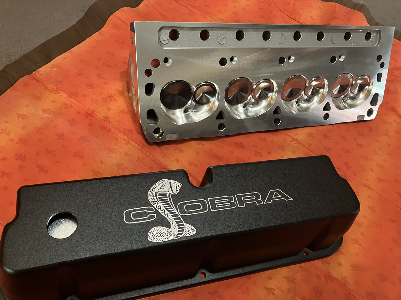

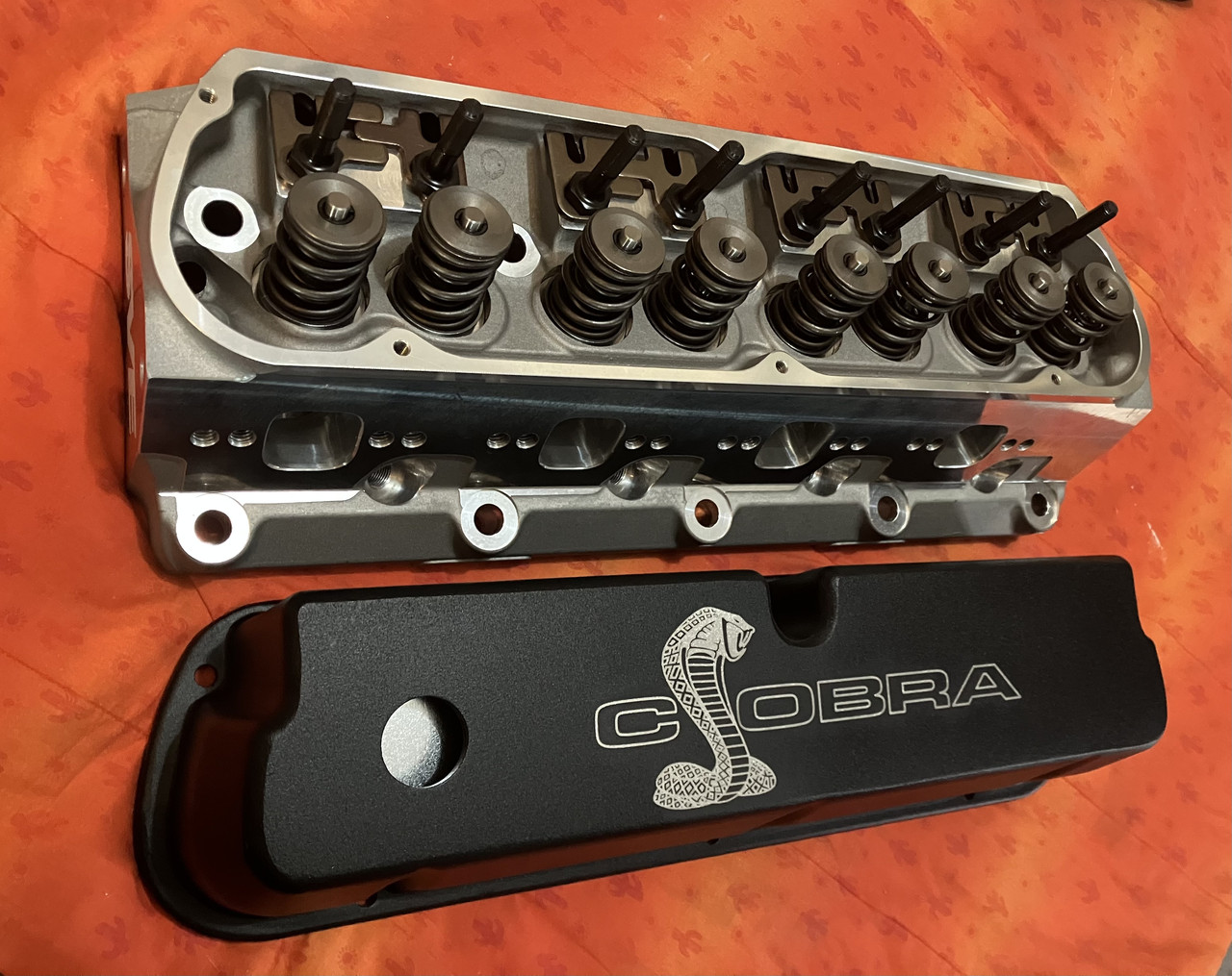

« Reply #12 on: February 17, 2026, 06:01:10 PM »
Ok. We just got back from the machinist with the refurbished block and balanced rotating assembly parts. I already had the heads and Amazon delivered the valve covers today as well. We still need a bunch of small parts but we’ll get there. We’re on our way to 400 Hp
