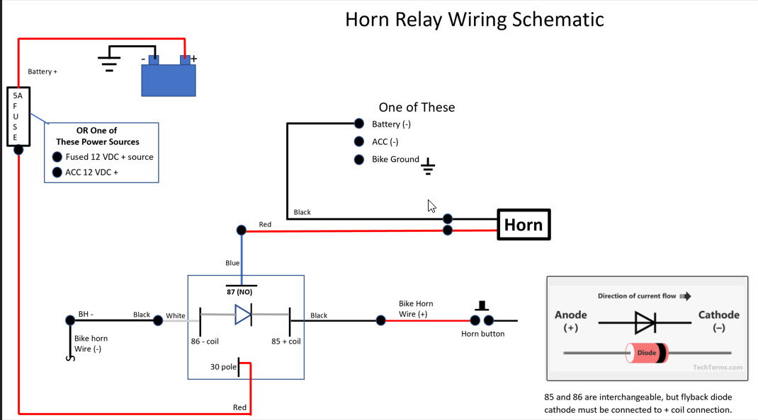

I skimmed read a little about them. I think I read you needed a relay with 12 awg wire. I would use the horn wires to run the relay (at least a 30 amps one).

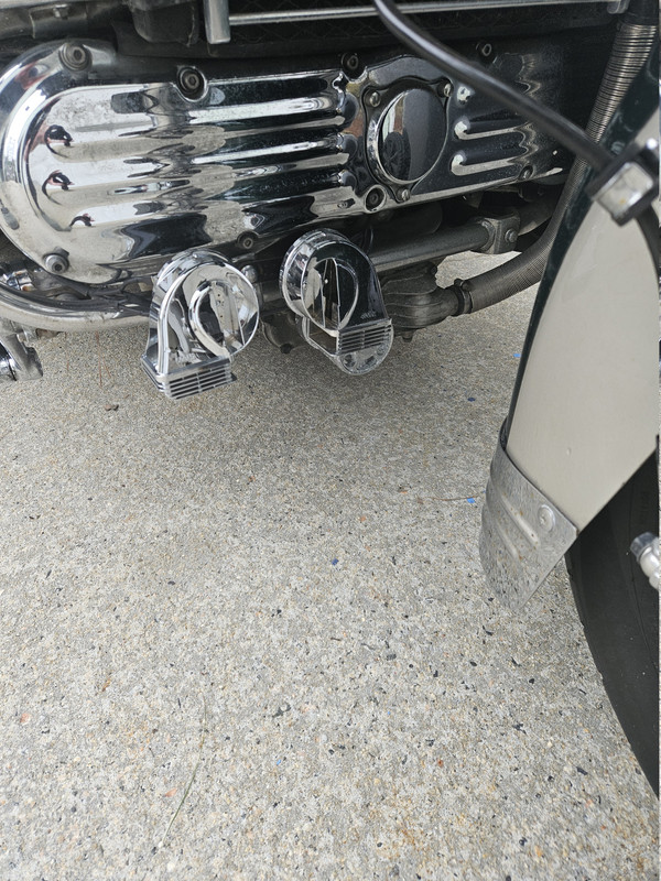

I had an airhorn, but switched to the MotoHorn Dual Track. It is a pair of Hi/Lo horns that is much louder than the airhorn I had.
I made a relay harness to keep maximum current and sound and take the load off of the horn switch. MotoHorn sells a relay harness kit for about $27. I just built my own. Here is a pic of the horns on the bike and the relay schematic.

« Reply #5 on: February 06, 2026, 08:16:33 AM »
Nope, it is a trike with 8 degree rake.
I also have a car horn on my Tourer with no problem. It has a TBR chrome tripple tree which doesn't change the rake, but moves the forks forward a bit.
Haven't checked it with a stock setup, but there re other places to mount horns. Big BF put them under the bike.
