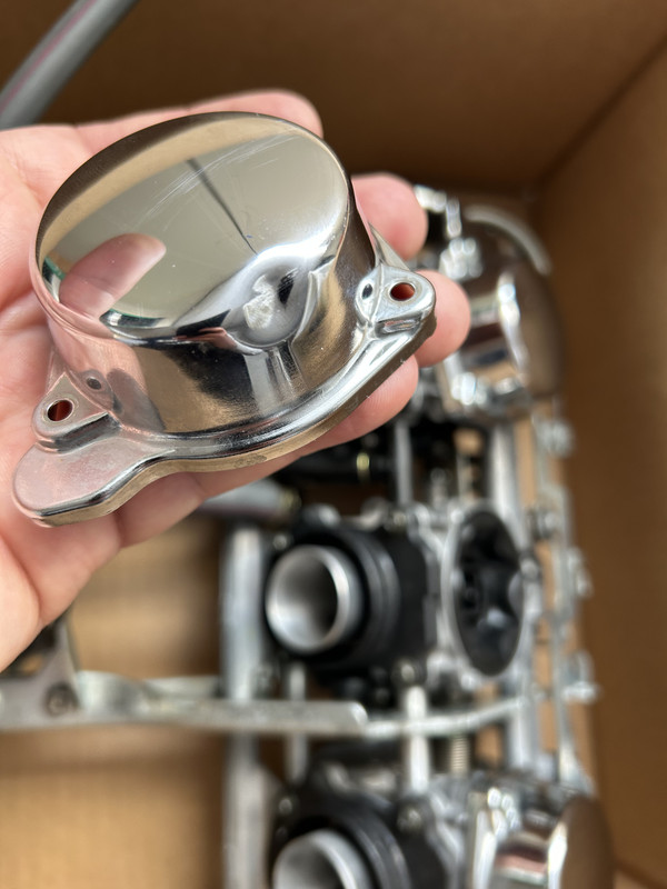

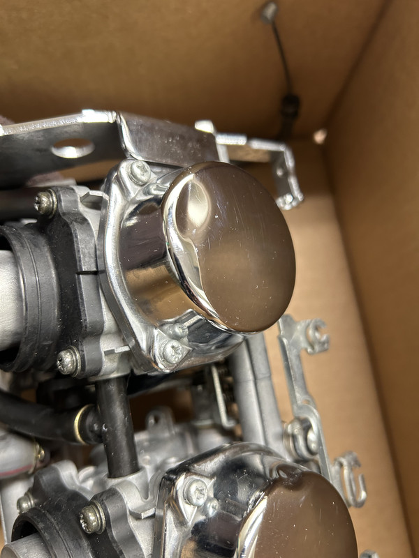

Got my carb rack back today…damaged in shipping. Cry
No major injuries I guess…but the carb caps are dented on 2 of them and a scrape on the 3rd.  Ugh..

Bummer.
I'd say replace them as they are the vacuum chamber for the CV carb system to function properly and besides they look bad obviously. Damn it anyway. Had similar episode buying a small freezer from Home Depot. Took 3 units before they got one that haven't been speared with fork lift. Frustrating for sure. This damage appears to before shipping damage but...

The metal piece is just decorative, there is a plastic piece under that I would be concerned about though.

 Yeah I took them off already and the plastic underneath seems fine.

  They are for looks and protection. YES , replace them . I have many ,many in stock. I am in southern Wisconsin. Could not find your location.  The vacuum seal is below the covers.  I would be more concerned about the impact damage. It takes a lot of force to do that much damage.  Contact your builder and let him know what the shipper did.  You may have internal damage.

You can put everything together while you wait just to make sure everything runs correctly. The dented cap won’t make any performance difference.
This.
A hit like that could have slightly damaged any of the structure of the carb attachment pieces and sync system.
If I was in that situation, I would visually inspect every piece, using a straight edge where I could and if no damage was discovered, install the carbs and do a carb sync.
At the least, I would do a bench sync.
The caps can be installed any time and if there's other damage, I'd want to know now, as opposed to when riding season starts.
Hopefully no other damage will be discovered, but I'd have a hard time sleeping, thinking about the "IF"

FWIW those caps are very easily dented.
I damaged mine by having the rack upside down on a work bench.

Is the shipping box all caved in and broken through in multiple places? It seems as if shipping damage wouldn't be on the edges of the caps but in the middle. That looks like someone beat them up with a piece of pipe.  If the box is damaged enough to cause that, the shipper is responsible,, otherwise the person you sent them to did it. did they send them to you in an empty box with out being protected?
