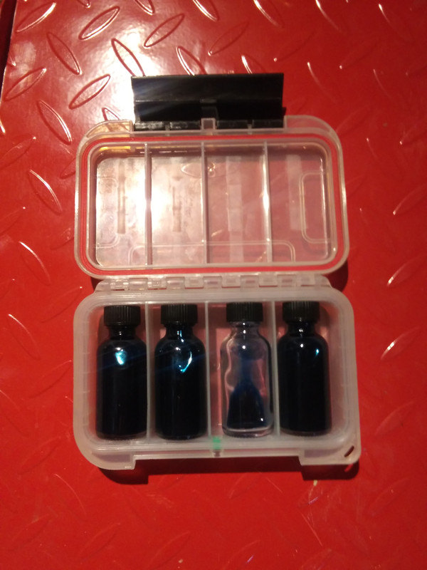

Posts: 6960
« Reply #13 on: April 12, 2026, 06:28:48 AM »
OEM o-rings are Buna-N
""B-12 Chemtool Carburetor Choke Cleaner
Toluene 108-88-3 40-50
Methanol 67-56-1 20-30
Acetone 67-64-1 20-30
Methyl Ethyl Ketone ""
https://www1.mscdirect.com/MSDS/MSDS00009/08099822-20151111.PDF
see that word "Acetone" how many put into their gas? it is also in many fuel additives.
""BUNA-N should not be used in highly polar solvents such as acetone and methyl
ethyl ketone, nor should it be used in chlorinated hydrocarbons, ozone or nitro hydrocarbons.
98Valk, I've been using the 1oz TC-W3 to every fill up since you suggested it, what 5 years ago?
I have yet had to deal with a carb issue yet on 4 different Valks, (knock on wood) and have let them sit overwinter every year.
Are you suggesting not using B-12 with OEM o-rings at all, or just not allowing it to sit in the carbs?

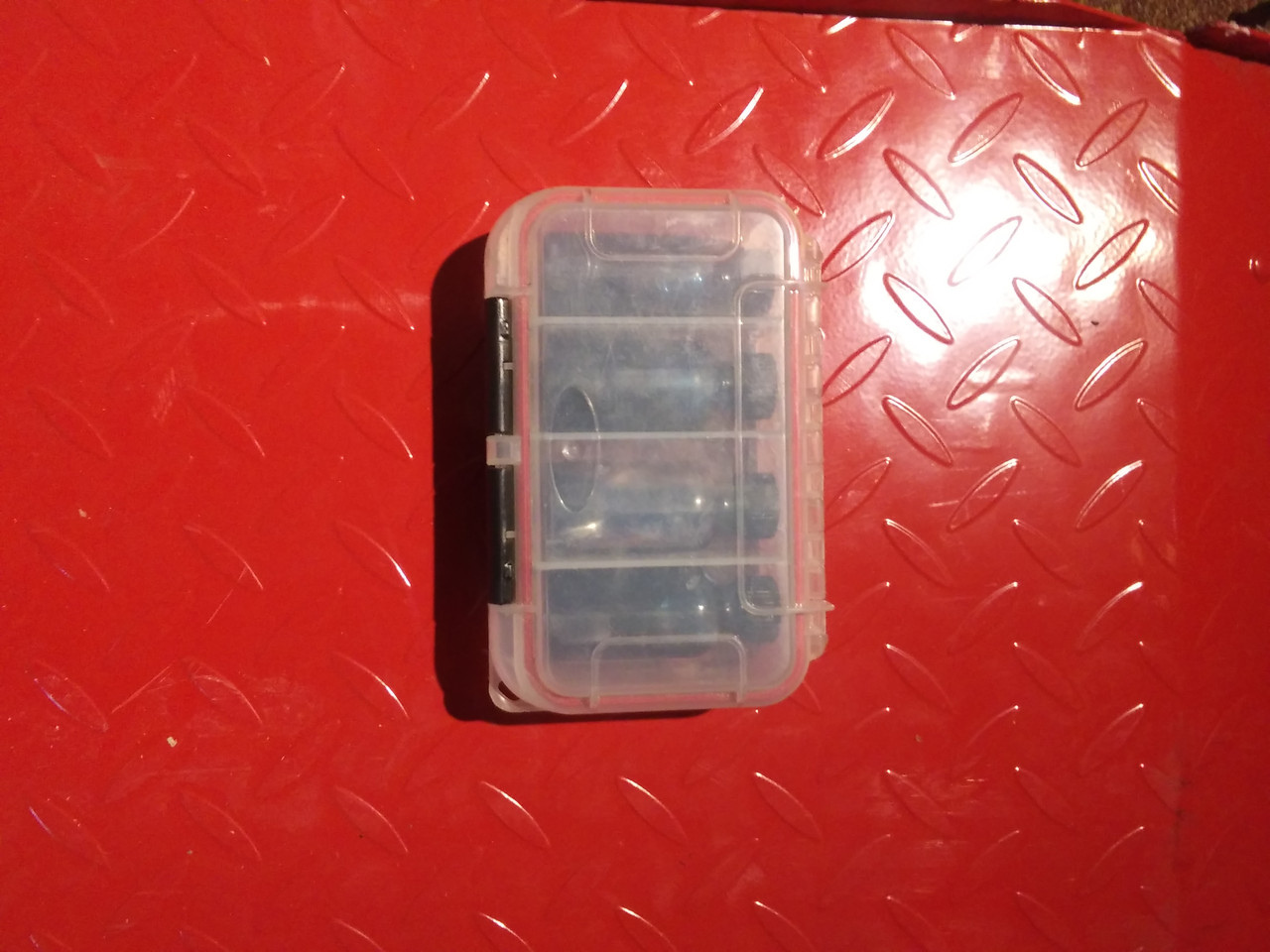

Below is my system for carrying TC-W3 with me so I can add it while filling up.  1oz glass bottles with screw on caps in a fly tackle lockable case.  Works well.
Posts: 13885
« Reply #14 on: April 12, 2026, 01:38:42 PM »
B12 will attack the oem buna-n aka nitrile o-rings.   I wouldn't use it. no doubt in my mind B12 is one of the reasons people need have the carbs rebuilt.
 no reason to use it, its old tech and we have new tech TC-W3.
Glad it is working out for you. I also use it every tank.
here is the spec
https://www.nmma.org/certification/oil/tc-w3
