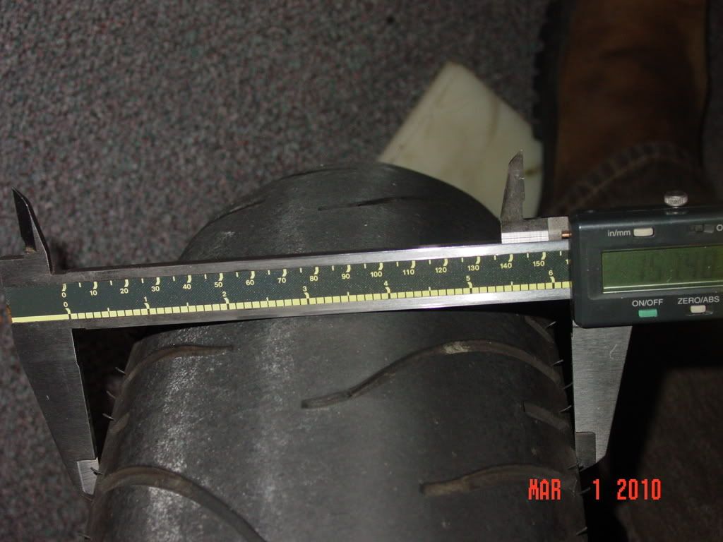

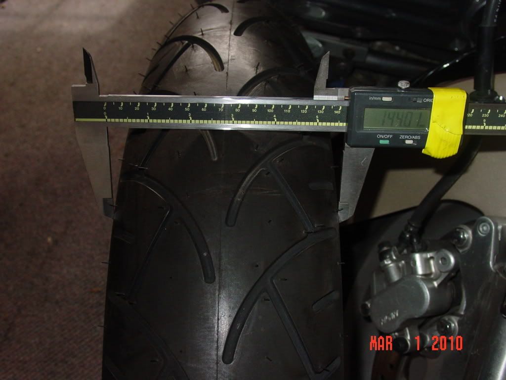

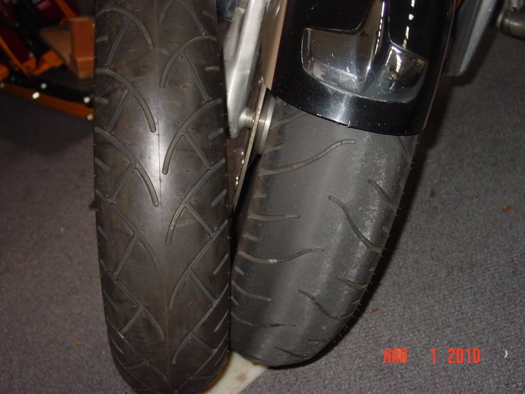

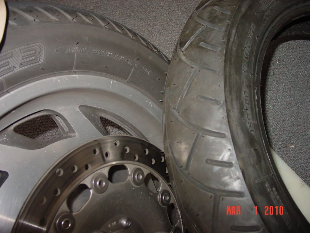

Hey, someone please measure your inflated M880 width.  My installed 150-80-17 Dunlop is 157.5 mm wide.  The M880 un-inflated is 144.0 mm wide. In a thread some weeks ago, we were looking at possible rear tires that would be usable as fronts and the 160-70-17 came up.  It was unknown if this tire would fit within the front fender, based on the width of my installed Dunlop, if the 160-70-17 is really 160 mm wide it should be a no brainer..(2.5 little mm).  I am amazed at the apparent different sizes of two tires with the same specs......]

Thats what I am getting at....the Dunlop 150-80 appears to be virtually as wide as a 160-70, presuming the 160 is really right at 160 mm wide and not over wide like the 150 Dunlop.  Or is it under wide like the M880 appears to be.  The bead distance on the 880 is right at 3.5 inches now unmounted so the side wall flare would have to be considerable to even stretch it to 150 mm.   Come on......some body measure their 880....pretty please.

my front metzeler measures 142,5 mm wide on the bike.
note : it's already quite worn :
depth of grooves at centre : 2mm, groove depth at side ; 2,5mm
it s not just the width, also the outside diameter is different :
last year on our way to inzane with 7 valks, we compared the tripmeters :
those who had the same front tire brand, were within 2 km difference at every tankstop.
between metzeler & dunlop the difference was usually 10km, on a 200km distance. that is 5% difference.
Anthony

Thanks Anthony.....so the width doesn't change much inflated.  I wonder if the wider flatter width of the E3 is why Smokin Joe can't keep the front end under the bike  with E3s.......the further you lean the bike the narrower the contact patch as you approach the flat sharp edge of the tire.  With a more rounder tire the patch doesn't narrow so much.....?
