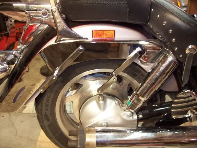

Finally got my hitchdoc and Tsukayu bags mounted.  Whenever I do some work on the bike I like to take a few pics.
Receiver type hitch doc
Trying to come up with some dimensions as they do NOT come predrilled
I went with the brackets mounted at 45 degrees .... PLENTY of clearance for brake caliper, drive unit, etc.
and had a 1/4" aluminum plate machined up for added support and to use as a drill guide.
made up this wood fixture to help transfer my dimensions to the bags. Prolly overkill but damn accurate.
The finished product ....

Thanks for the compliments.  Just to clarify  -  that 1/4" aluminum plate (qty 2) is mounted between the saddlebag and the Tsukayu mounting brackets. I also inserted a 1/16" piece of neoprene (same shape as the aluminum plate) between the saddlebag and the aluminum plate.  The aluminum plate also acted as a drill guide to drill the holes into the saddlebags.

Thank you sir .... working as a Tool Designer and having access to a class 1A Toolroom does come as an advantage to these projects. I'd be willing to bet that the dimensions between the two saddlebags are within .06" from each other.  Makes me sleep better at nite  Wink
Also, if anyone is interested in what I came up with for dimensions to drill the holes in the bags just give a holler ....
