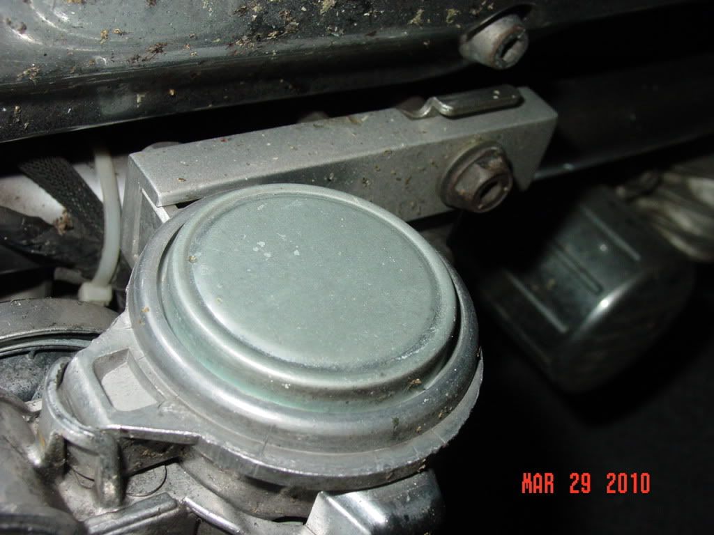

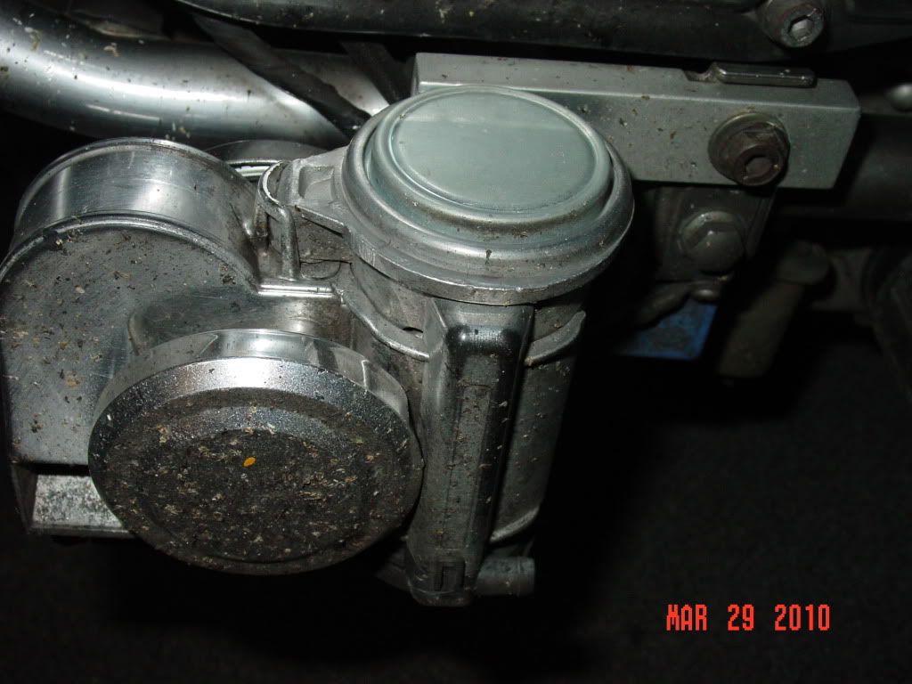

« Reply #12 on: March 29, 2010, 09:20:40 PM »
I whipped up a mount from a piece of aluminum, used the existing mounting hole but moved the horn over about 3 inches to make sure the front fended had plenty of clearance.  The barely visible blue object is the relay used for the hot lead to the battery.  The normal horn lead is used to energize the relay to honk the horn.  Gives a good low resistance path from the battery to the horn for maximum toot power.  Just a hint, the auto salvage yards are a great source of high quality, high amp relays and at almost no cost. Also, amp rating and pin configuration is printed right on most of the relays.
Sorry about the gungy pics....got caught in the rain and I live in a agriculture area.....bugs!
