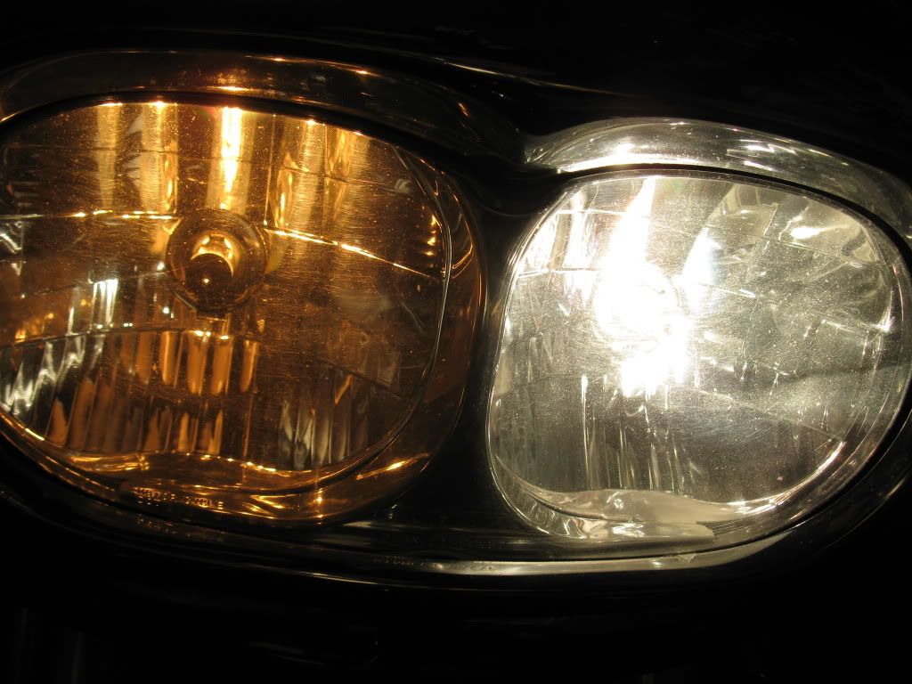

Hey Storm Last year LoneRider put some SilverStars in my 99 I/S. I had read here that bulbs lose their strength with time. Let me say that,what a difference.I thought folks coming the other way were going to flash their highs at me for running my highs.This winter ,I put another set in my 01 I/S but took a pic of the two bulbs in at the same time.As you can tell,the SilverStar is in the right side. I heard they don't have the same life as stock but who  cares if everyone can see your bike while you are on it. Well worth the money in my eyes.
Happy Trails Adrian(Chrome) V
