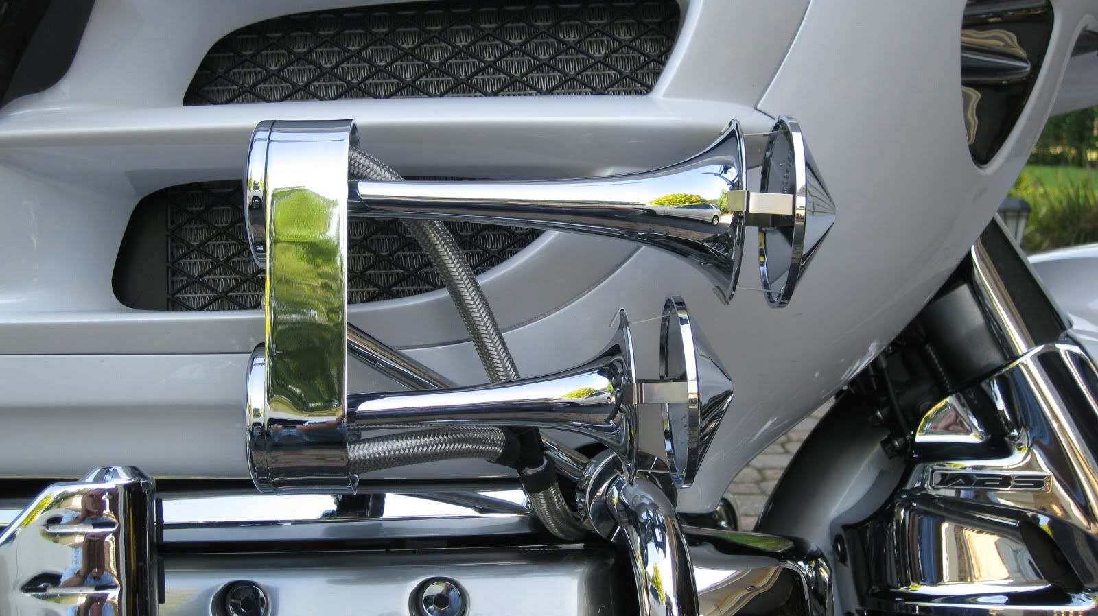

Forgive my Goldwing PIC here, but if your horns are going to be exposed, you may want a little bling on the air lines.  I went to the plumbing department and bought the longest stainless covered toilet hook-up, cut off the fittings, and replaced the Rivco air lines with it.
